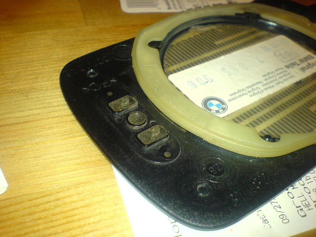

        back from the dead, how did you wire this heated mirror setup if you don't mind my asking. behind the glass there appear to be two tabs to connect wires to, so i am pretty sure the glass will accept the heating element, but as for the wiring, i'm not too sure on that, just a live 12v, and a ground? run through the rear defrost?

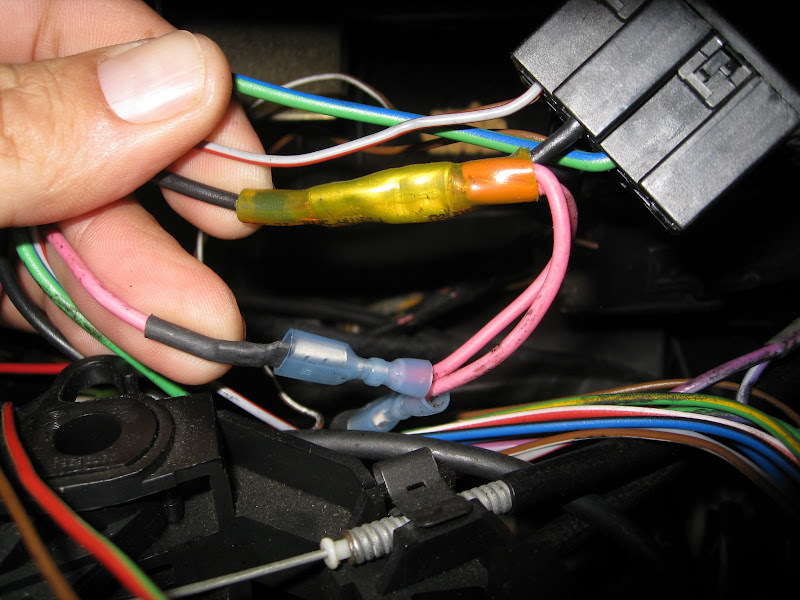

          If there are two tabs actually on the glass, then that is the heating element. I wired mine with one tab going to ground and the other from a lead off of the rear window defroster. Like I said last year (!), I think the factory setup is to have them on all the time, but I ran a separate wire all the way through the door connector, across the dash, and to the lead coming from the defroster switch. On my car, the wire I spliced in to was the 2.5mm black wire.
          If you don't mind having them on all the time, I would imagine you could find a wire in the door that is only hot in the 'RUN' position and splice it into that. I chose to go the extra mile and connect it to the rear defroster switch because I didn't see any point in having them on all the time.
          Anyway, it is just a heating element, so it only requires +12V and ground, and it doesn't really matter which tab goes to which.

              No, there should be no significant difference - the fuse for the rear defroster is 30A. If your rear defroster and these two little heating elements blow that, you have other issues! I would recommend against soldering, though. Just get a quality tap from 3M or, what I did was to actually cut the line and use a crimp connector. The pink wires go to the mirrors.

                  EDIT: I should add that the reason I used the cut/crimp method rather than replacing the connector in the connector body was that I didn't have any of those connectors on hand and didn't feel like waiting for them to arrive in the mail. I do actually have some of those connectors on hand now and will probably be changing that wiring at some point in the near future to do just what you have suggested.
