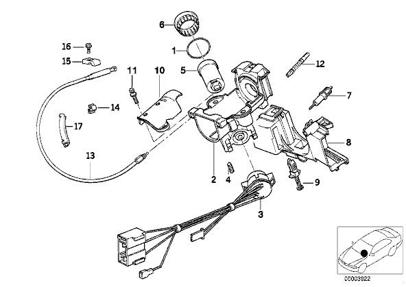

                        Do you have a few hours? Then you can unlock the steering wheel. You'll have to remove the steering lock / lock cylinder from the steering column.
                        If you just want to start it, undo the lower steering cover, remove the two hidden grub screws (part #4) holding the ignition switch (#3) to the lock cylinder and pull the switch off the cylinder. You can then use a screwdriver to start the car.
                        Would-be thieves take note, you can't move the car because the steering will still be locked.
                        In order to remove the steering lock, you must remove the airbag (2 Torx screws), the upper and lower cover, and the steering wheel (mark original position). Remove the control stalk console (#8). Then remove the two tamper-proof screws (number 11 in the diagram) using a chisel, or by slotting with a Dremel and screwing it out with a stubby flathead. This is a BITCH. MAJOR bitch.
                        Remove the steering lock from the car. Reinstall the control stalk console and the steering wheel (make sure the airbag pin on the steering wheel aligns with the airbag ring). You should now be able to start and drive the car.
                        I had to replace my steering lock and key cylinder when it failed on my 328. It is virtually identical on the 325.
                        I'm sure there's a way to pound a screwdriver into the key cylinder and turn the cylinder with a pipe wrench or something, but I'm not certain. I only fix cars, not steal them! :mrgreen:
