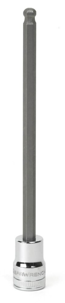

                          A long hex socket huh?
                          As in this:

                            Nah, you don't want ball end. I just use a 24" 1/2" drive extension, a 1/2" ratchet, a 1/2" to 3/8" adapter, and a regular 3/8" drive 8mm Allen socket.

                              Originally posted by Ben Carufel
                              Yes, no ball end tho.
