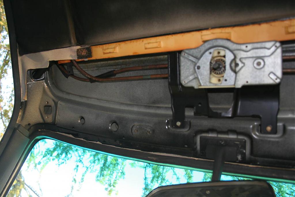

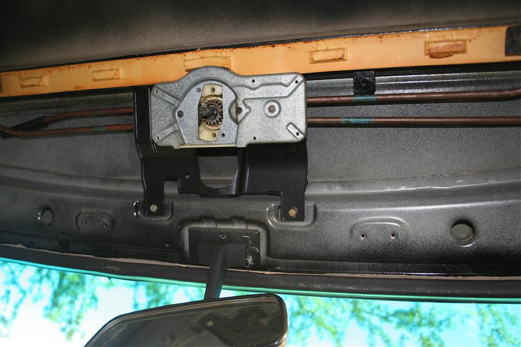

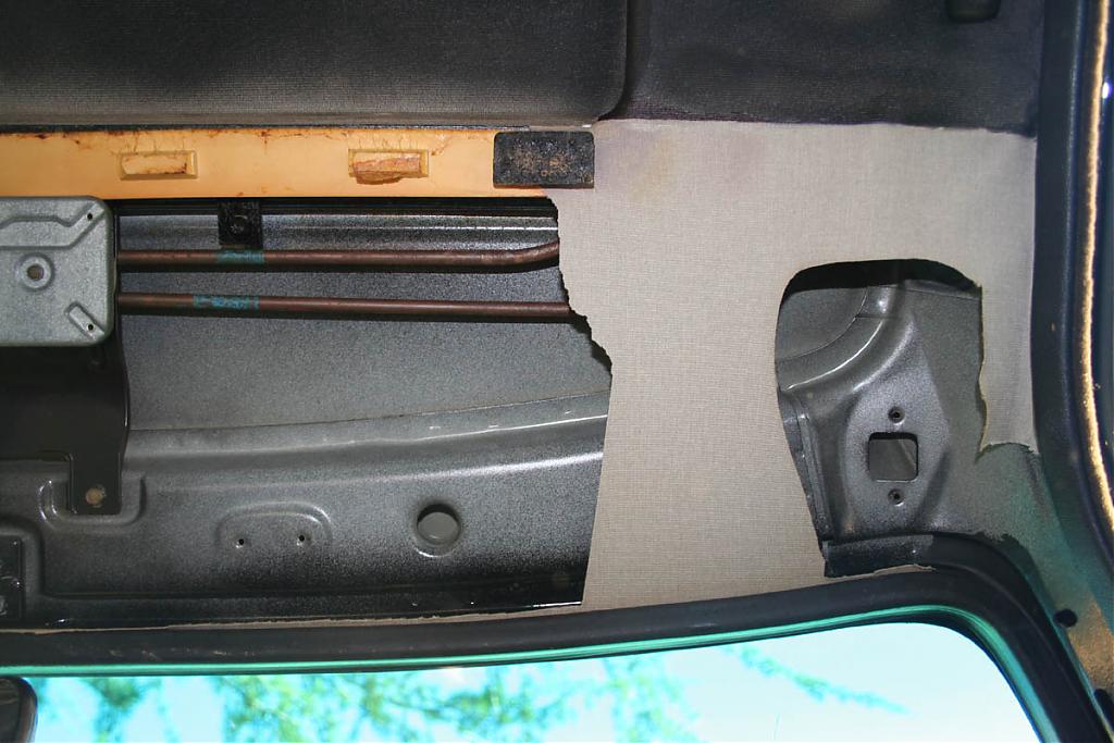

                          I'll snap a few pictures for reference today. The drains go through the a-pillar and left to right/ right to left infront of the sunroof area , behind the sunroof mechanism.
                          A couple of the drain pipes (some are look to be copper pipes) were really close to the sheetmetal so I put some padding there, but it's something else that's making the noise.
                          I can't figure it out. I need to ask someone to drive my car while I sit in the passenger seat to pin-point it. It's not the dash or glove box, and I removed the a-pillar cover so that's not it either.

                            Here is what they look like on my car. There are black rubber tubes going down inside the a-pillars, picture came out too dark.

                              Those copper pipes are the sunroof cable tubes. The drain tubes are the black hoses that come from the holes in the 4 corners of your sunroof (looking from the outside/top with the sunroof open. They are usually too stiff to bounce around and make noise, but who knows...
