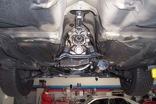

                                Thought I'd also take a couple of pics up on the rack. Here's one toward the output flange of the trans. The new bushings and cleaned up support are looking fresh.

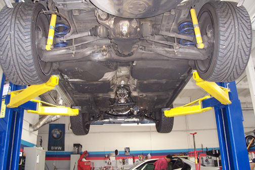

                                Here's the stock rear end prior to coming out. As I said earlier, we're using the H&Rs and Bilsteins again because they're only about a year old.

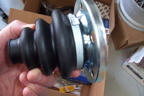

                                The E30 M3 halfshafts have decent CV boots, but we may as well replace them as the halfshafts are cleaned up and repacked.
