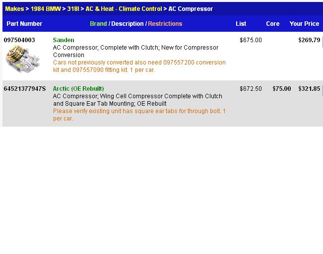

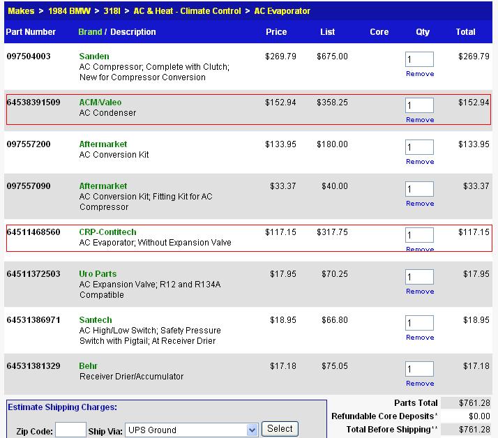

                    I am going to call them (autohaus az) today or tomorrow to confirm any possible install/issues and start moving stuff (lines etc) from my 325i to 318i to get it going..
                    • Jean
                      • 18228
                      So, it's cheaper to just go with Arctic unit, but what are they like?
                      The Sanden unit needs more parts to work / mount.
