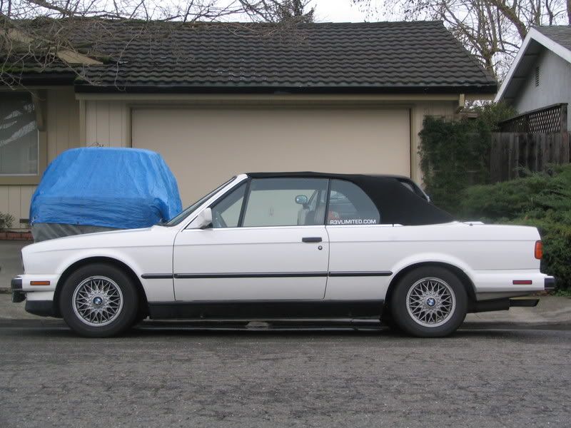

H&R makes a cabby specific "sport" spring kit. I had it on my car and liked them before I put H&R race springs on (not for cabbys, but even without any spring pads the rocker was dead level with the ground). To make it look OK with the race's I put the rear pads back in, but kept the fronts out (1/2" more pad in the rear than front).Comment
