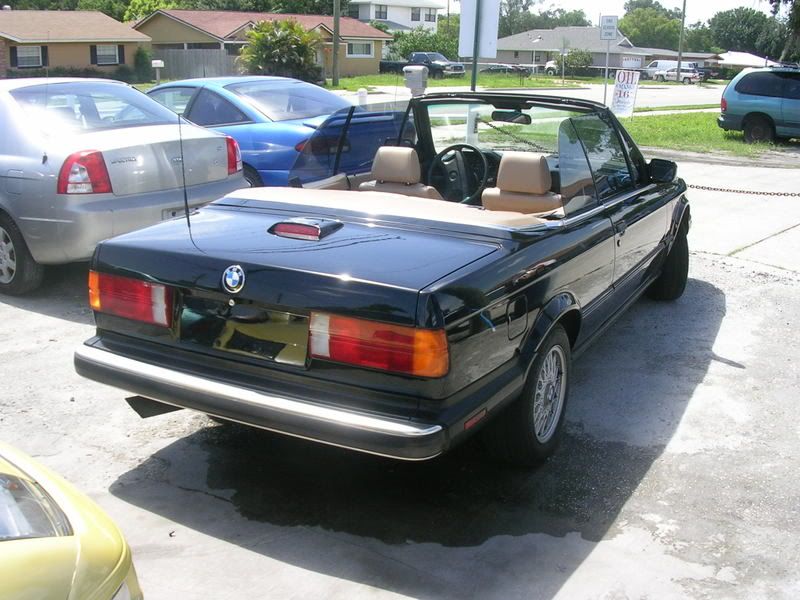

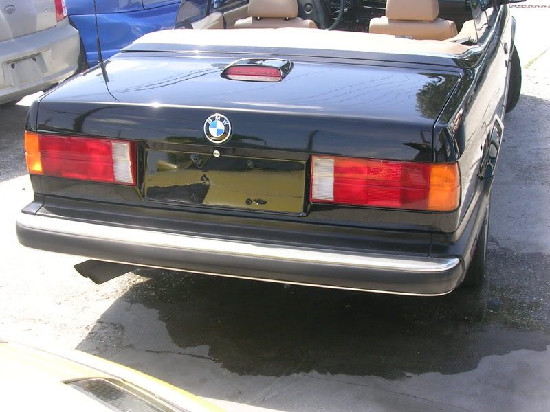

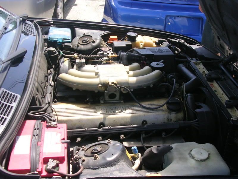

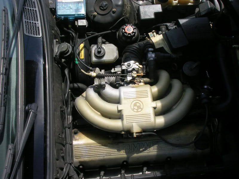

    Let me know your thoughts on this. Do you see any red flags? Do you notice anything odd with the license plate area? like a bend in the metal? Look at the engine as well, anything odd? I don't really know what I'm looking at. Thanks! this is the one i previously mentioned with the odometer not working, last reported reading was in 05 at 119k.

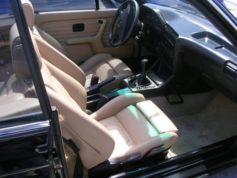

    Its an 91 325ic, It does look repainted but who knows. What im wondering is why it was repainted if it was. As for the interior it is beautiful, and for the engine it could use a front cam seal if not already replaced!

      On the bend you are talking about, it looks like someone possibly had a heavy metal being tossed around in the trunk, because it looks like a dent caused from the inside of the car.

                The car looks quite nice, the interior seems to be in great shape. From the pictures, it looks like this car hasn't suffered from a leaky top.

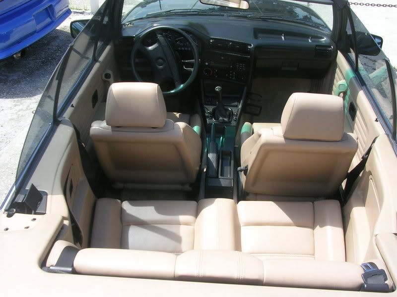

                    Seats have been recovered.
                    Looks like it's missing the plastic cover/endpiece on the top boot lid.
                    Both of the square plastic flaps that cover the top frame holes are "sprung". They're supposed to lie flat when the top is down.
                    The left rear interior quarter panel is coming apart. The ring is missing for the top latch also.
                    What's stuck on the top left side of the dash? Is that an XM antenna?
                    Homoghey cupholder may be screwed into the console side. If it's taped, you're OK, but if it's screwed, you'll have holes when you remove it.
