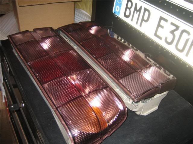

    I did some searching and found this photo, which makes it look as if it's just the bulbs that are coloured, Is that true?
    Because then I found several other photo's which led me to believe otherwise..
    Including this one where you can see orange on the far right with no bulb in place..
    Now i am beginning to suspect the lenses are coloured, but if thats the case, then why does the colour only appear where the reflective "buckets" are for the globes. Where the lens is backed by the plastic, you can see it's silver, or a dark grey/brown colour depending on how think that part is...
    If anyone here knows or has a set and could check, could you please post it up. Either MHW or STARTEC early lights... I need to know what colour the actual plastic lens is (if it's one piece, or multiple coloures heat welded together like the OE BMW lens) And how they produce coloured light.

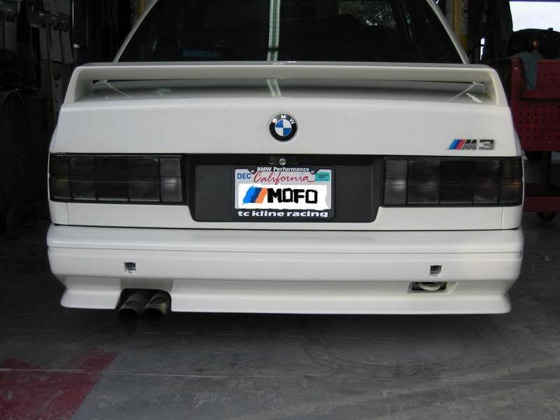

      could it be 2 layers? Almost looks like the amber is under the smoked part in the one pic. I think they look good on a dark color, but on say my white car they would look like crap
        I disagree
        And yeh, I did think maybe it was two layers... Maybe there is someone with a broken set who would know?

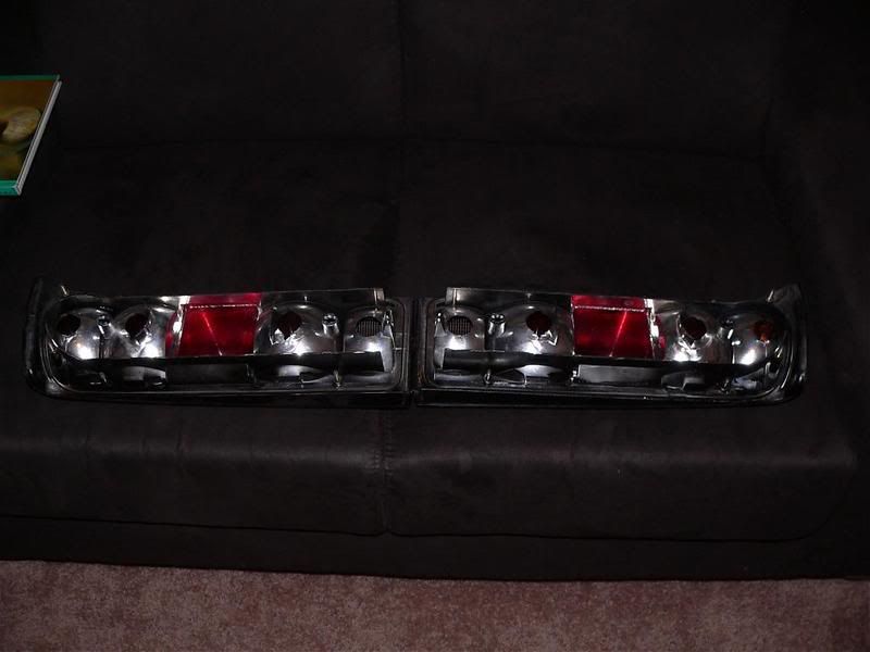

                cups
                It's been a while since I looked at them, but I'm pretty sure they have little "colored cups". When the bulb is installed, the cup surrounds the bulb. The outer lens is clear, so you see the color.

                    I'm not sure about that. I know for a fact that these are Startecs:
                    You can see the orange through the hole on the RHS
                    I'm quite sure both MHW and STARTEC are the same, the MHW's just use a darker colourless lens.

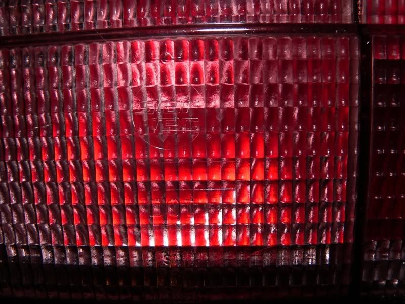

                    Here is a close up of the same light where you can see the logo:
                    Can anyone who actually owns either type, CONFIRM the use of coloured bulbs or otherwise?..

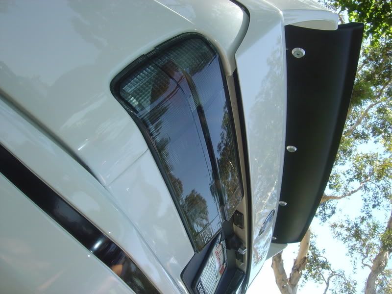

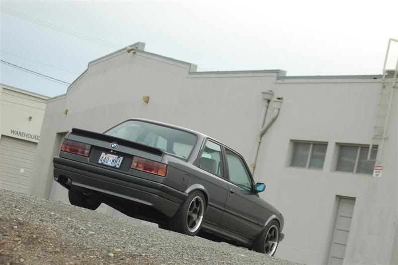

                            Startec does NOT use colored bulbs, the first pic in this thread are my Startecs and there are no bulbs in them.

                              Perfect, so you actually have a set!
                              If there are no bulbs in that, can you tell me what makes them coloured? is it a double lens? Or a multi piece lens like the OE BMW lights? Or maybe the reflective buckets are coloured?
                              Thankyou!
                              *edit
                              Hang on, you're saying there are NO bulbs in this photo??
                              Wow that's a weird optical illusion..
