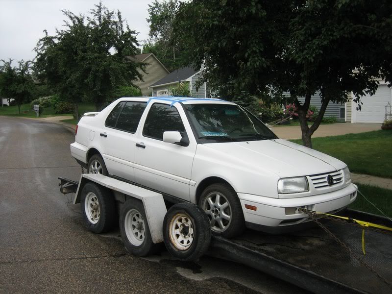

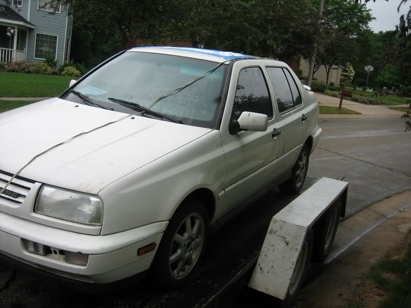

    This is the car when I first got it:

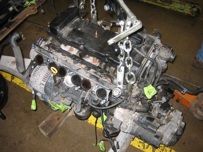

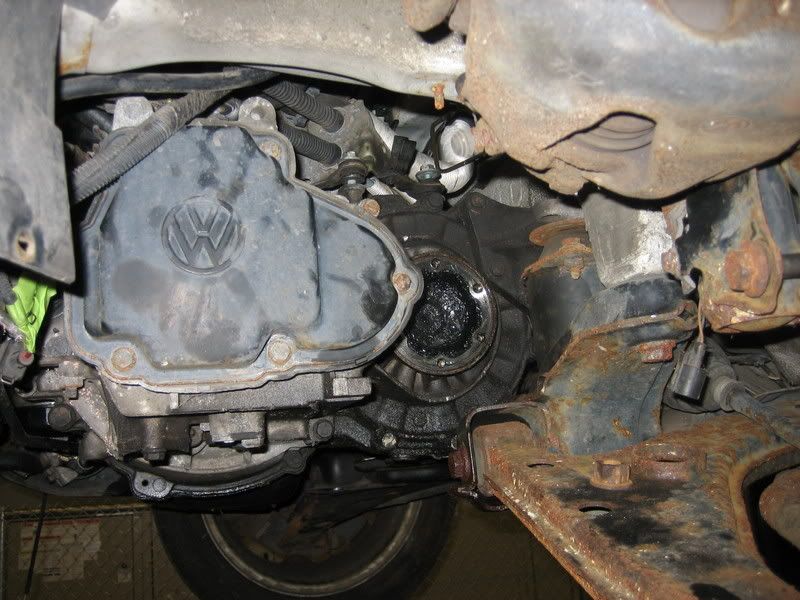

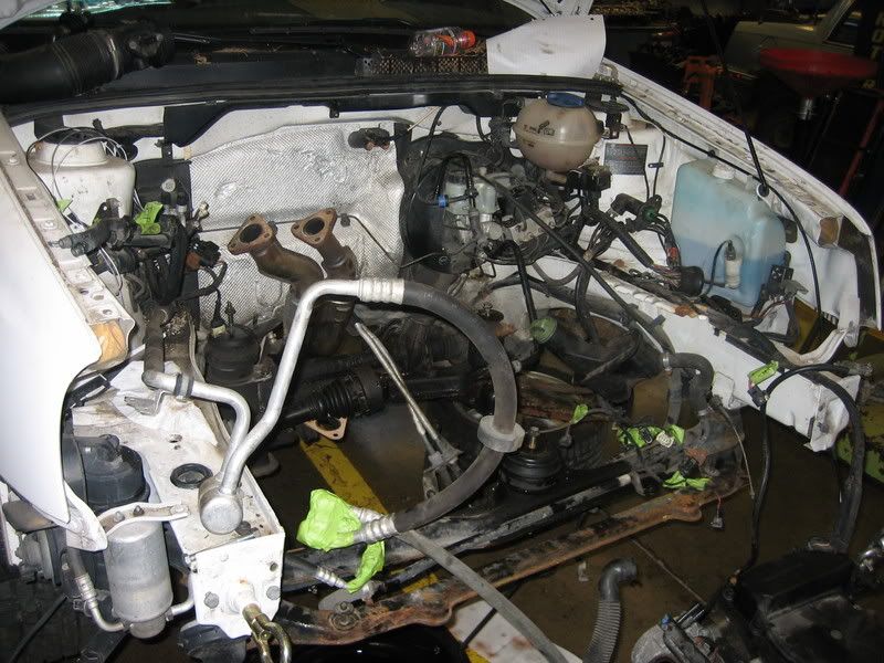

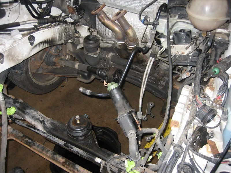

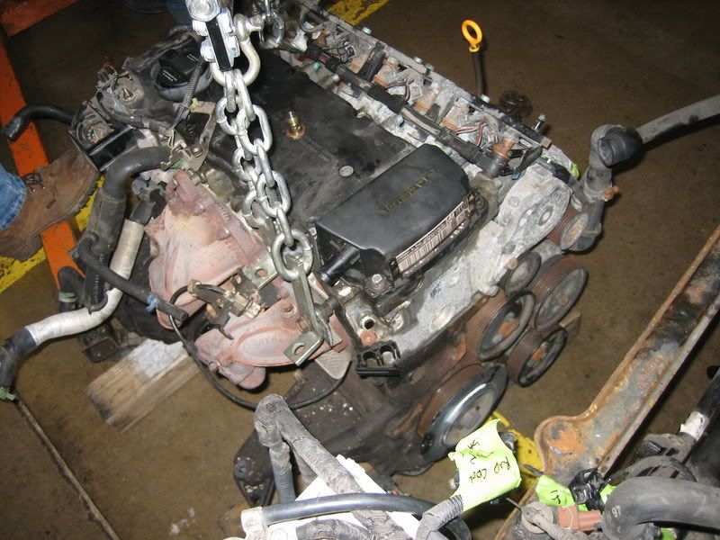

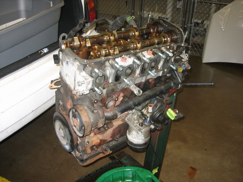

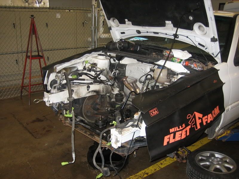

    Almost read to pull, just need to get the exhaust off:
    Axles out

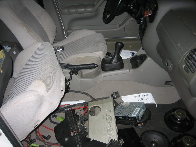

    My shambles of an interior this far:
    I think the ignition switch is dead. So this is how I have been testing the engine lol
    Compression is pretty pitiful, must have some pretty good damage or someone really ran this engine into the ground

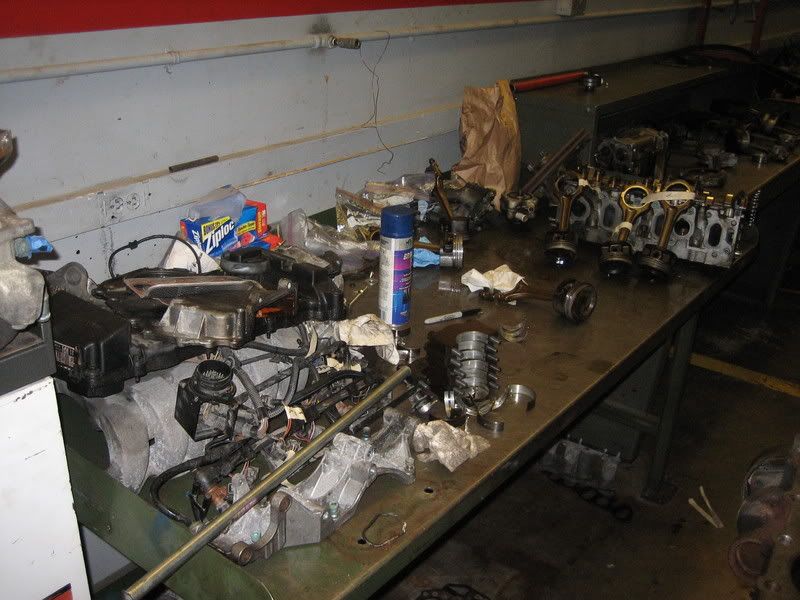

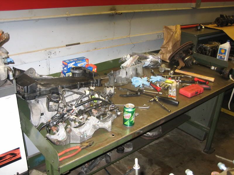

    My work area filling up with parts

    Better late then never, bolted on some fender covers.

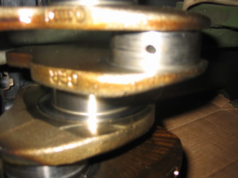

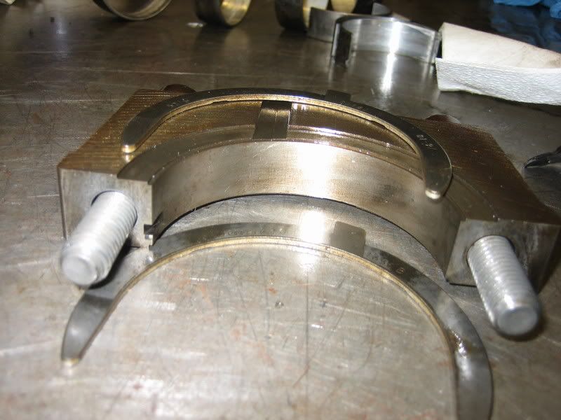

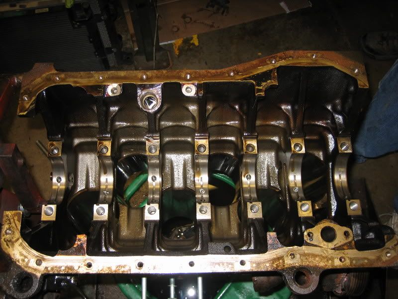

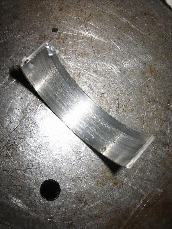

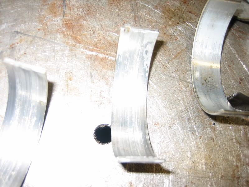

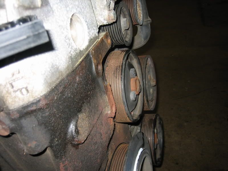

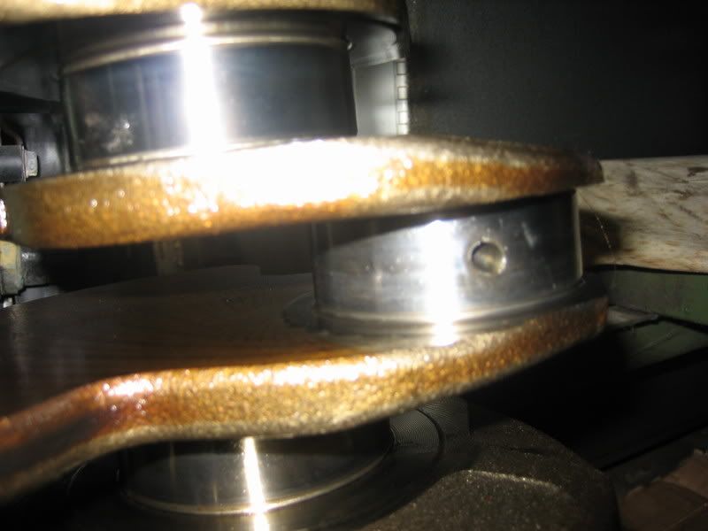

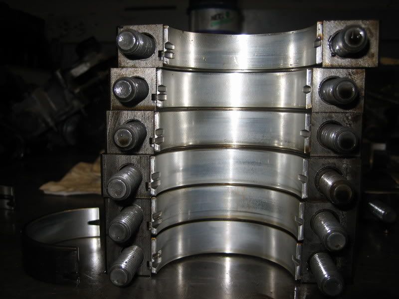

    The connecting rods were BAD. Every bearing was shot to ****. Engine must have lost oil pressure because they were all wiped out. Main bearings were "ok" a lot better than the connecting rods, but 2 were scored.

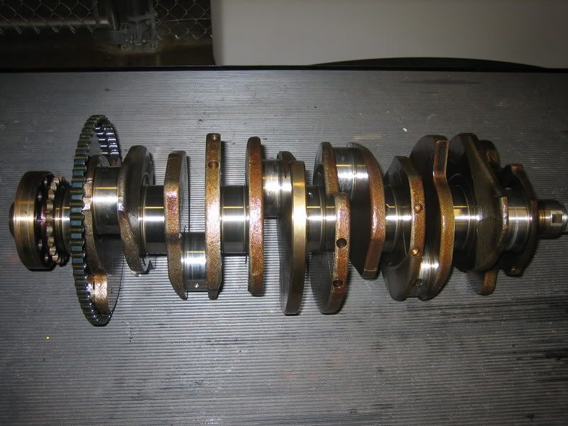

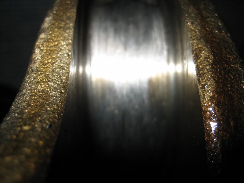

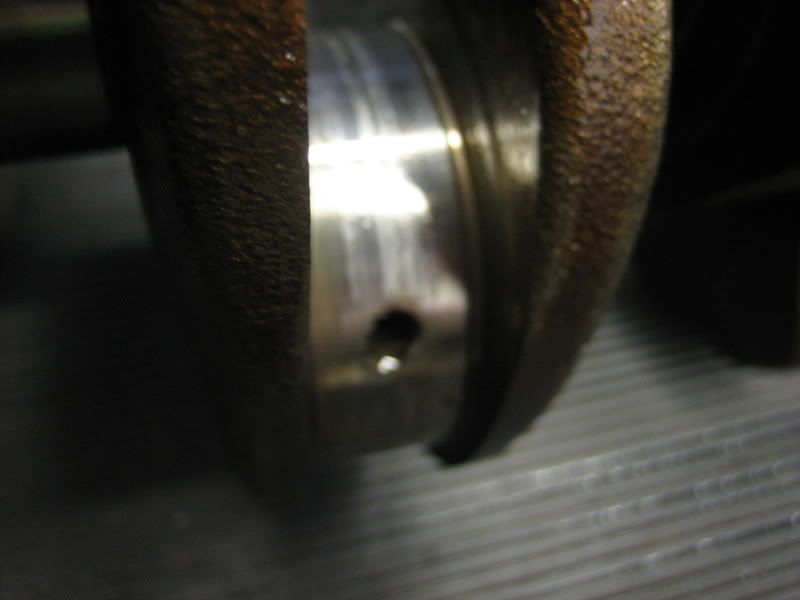

    I'm hoping the crank can be salvaged, cyl 4 was pretty brutal though. The bearings spun out, stuck together, and just ate the crank away. Its blue and brown, scorched pretty bad. That connecting rod is bad too, again I'm hoping I can just have them re-machined and get some over sized bearings.
    Getting a new crank wouldn't be too big of a deal, but I don't want to buy new rods since the cheapest ones I could find were around $800. I guess worst case I could get some "good" used stock ones and have them re-worked. Since I'm not going FI or anything I don't see the point in forged rods.
    I thought my pics were better than this, but looking at them now they are pretty ****ty.

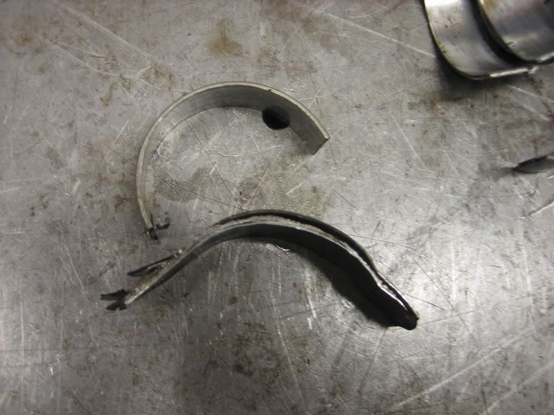

    This is the scorched one I think, ****ty as pics though. I will have to take some better ones tomorrow and learn how to use a camera lol

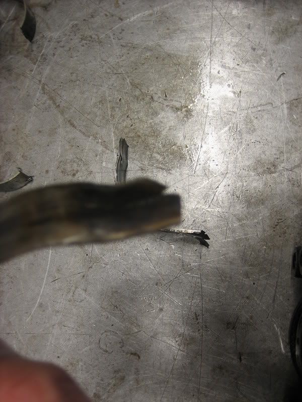

    This was cyl 4s bearing ** Ninja Edit: The top one is a non-broken bearing for comparison **
    I think its both halves, but its hard to tell. Looking at the "good" ones you can see where its 2 pieces of metal pressed together. Stacking the 2 in the pic like I took them out, (I had to pry them off the crank with a screw driver) its 3 layers. I think one is the top, and ones the bottom, but one of them got worn down a **** ton.
    Rod is pretty bad
    Crank STILL didn't turn out good lol, I have it zip tied to the leg of my table and I was too lazy to cut it off

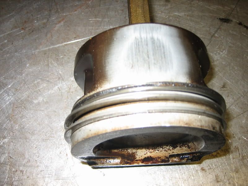

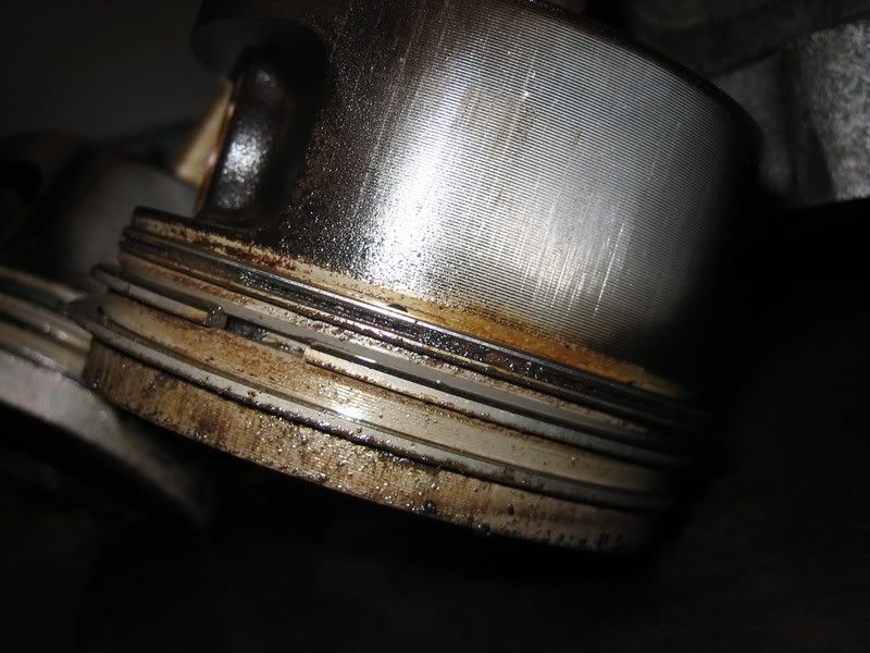

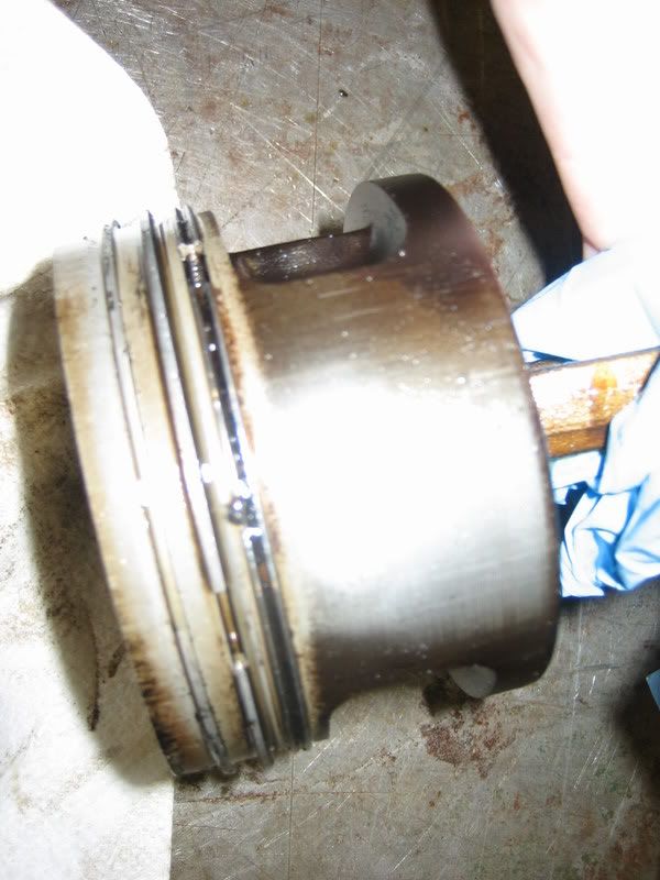

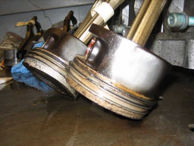

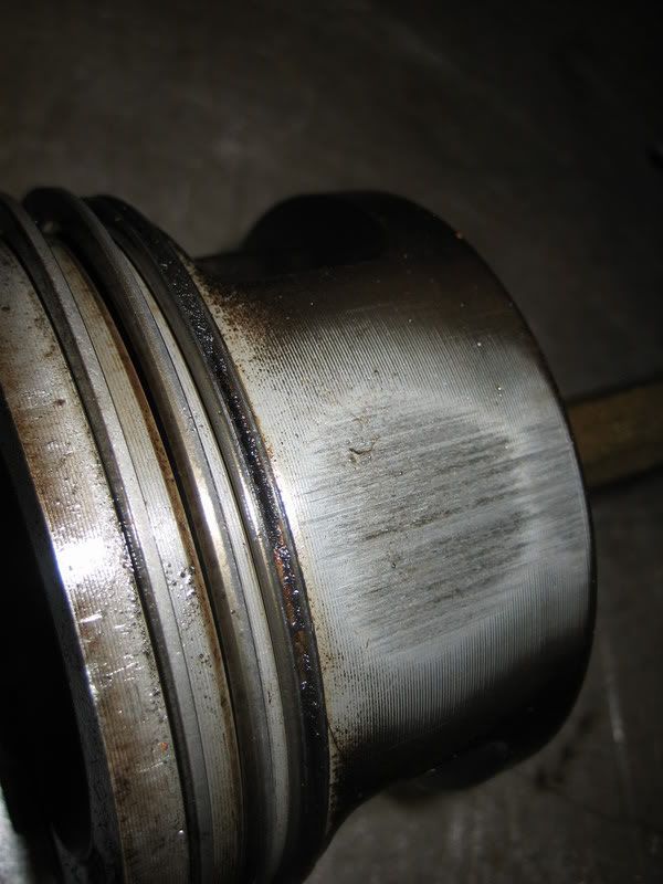

    Piston skirts

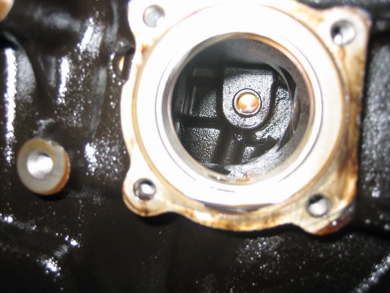

    Oil pump gone!

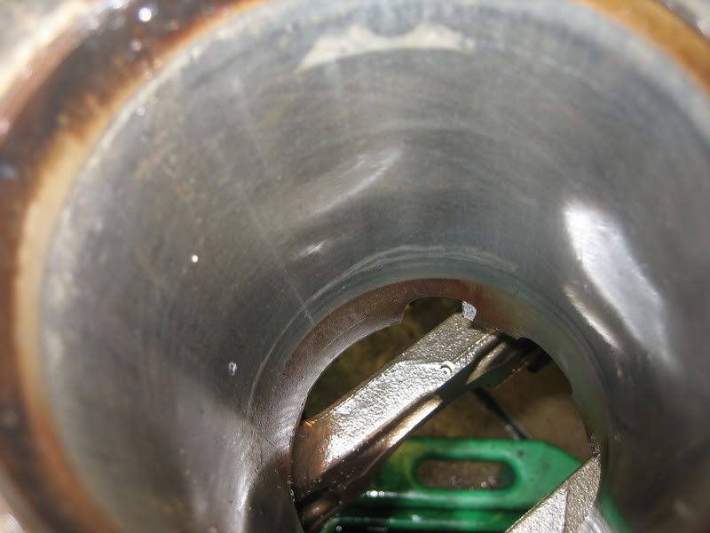

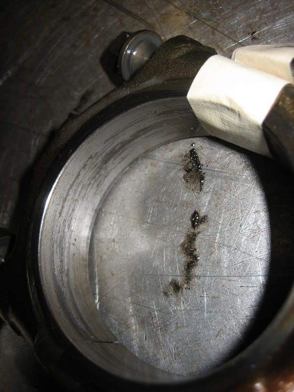

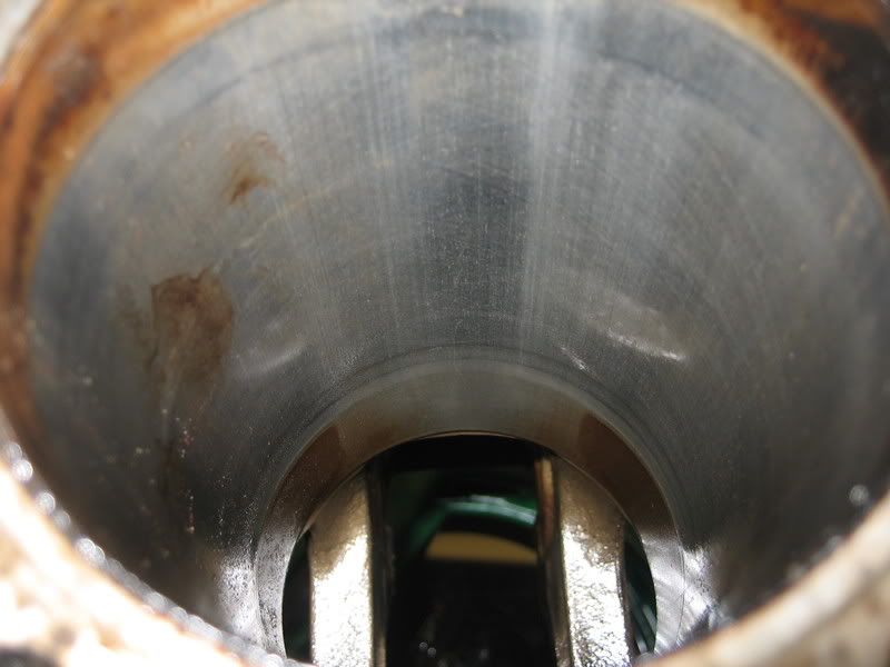

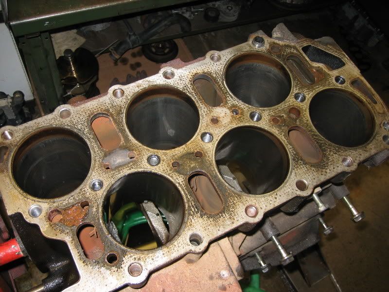

    Walls aren't too bad, I have a pretty good rust edge up top though. Worst one I measured was cyl 4 again, wore out 4 thousands max on the wall.

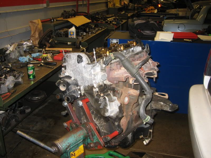

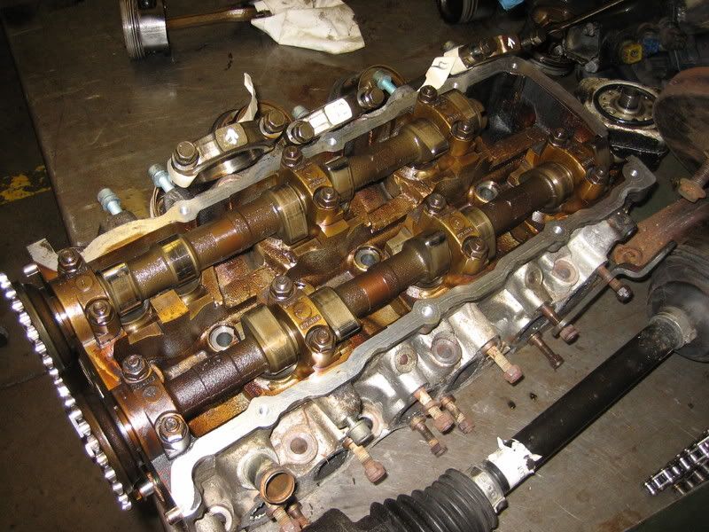

    head

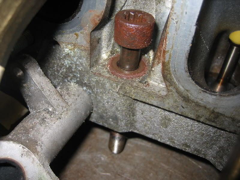

    I forgot to mention one of the head bolts bent on me, I think its because I messed up the order on taking the bolts out, I was off by 1 one 1 side

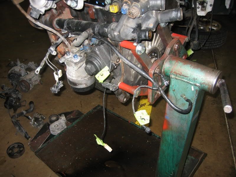

    starting to fill up....

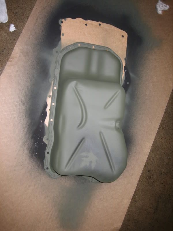

    This is my badass oil pan, with a stealth ghost leaf on it
    Olive Drab green FTW

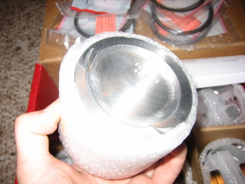

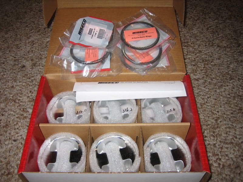

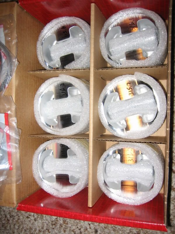

      Ok so this is today, 10-4-08 I just got a present in the mail. Pistons came in, on a Saturday even!
      Engine is off to get machines right now, I'm boring out 2mm more 81mm to 83mm. Also the pistons I got at 10.5:1 CR verses 10:1 stock. That with the mk4 HG will raise it to a final 11:1
      I need to track down a new connecting rod for sure now. Machine shop said my cyl4 that spun out is fucked. Still no word on if the crank will turn down. Best bearings they can find is 10 thous. undersized.

        Care to snap a pic of the underside of the head?

              Head I don't know what I am going to do at this point. I'm going to see how bad the bottom end breaks my wallet before seeing what I can put into the head. I will have the basic shit done like cleaning and having it resurfaced. Then I will probably get a mild PnP and port match the intake and exhaust myself. I guess the real debate is if I will cam it or not. Aside from that the valves and other stuff I will leave the stock in and clean it up unless something is broken. HD Valve springs and retainers just really aren't worth it with the mild amount of mods it will have. If I really wanted more power I would go with oversized valves but thats gonna hurt bad financially lol.
              I can take some pics of the head monday or so. I thought it would have some wicked cabon build up because on the leakdown the exhaust leaked on every cylinder. However they don't look too horrible. But thats where I left off on the head, just not worrying about it right now.

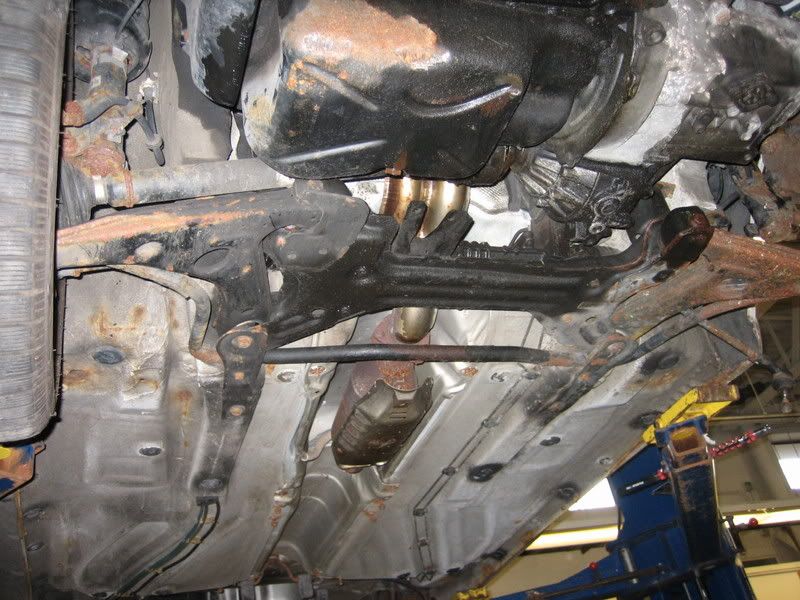

                Looking at those underbody shots, is that car considered rusty? I am from San Diego so I don't know.

                  Haha no, its uber clean for around here. It has a few small areas around the body, but nothing major. I'm going to roll the body over to autobody and have them take off the surface rust on the bottom and re-undercoat it all to stop the mild amount of rust it has now before it eats the whole car up in a few years.
