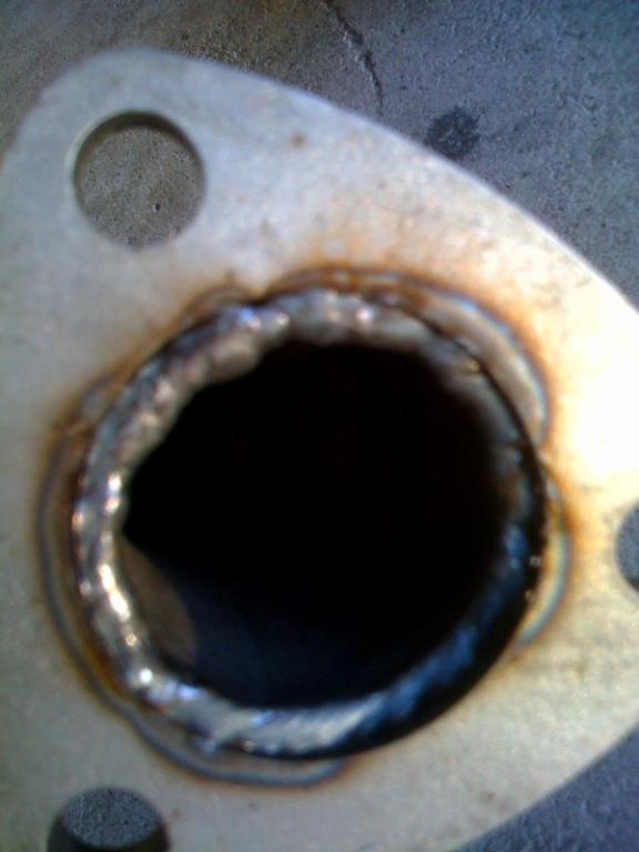

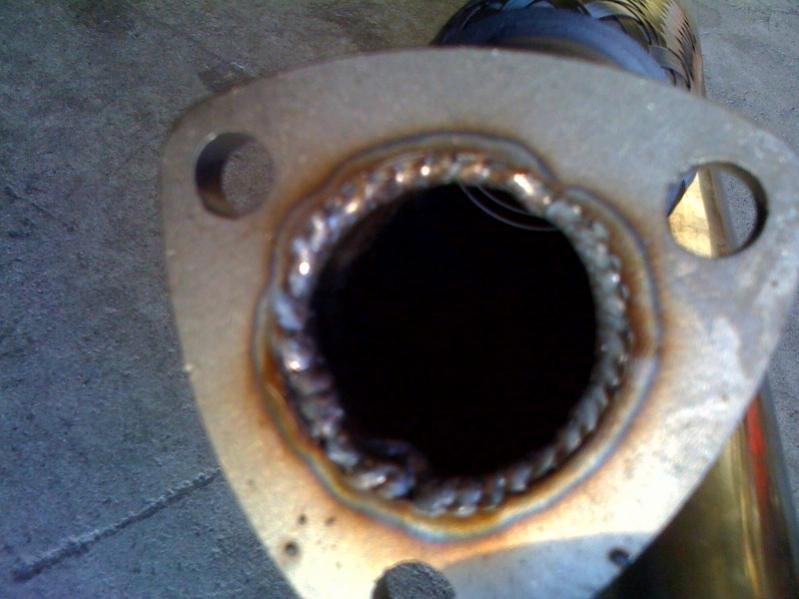

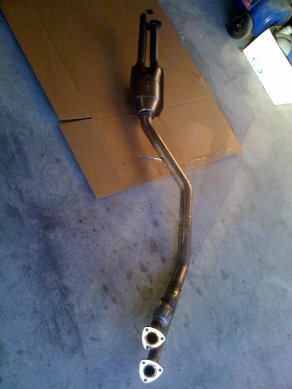

          How were the welds on your direct fit cat? The flanges that meet the manifolds on mine were cracked and not sealed. Just curious if your had smoother welds.
          I am in contact with Magnaflow to see what they can do.

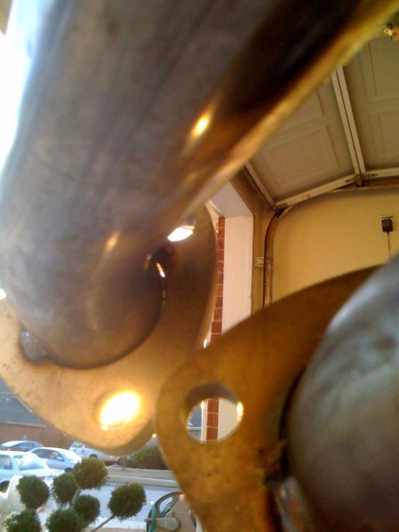

          The flair flange was also bent. when I took it out of the box (there was no attempt at packing this thing.. they just throw it in a box.

            thats a huge bummer
            mine was welded in the same place, but smoother and with no holes!
            ive nver had an issue, but i do run the manifold to header gaskets with a single doughnut and hondabond HT on both sides
