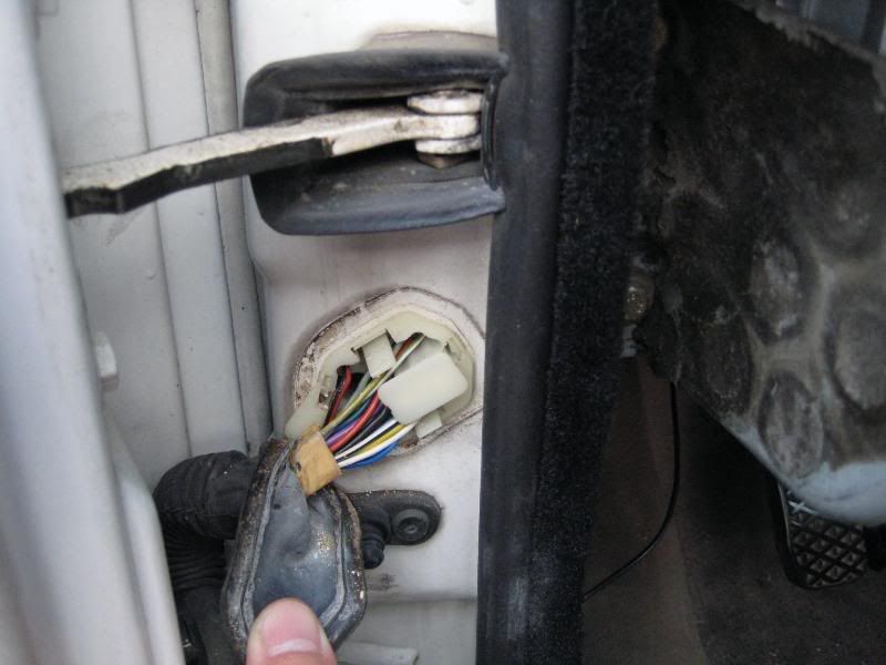

                • ///M42 sport
                  • 3952
                  thats a broad question. Narrow the source of your problem. Mine was with the circuit board
                  You could also have problems with the connection at the door
                  Or the locking mechanism at the key hole.
                  Renting my rear wheel bearing tool kit. SIR
                  http://i25.photobucket.com/albums/c5...ps6debf0b0.jpg
                  • reelizmpro
                    • 9523
                    Mine turned out to be corroded pins in the doorjam connector and 1 bad passenger side actuator. Then went to keyless entry soon after.
