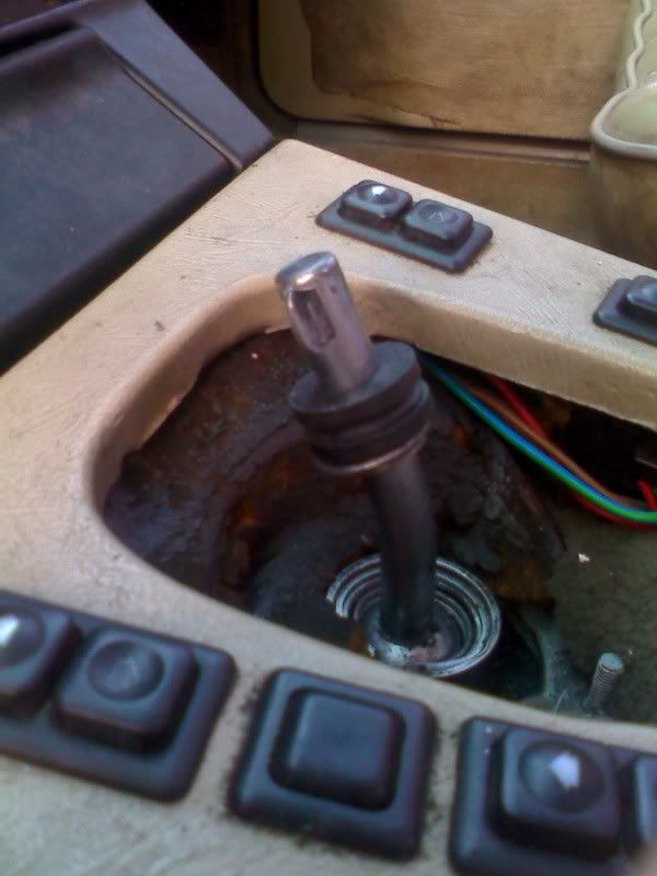

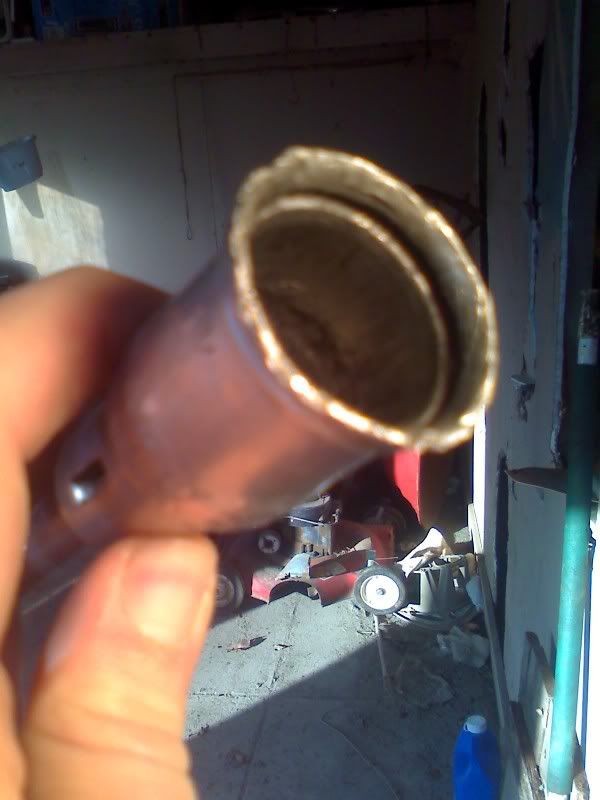

          I was driving the old e28 one day and while shifting into second the upper shift lever separated from the lower. I was able to get off the road and I found this when I pulled the boot.
          It seems some one previous to me had tried (for some reason), to separate the two and ended up mauling the shit out of the aluminum. You can see how the ridge is flared outward so the ring was no longer held securely in the groove.

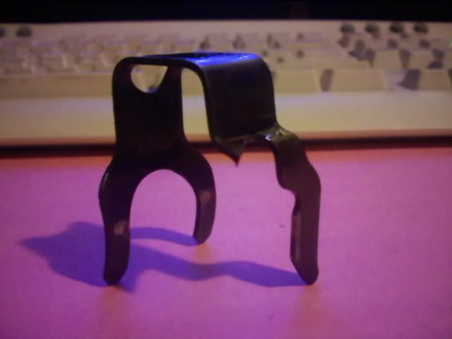

              Retainer clip ( I really have no idea how i broke it )

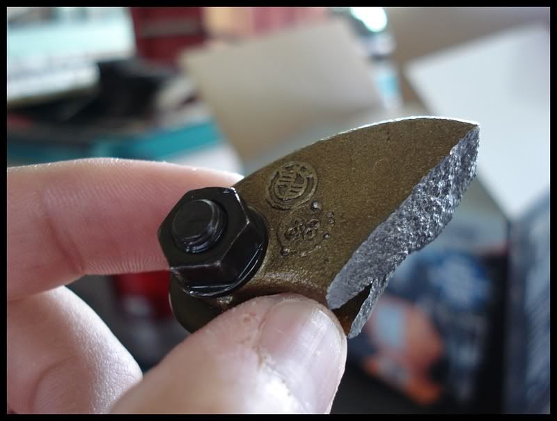

              and the quintessential rocker arm, racing an Audi A3 :)

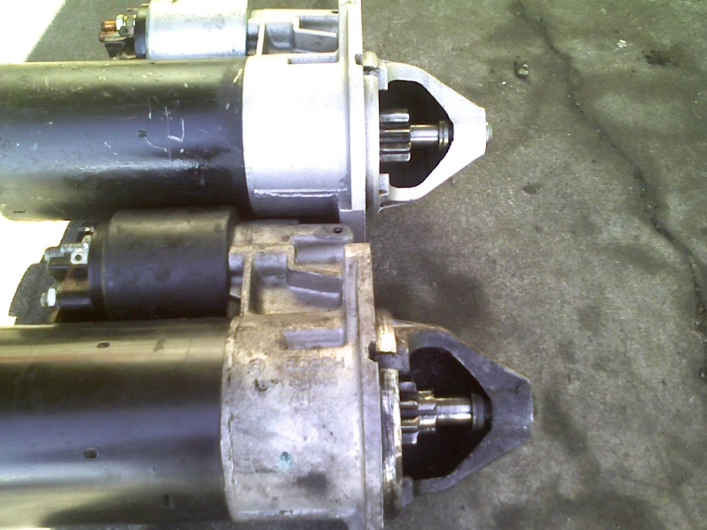

                    I thought this was truly messed up... so I look down @ the starter that refused to start my car about 2 weeks ago and what do I see?
                    (click pictures for detail)
                    ... so I unplugged everything on the front side and removed the dipstick. The motor came out w/ no ratchets or wrenches.
                    I threw in a used starter I had in the garage.
                    The "luke skywalker getting electrocuted" noise I heard probably was not electrical at all.. it was the starter jumping around under its own rotation.
                    Top bolt: missing
                    Bottom bolt: still in the hole, holding the severed piece of starter motor base
                    Here is the starter, removed:
                    I blame loose bolts.
                    I think the top bolt must have come out first. Under all of the chugga-chugga-chugga cold/sub-zero starts, the bottom bolt/bracket was under a lot of stress, the metal was ice cold, and when the bottom bolt loosened it made the entire motor jackhammer itself away from the bolt.

                      I'll see your starter...
                      ... and raise you mine.

                        my starter did something like that a couple of weeks ago
                        the top bolt was GONE and the solinoid screws had backed off almost all the way
