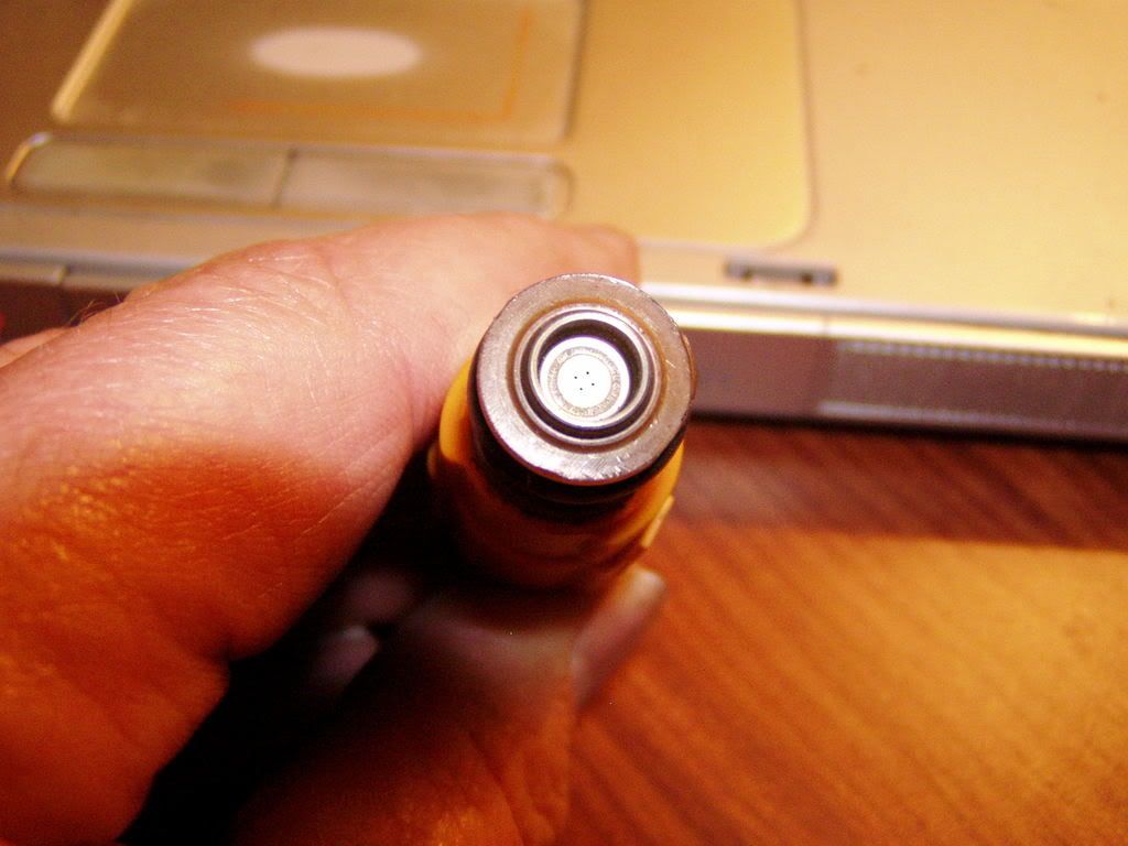

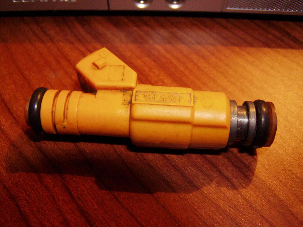

    Has anyone tried the Bosch "155" style injectors in their engines? What did you modify if anything to make them work? What results did you get with them?

                          This style injector has a design nozzle that looks good and there are many different types of injectors in the "155" series. I think this is the smallest set (0 280 155 746) I have at 199.7 CC/MIN. I was just wondering what had happened when others had tired them. I'll post what I find out after running a set or two of them myself.
