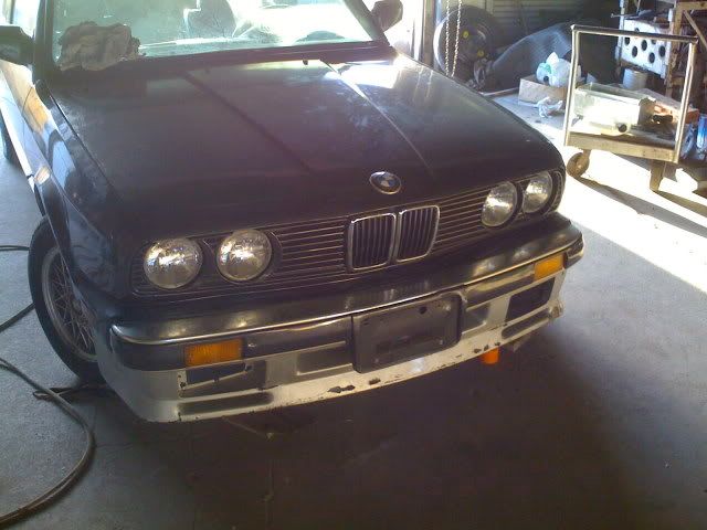

    Hey i just scored this for my car.. 87 325is 2door
    I got it off of another e30 (4 door)...
    Can anyone tell me which front spoiler it is and if its stock or aftermarket?
    When i got it..
    Fitting it and repairs.. This is how it looks on my ride before we paint it

    looks like a stock early model es/is valence. I know there is something about the slots in the middle that make it "rare", but I can't remember the details off hand.

        not rare but NLA the brackets for it are rare and NLA... that is a '86 325es front
        the one with the slots in the middle liek the one in my sig is from an '87 325is

          i looked at the 86's that you are referring to but they dont have the 2 slots underneath the mid section..

            I can't decide of you misread his post or not. The airdam you picked up is a stock 325es like BeirBrenner said. The airdam itself is not rare but the mounting bracket is rare primarily because it's NLA and nobody makes an aftermarket one.
            The difference between the "es" and the "is" are the two extra slots in the middle.

                  These guys are correct, it's an early version 86 style spoiler. The reason those center vents are there is because the 325i's came with an oil cooler. Fitting that early spoiler on your 325i means that you're blocking airflow to your cooler!

                    i've always figured that the earlier 'es' valence is a bit rarer than the later 'is' one since the early one was offered for a shorter time. I've seen a number of 'es' that got the later 'is' one. I prefer the looks of the earlier 'es' valence myself.
