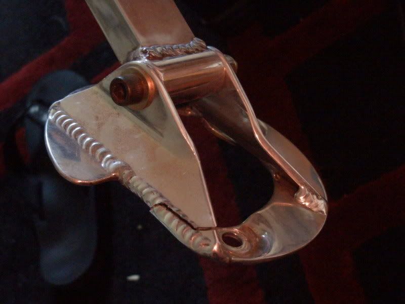

    I bought this bar brand new from BMP three years ago. It has been used for a short time on my old 325i, and then my brother's 318is.
    This bar was not on a car involved in an accident that would cause the break.
    I guess this shows how how beneficial using a good strut bar is. If the strut towers stress enough to break this bar, I don't want to even imagine how much the strut towers flex without a strut bar.

      Wow! So they're overpriced, AND their stuff is crap? :D

              yep, would have seen that one coming. Too little material for the amount of heat.

                huh? for the heat of welding it?

                  What does the backside of the crack look like? From this vantage point, it looks like a horrible design gone wrong.
                  ...wait...
                  Is that a crack on the arm joint as well??

                    i have one also. luckily it came with the car. i have rewelded it once after it cracked and spread on both sides at the same point and it is doing it again. i am going to try to back fill the area behind it this next time and start looking at a new non BMP one or make my own mason-ish copy out of chro moly.

                            if it is cracked, just back fill it when you re weld it.
