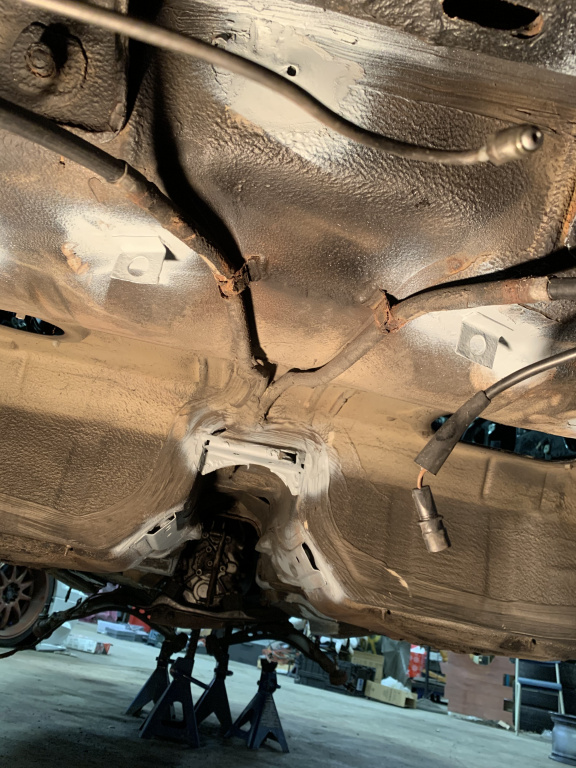

    replied

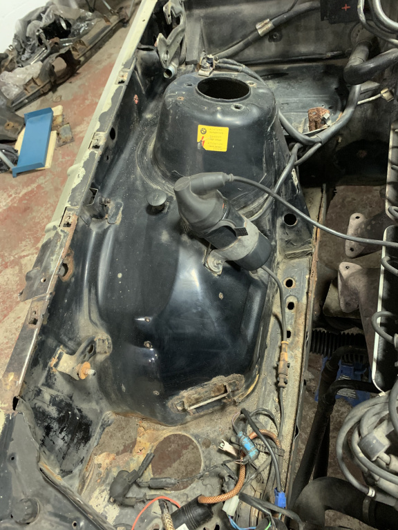

    More prep
    Progress!
    No more holes!
    Passenger side
    Leave a comment:

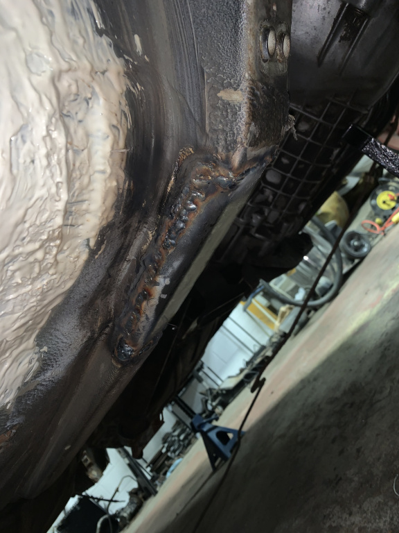

  • E30Rossi
    replied

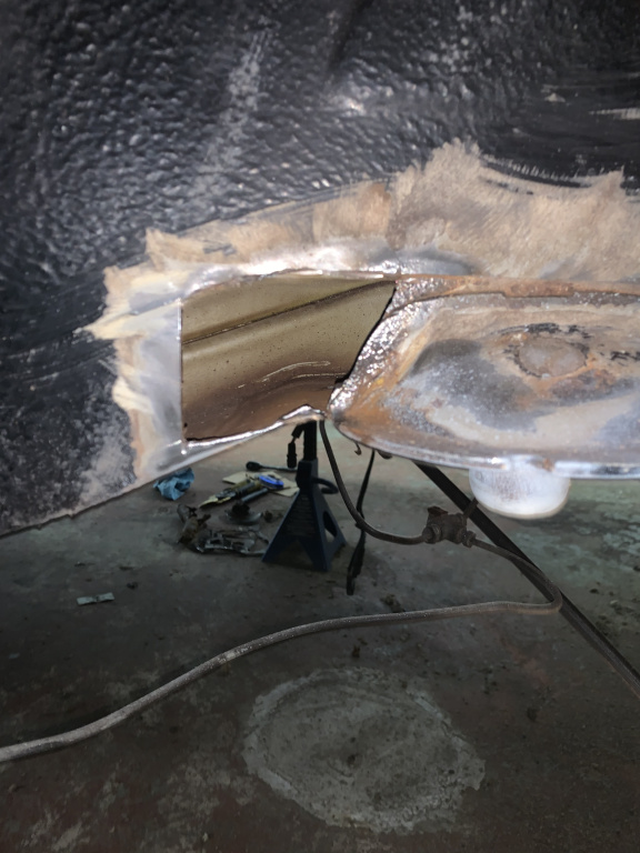

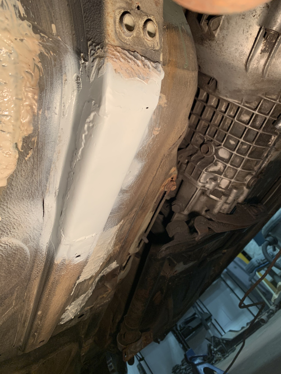

    Frame rail repair
    Grinded and primered

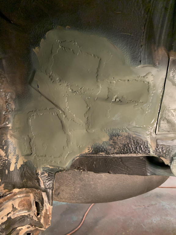

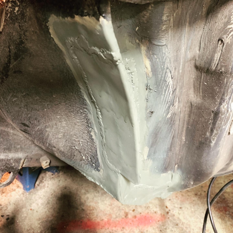

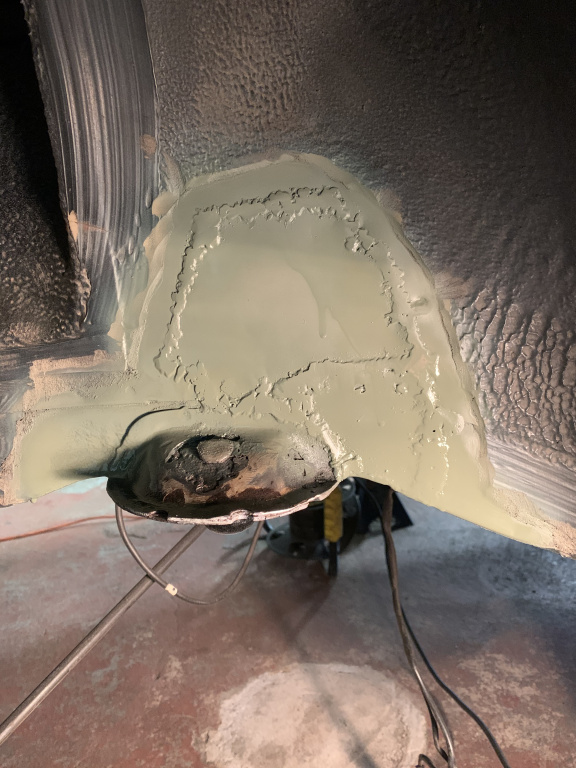

    Started patching all the holes, I may have been better off doing panel replacements at this point but it was a learning experience as this was my first project car ever
    Looks way better than before
    Started to scrub down every area under the car to prepare for undercoating
    Leave a comment:

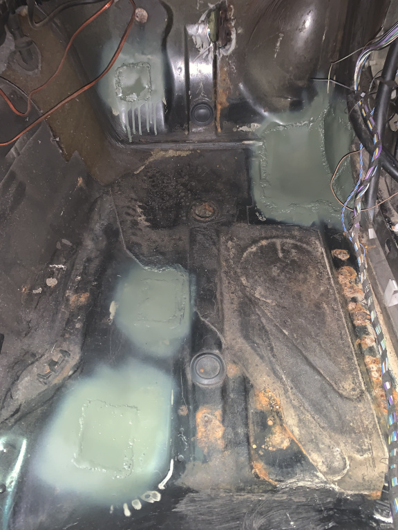

  • E30Rossi
    replied

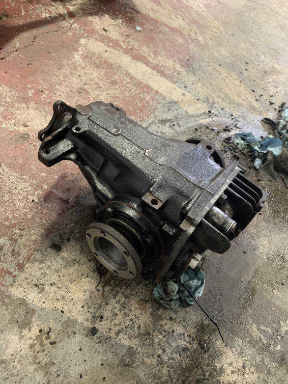

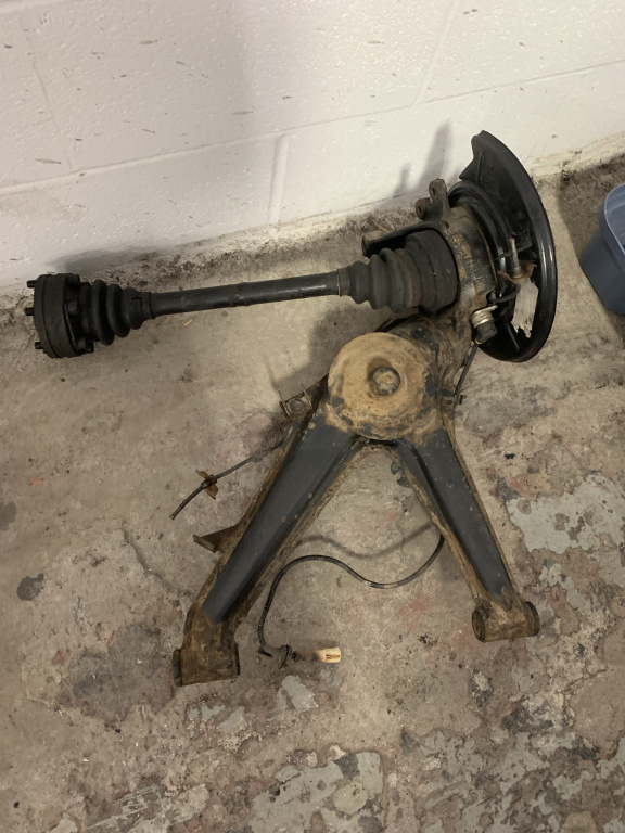

    Acquired diff replacement ! 4.10 small case... I knew nothing about E30 diffs at this point,
    Saw an ad for 3.73 LSD for E30, drove accross the border to pickup this great deal!
    Get to the seller, turn the diff to count the rotation and discover it was something around 3.25... not what I wanted
    Only other diff he had to offer was this 4.10 which he claimed to be LSD
    Later found out that small case would not be good for future plans and it wasn't even LSD...
    Oh well ,it lasted the next few years with no issues so I can't complain too much I guess!​

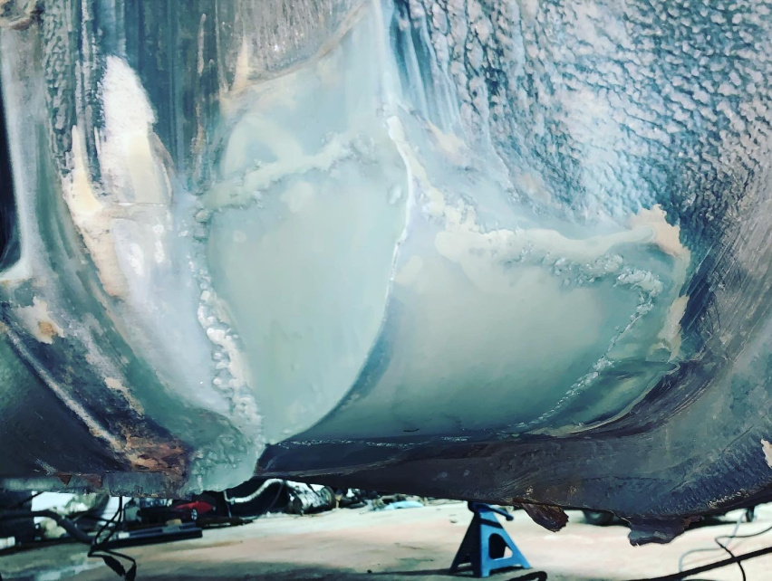

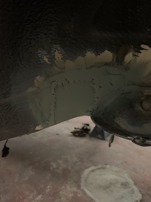

    Quick bumper shock refresh
    Reshaped front fenderwell to get rid of the huge gaping hole
    Driver side
    Grinded away any rust under the car and primered for now

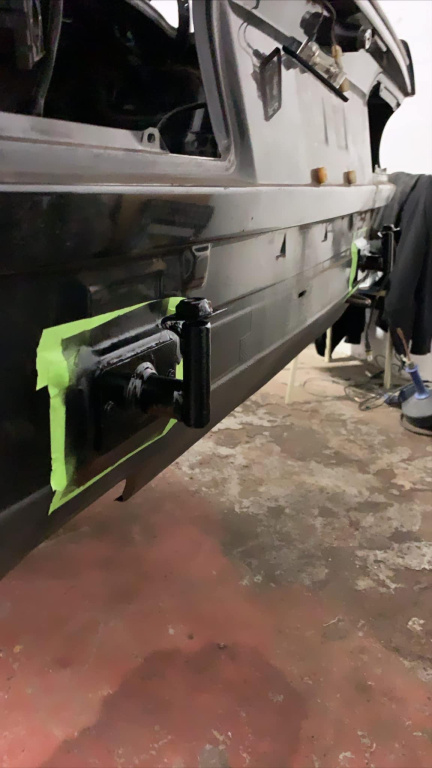

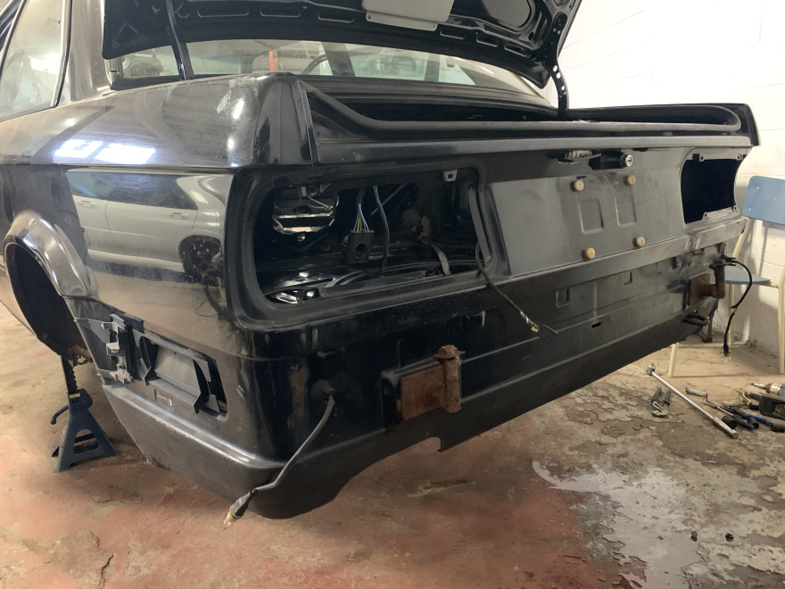

    Bumper removed to fix rear panel

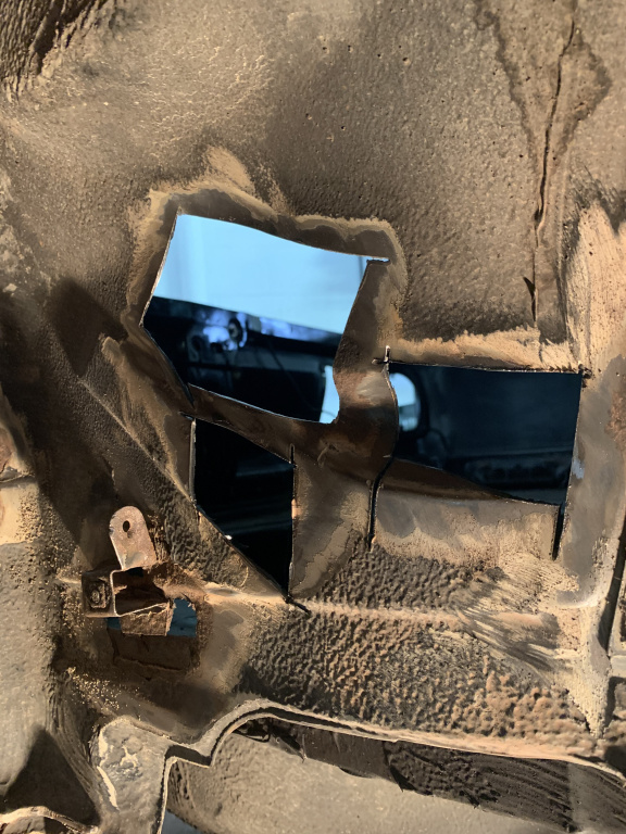

    Started to cut rust out! Gaping holes in your car is not a great feeling but better than rust!

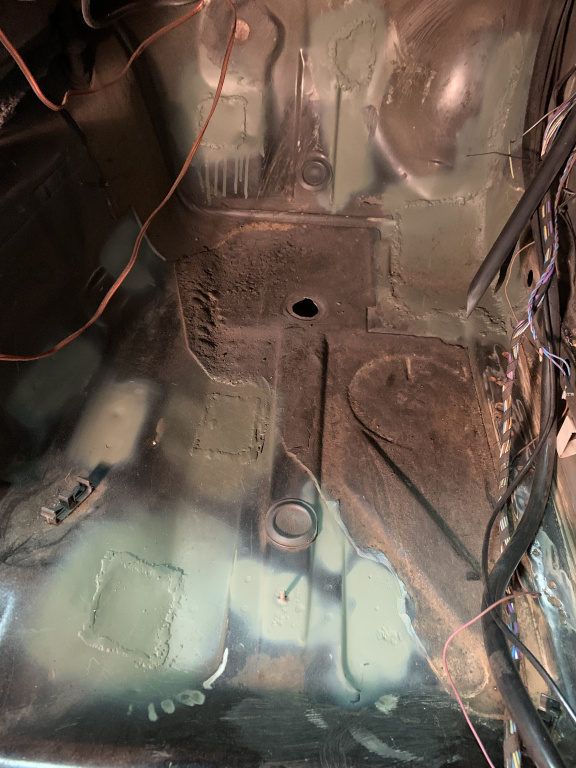

    Luckily I had access to a welder at the shop my car was stored at!
    Grinding away stock coating everywhere to find every ounce of rust while I was there
    Organization is key!
    All the area where the fuel line passes through the fender well were DESTROYED, found so many holes

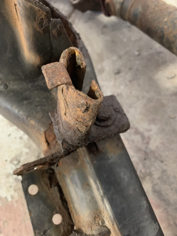

  • E30Rossi
    replied
    Definitely needs a cleaning!

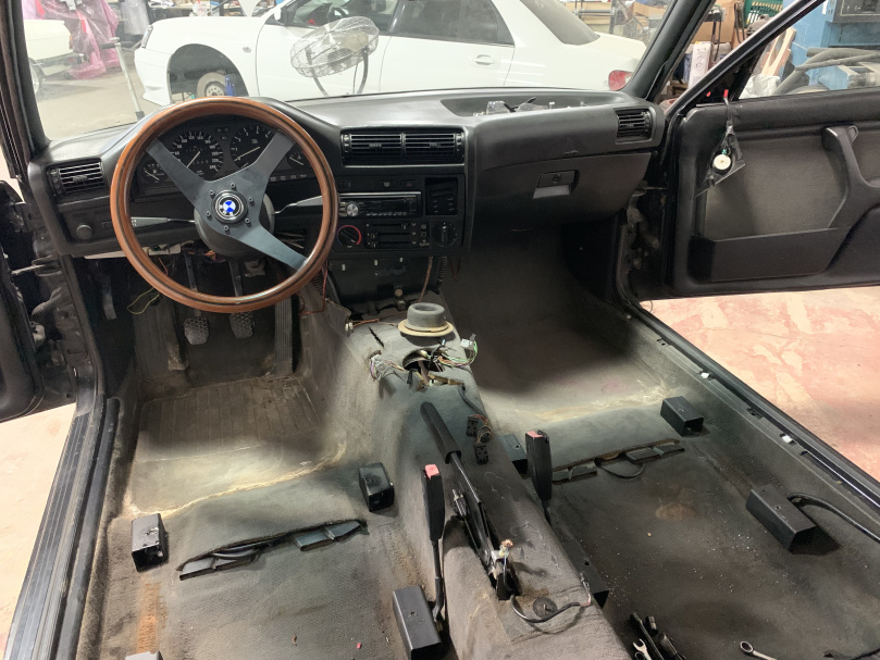

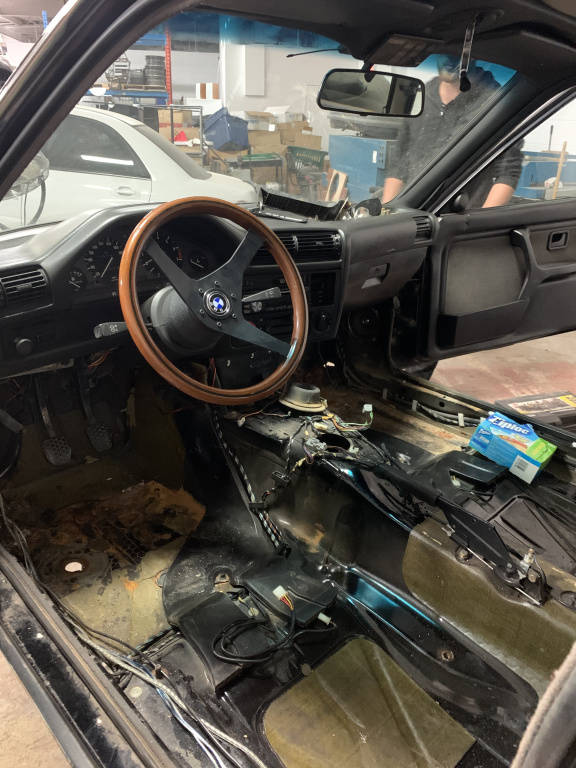

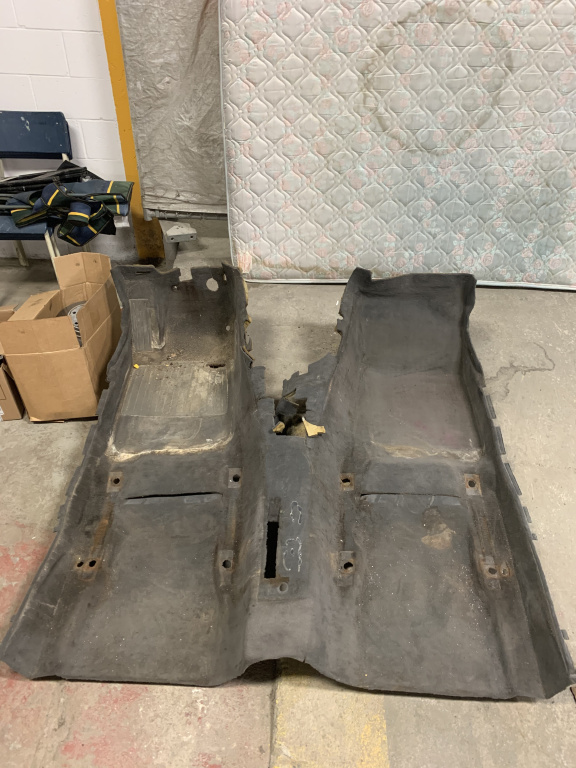

    Had to remove full interior as well

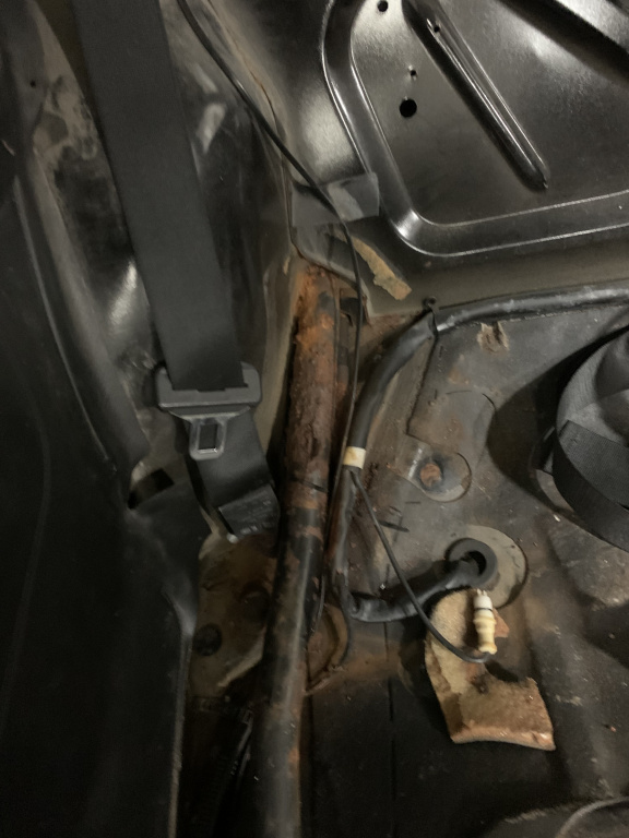

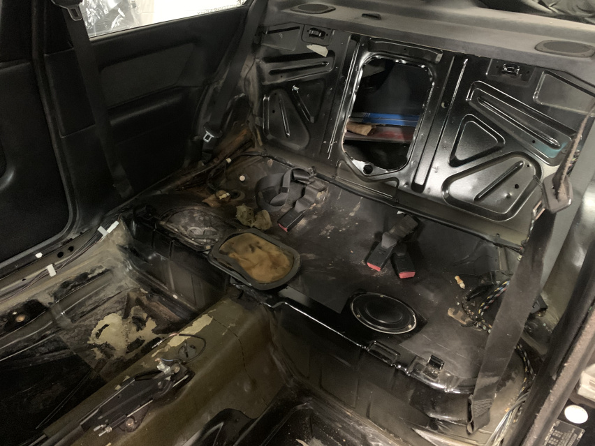

    Finding more rust - need to remove oem sound deadening

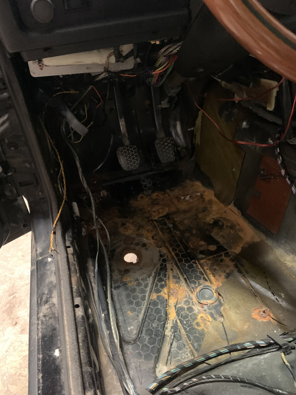

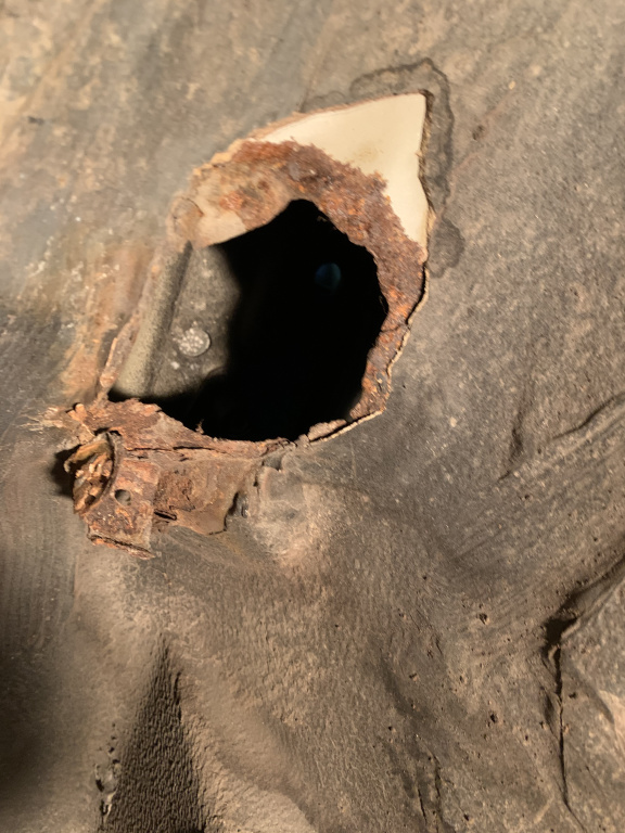

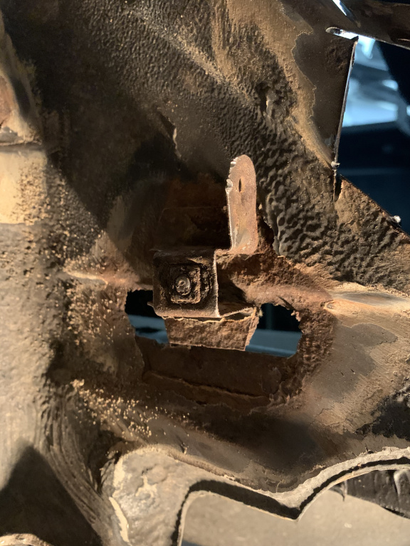

    Rusty fuel passage
    Leave a comment:

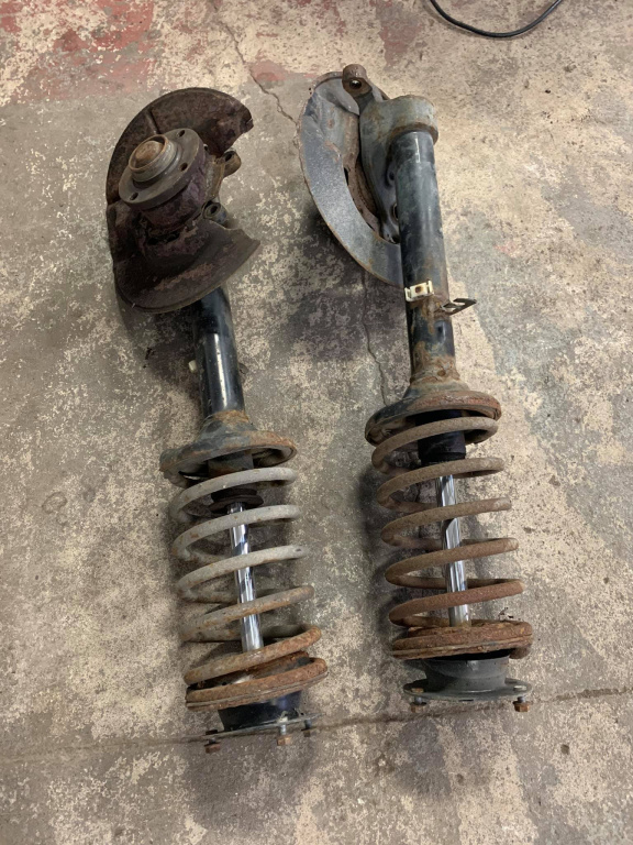

    Stock struts, never going back in here... This is where I started to lean towards 5 lug conversion

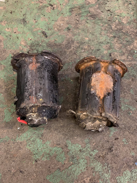

    Subrame bushings

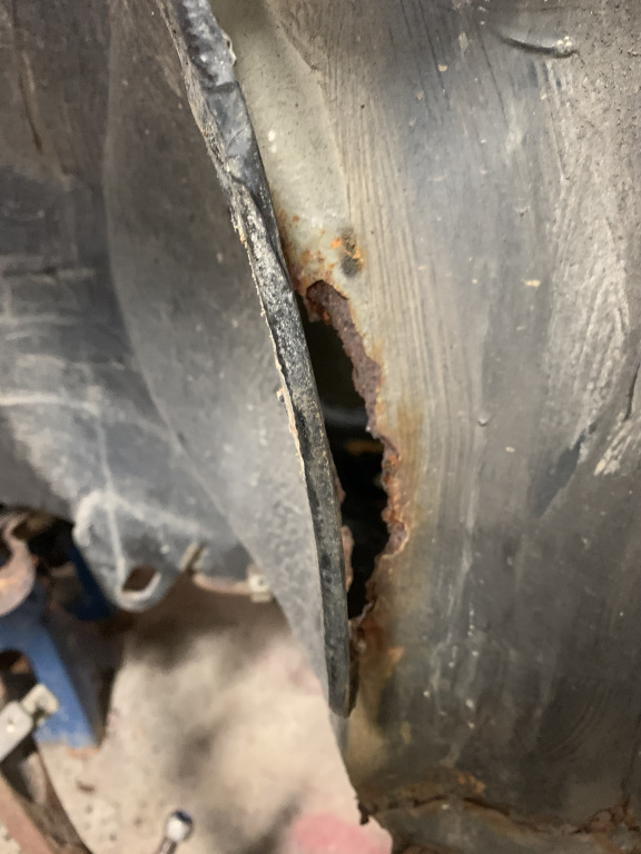

    It's everywhere
    Started discovering way more problem areas! Can't stop now

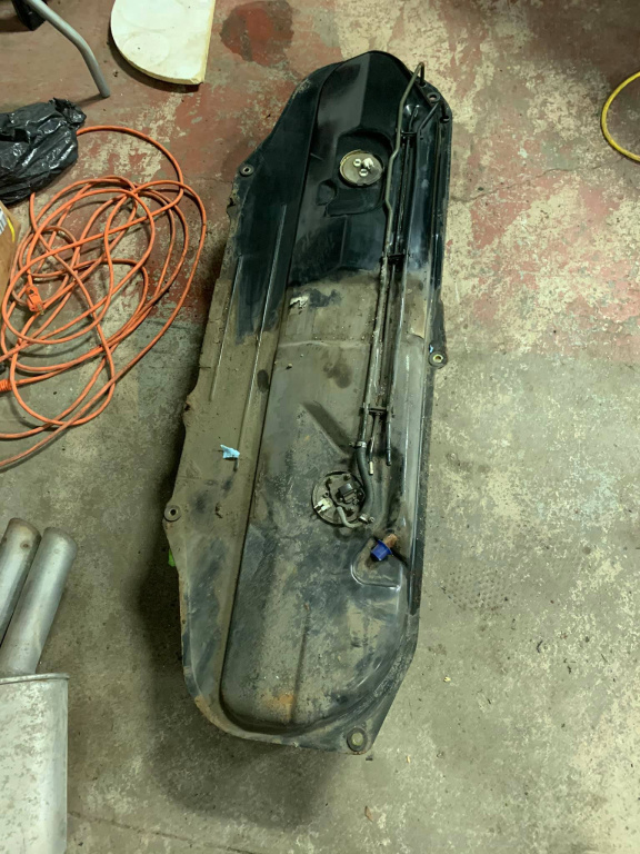

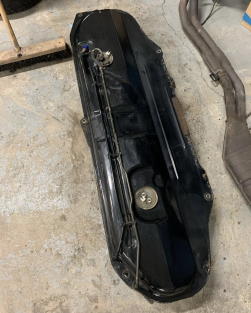

    Removed fuel tank to see every corner under the car, and for welding purposes

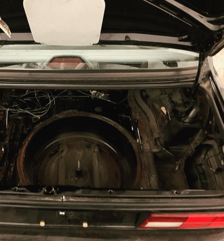

    Stripped down to nothing
    Leave a comment:

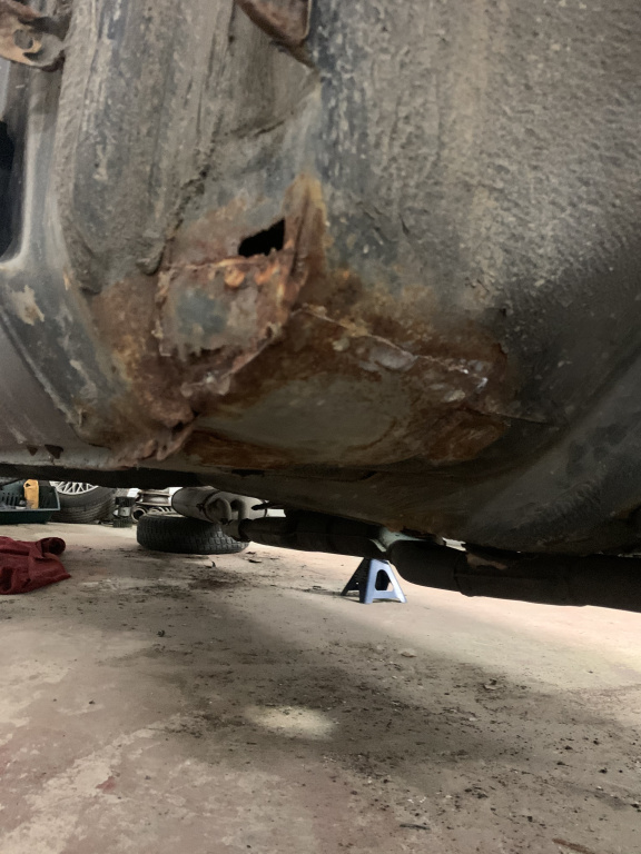

  • E30Rossi
    replied

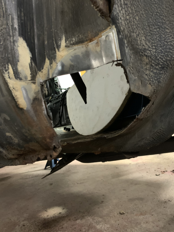

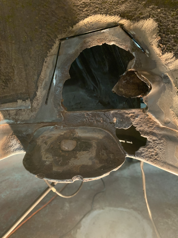

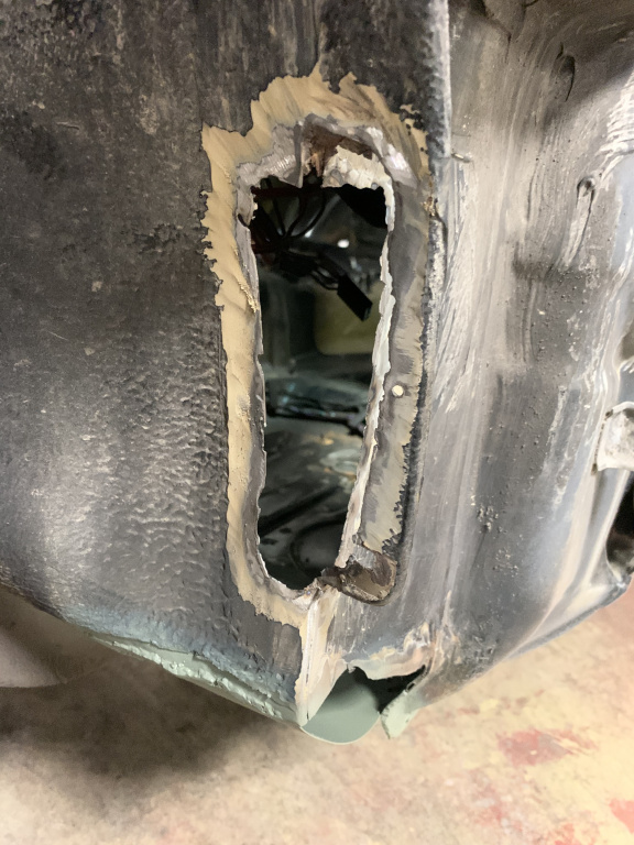

    The frame rail hit something and has a gaping hole
    Discovering all the repairs to be done...

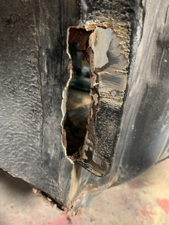

    Holes EVERYWHERE :(
    my friends had fun poking holes in my car with a screwdriver... not me
    Other side just as bad
    Leave a comment:

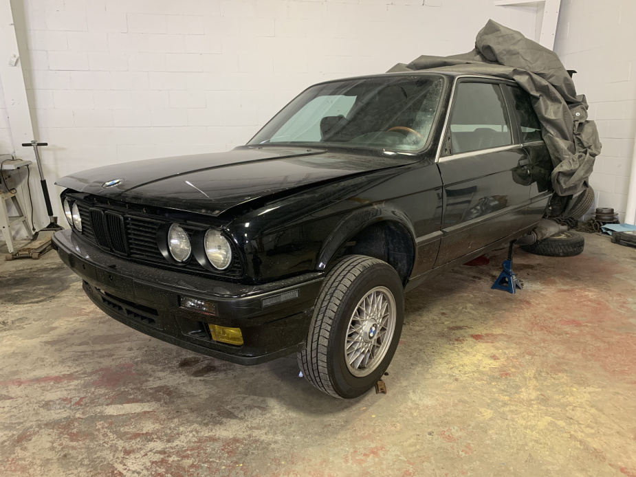

    Her Home for the next year and a half

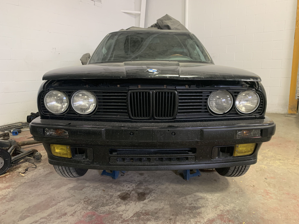

    Yellow fogs looking cool

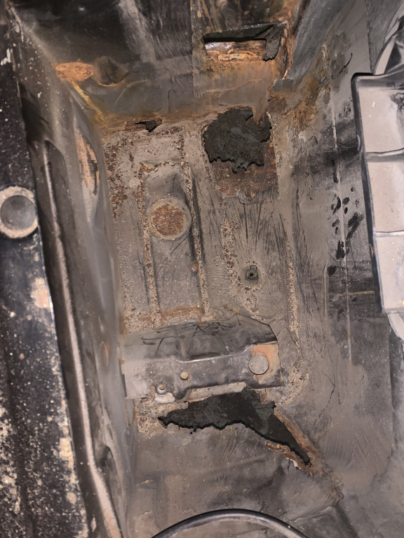

    Rust...everywhere

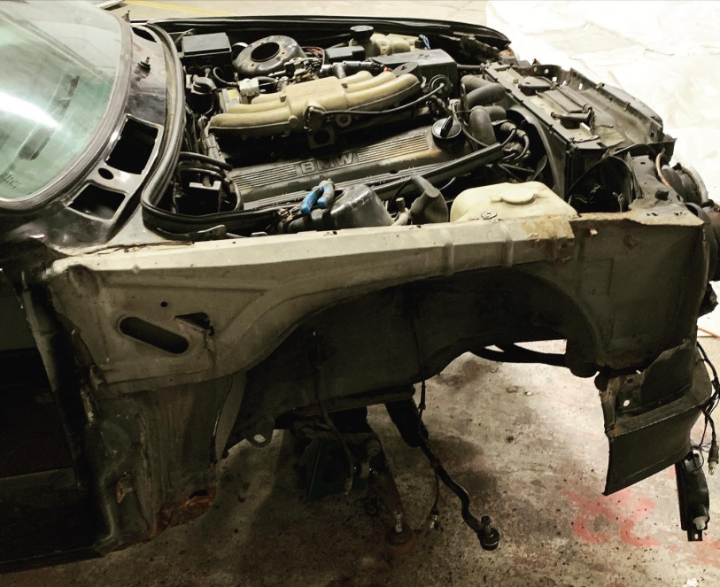

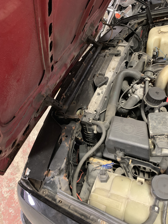

    Sad looking engine bay
    Didn't want to touch this part because I knew i'd get here one day, which is where i'm at now (2023)
    Begin removing things
    Couldn't possibly put this back in looking like this.. which caused me to take a year off to collect parts
    Gross...

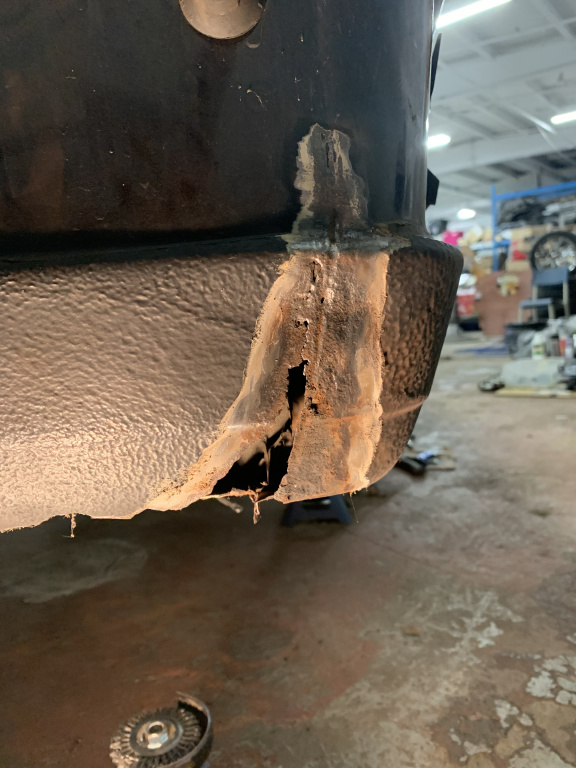

  • E30Rossi
    replied

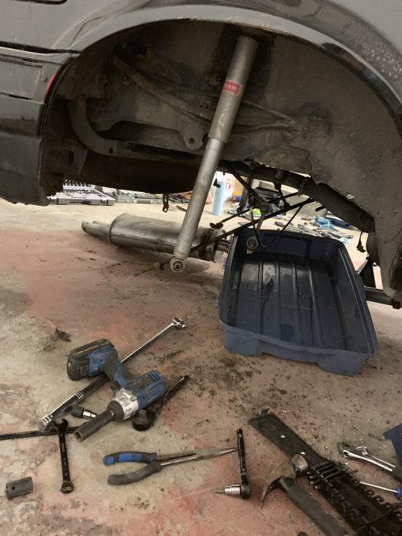

    First time we ever got vanity plates in Quebec, had the jump on the opportunity! SR is my initials and also my photography brand @photography_sr for automotive photography!

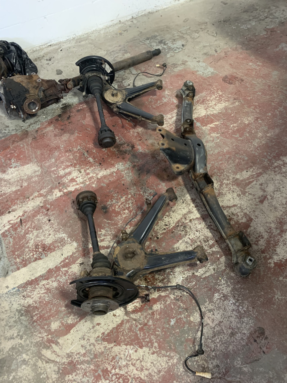

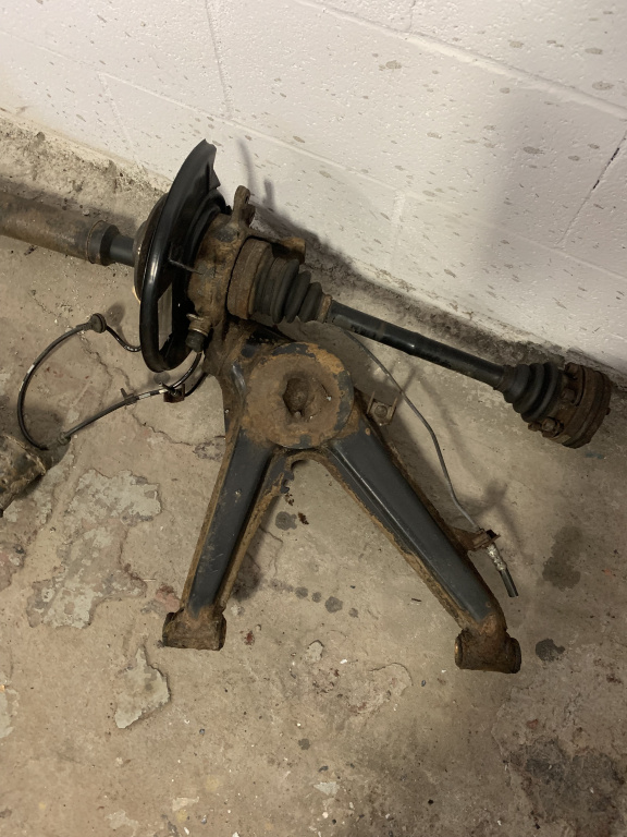

    Since I bought the car, the diff was always leaking, and there was a few knocks in the suspension
    At some point during the first winter storage, I decided to remove the diff to address the leak
    This led very quickly to pulling the entire rear subframe to refresh it after one look at it...
    This led to the "While i'm here" addiction which never ended until today​
    After the first summer driving it, I stored it for winter which ended up staying there the following year since I know at this point a full rebuild had to be done
    First things first, Got rid of entire AC system, compressor was seized

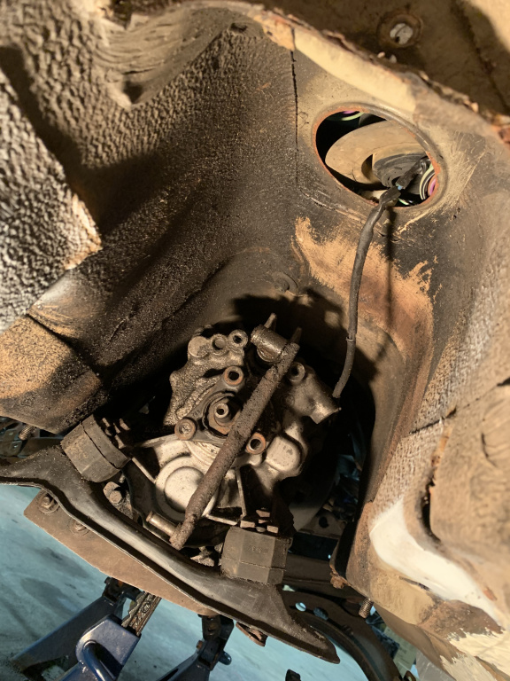

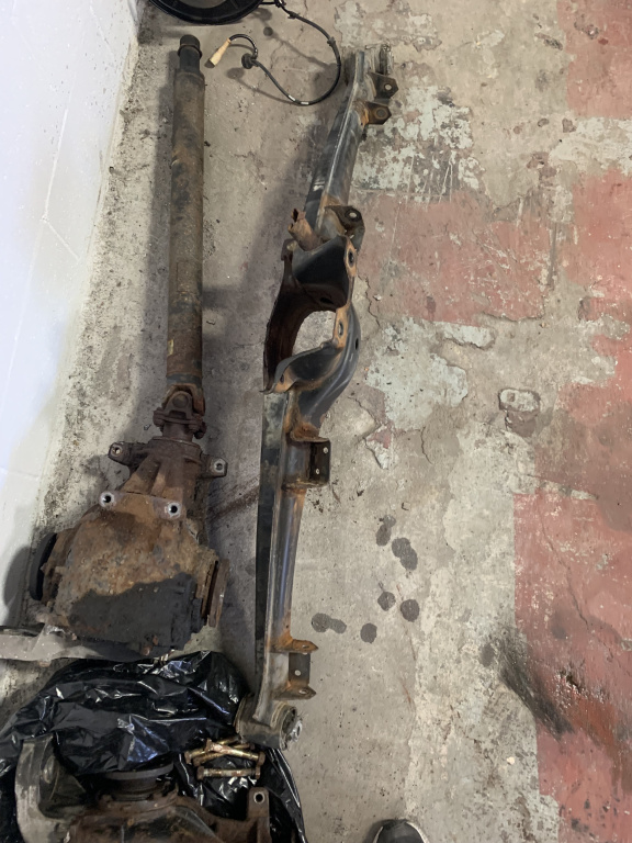

    Rusty leaky diff and first look underneath
