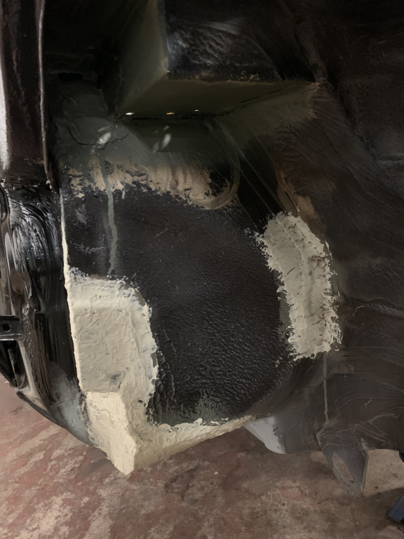

    Passenger side Rear
    Driver side
    Trunk Jack holder
    Rear valence
    ain't pretty but better than water getting inside
