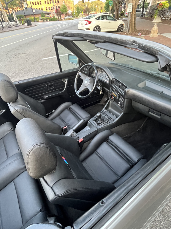

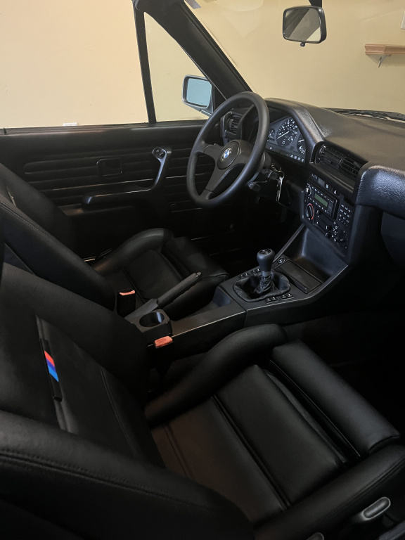

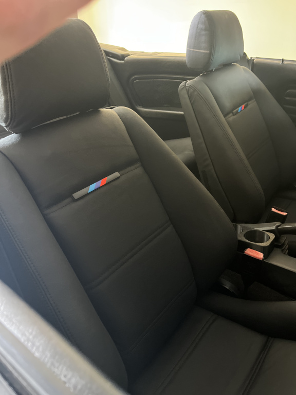

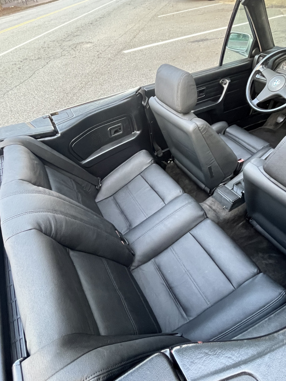

        Seats are done. I will add some proper photos soon. I have the mtech seat badges and I want to be intentional as to placement.
        As you can see in the photo, would I put the prongs through the top thread, bottom thread or directly in between?
        and do you need to take the back of the seat off to bend the prongs once installed?
        The prongs are bigger than I imagined and will be leaving some holes, so any help is appreciated.

          Need to take some decent photos of interior. Need to use heat gun on some of the creases, but overall pleased. If anyone has any advice on the mtech seat badge, please let me know how to properly install before I put some holes in my new leather.
          here’s a sneak peak of what’s coming:
          • reelizmpro
            • 9537
            #35
            Yeah it should have been done when reupholstering. They go through the center and bent from behind. Another option is to cut the prongs off and attach it with double sided tape. This is easy to do and doesn't leave holes in your leather.

              I appreciate the reply. I can’t imagine it would be too difficult to remove the back of the seat in order to bend the prongs back. I have a hard time thinking the double sided tape against the leather would last in the southern heat.

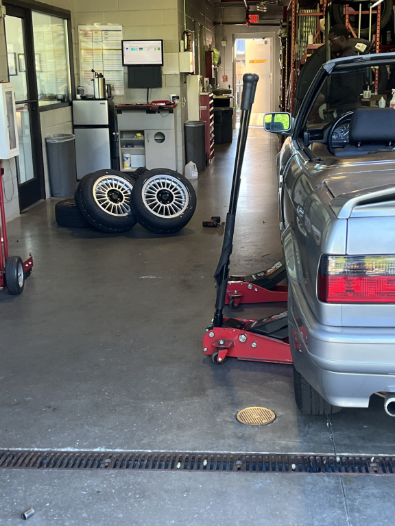

                New wheels and tires are on. Suspension is next week.

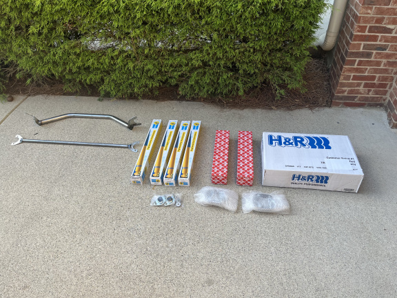

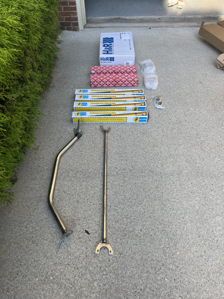

                  Going back to the shop tomorrow to address the following:
                  - Install new Bilstein Spring and h&r sport (cabrio) springs
                  - rear shock mounts
                  - front and rear strut bars
                  - tie rods
                  - IE adjustable camber plates
                  - adjust power steering leak
                  - valve adjustment, timing belt, water pump, and other misc.

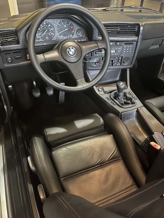

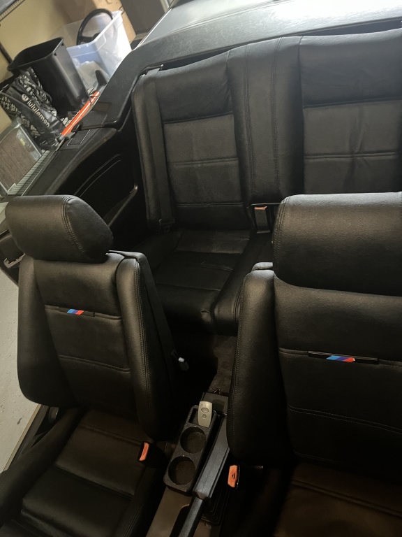

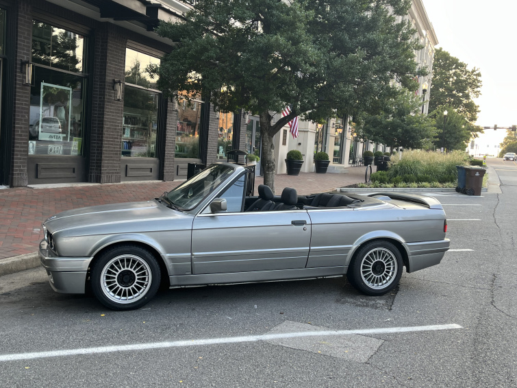

                    Quick interior photo

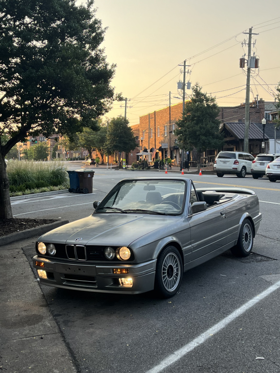

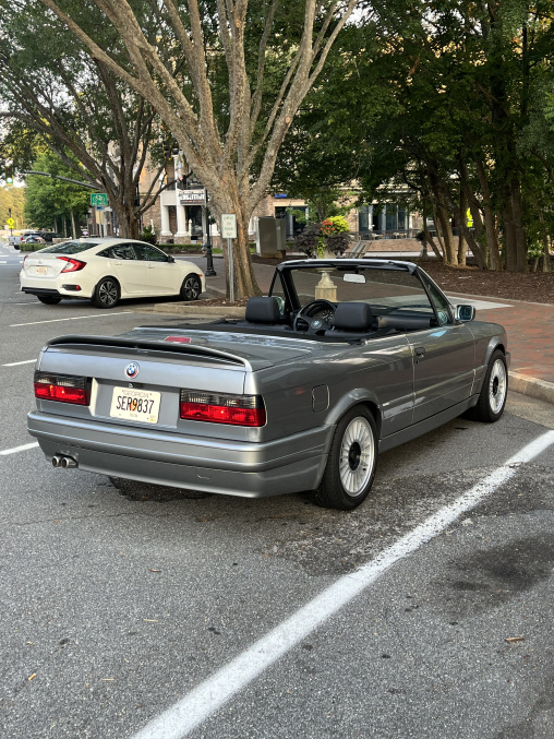

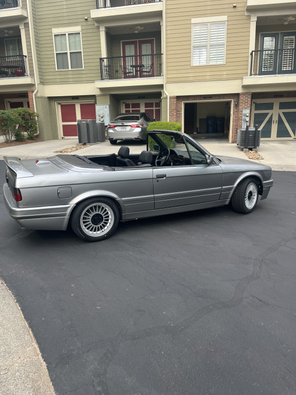

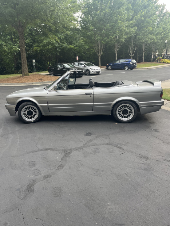

                        Finally some pics now that the car officially has all the parts on.

                          #42
                          Interior

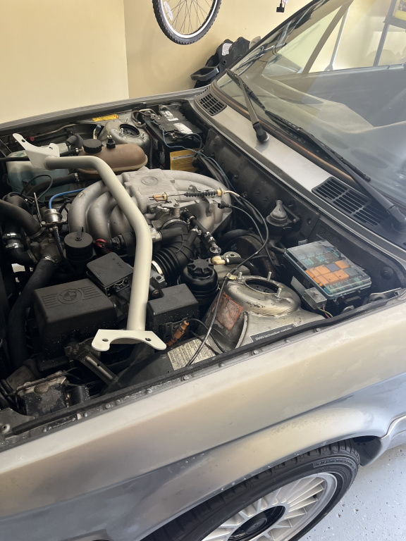

                            Quick snap of the new strut under the hood. I ordered and painted the rear not knowing that it isn’t compatible with the verts, so if anyone is interested in a rear strut bar, DM me.

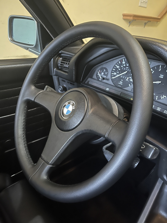

                                #45

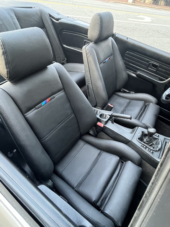

                                Really happy with how the interior is taking form. Finally ended up with oem hi shift knob and received freshly wrapped leather sport steering wheel.
