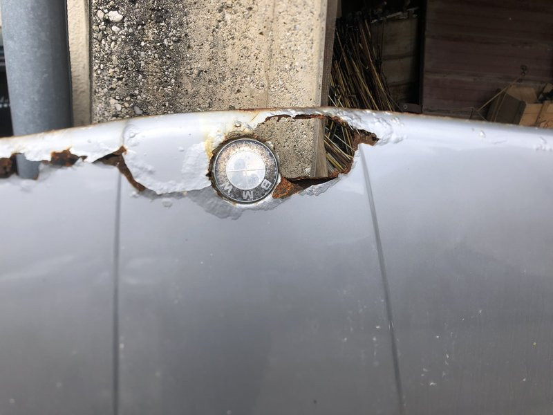

    Then the next step was the front of the car as the drivetrains were in very bad shape, the handling of the car was awfull and as the car was stored close to the sea it suffered a lot from the long outside storage. Look at the condition of the hood, I have to confess I was almost crying!
