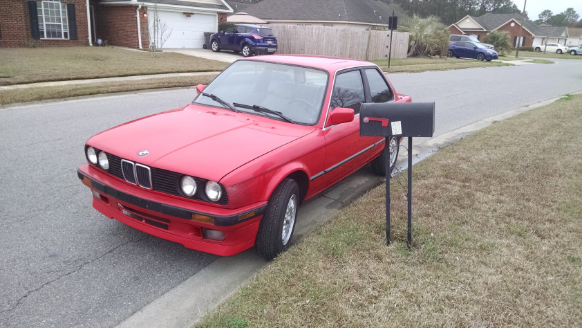

    This e30 was purchased from another member here on r3vlimited.com about 8 years ago now as a weekend car for my wife.
    Click image for larger version  Name:	IMG_20180218_164450762.jpg Views:	0 Size:	222.3 KB ID:	10155054
    It was in need of some TLC but overall a good example of a late e30 coupe. The first project was a good tune up and replacing the worn suspension. I went with the standard bilstein b8 h&r combo with ground control street camber plates.

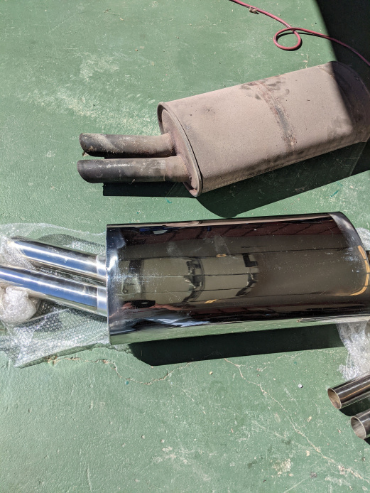

    This was a big improvement to how the car ran and drove, but being in south Georgia the none working ac had to be addressed. The front seal on the compressor was leaking & the system had been empty for who knows how long so i replaced everything except for the evaporator. I also installed a spal 16" pusher fan wired into the factory 2 stage resistor. After a r134a conversion the ac works, though idle performance is not great so ì may do a sandon conversation later on.
    Click image for larger version  Name:	PXL_20240514_192320166.jpg Views:	0 Size:	220.8 KB ID:	10155058

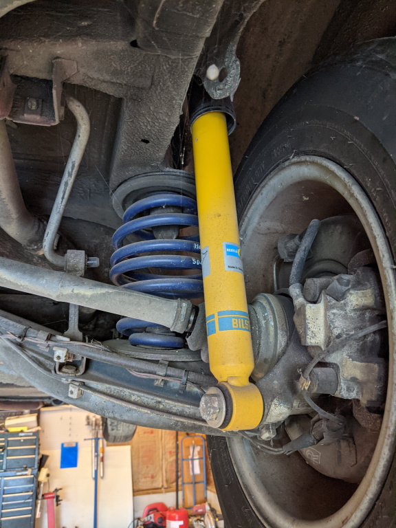

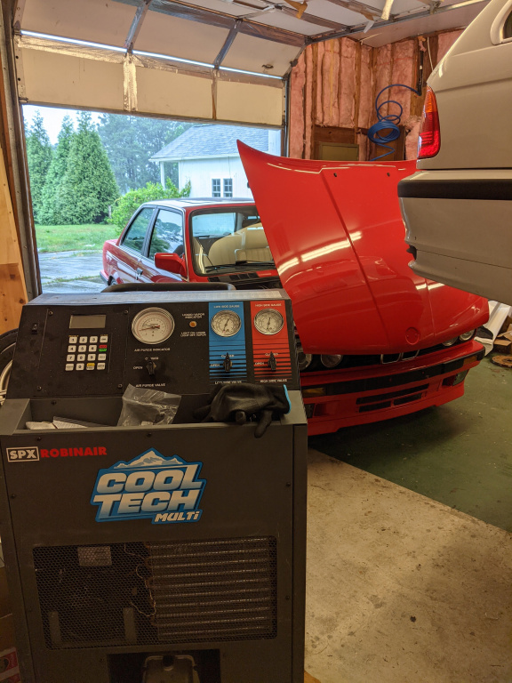

        With the car running better from a tune up, the suspension sorted and a/c fixed we just enjoyed the car. Driving at night was horrible with the later sealed beam headlights so I installed some depo headlights with squared adapters for morimoto mini h1 xenon headlights. This was a huge improvement in night driving even if it did involve cutting up brand new parts.

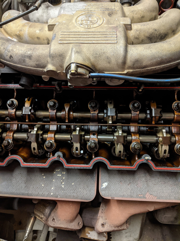

        A broken intake rocker thankfully the other half had not gotten into anything else. I replaced all the rocker arms with Ireland engineering heavy duty rocker arms, that was a chore with the head still on the car. After a valve adjustment I put everything back together and it idled perfectly again, when driving was a different story. After the car would come up to temp it would start breaking up around 2500 rpm. I'll get into what I found in the next post.

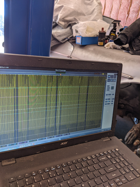

          I chased the running issue for what felt like months. I have a scan tool that will communicate with the DME but the sample rate was to slow to catch anything and no faults where stored. It felt like ignition so I checked everything for signs of an issue, replaced the coil, plugs & wires but no change. I pulled the fuel rail & checked the spray patern of the injectors, not great but they all flowed. I put in a set of e36 injectors just to see.
          Still no change in running. Finally I picked up a cheap oscilloscope and started checking signals. My new crank sensor looked like this.
          So another crank sensor was installed & now the E30 was finally running correctly again. After dropping the exhaust during diagnosis the muffer cracked at some rust and the front rubber exhaust mount was falling apart. BMW does not sell the insert separate from the mount but some measuring led to a polly mount that worked. Part number in the picture if anyone needs it. I replaced the leaking muffler with a stainless muffler from Ireland engineering, it is my wife's car & she didn't want anything too loud.

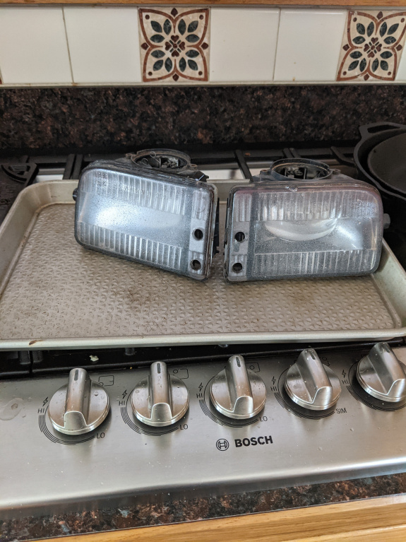

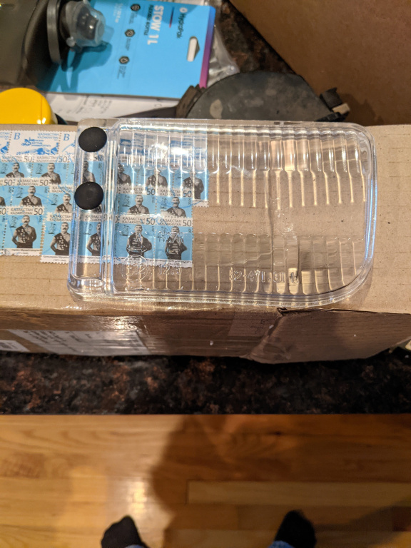

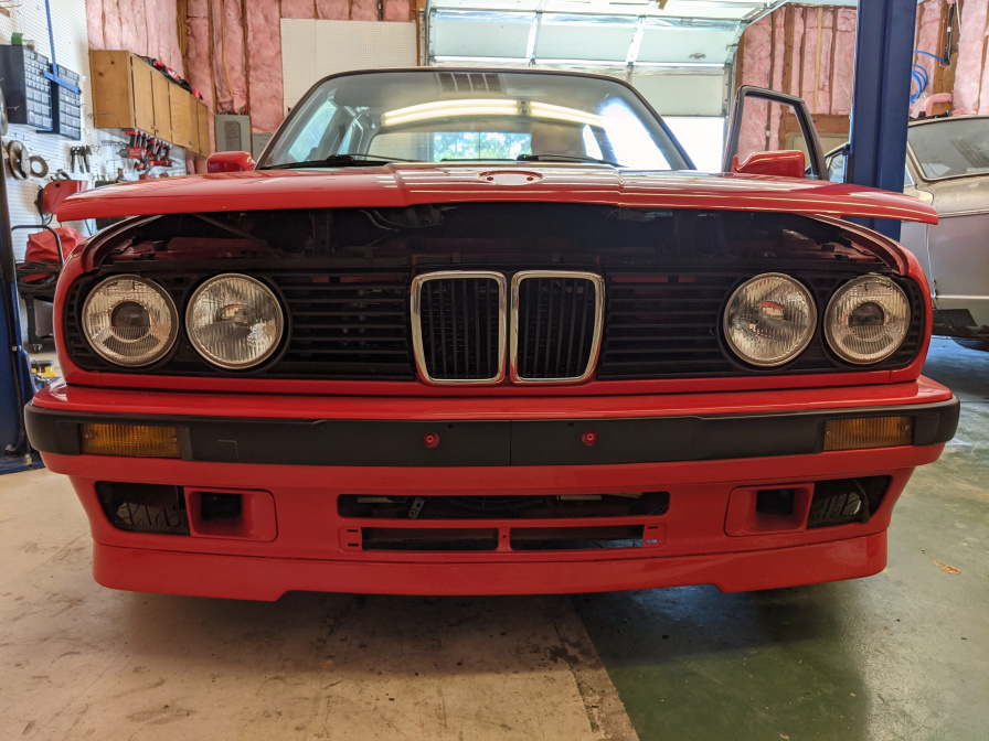

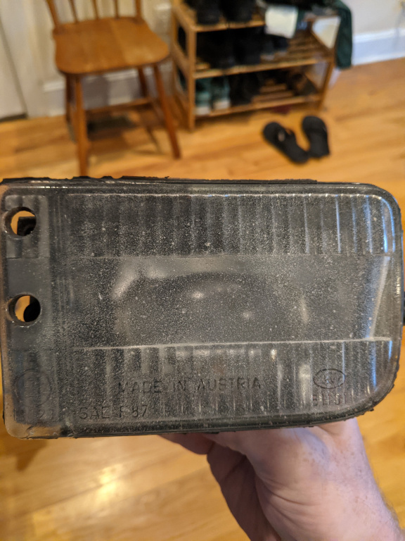

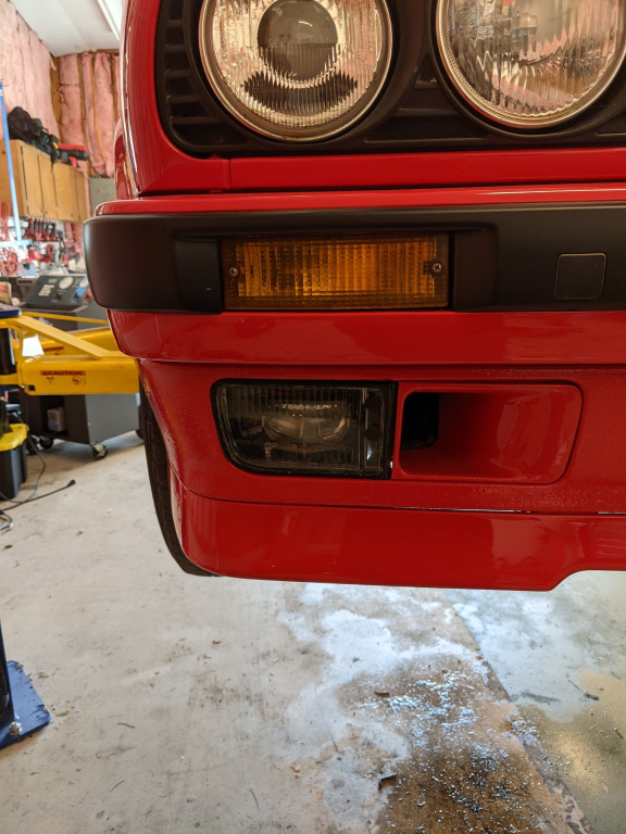

            The fog lights were also looking pretty rough. I found a seller on Ebay selling replacement glass lenses, a bit of time in the oven & the old lenses were removed. The new ones were then glued in place.

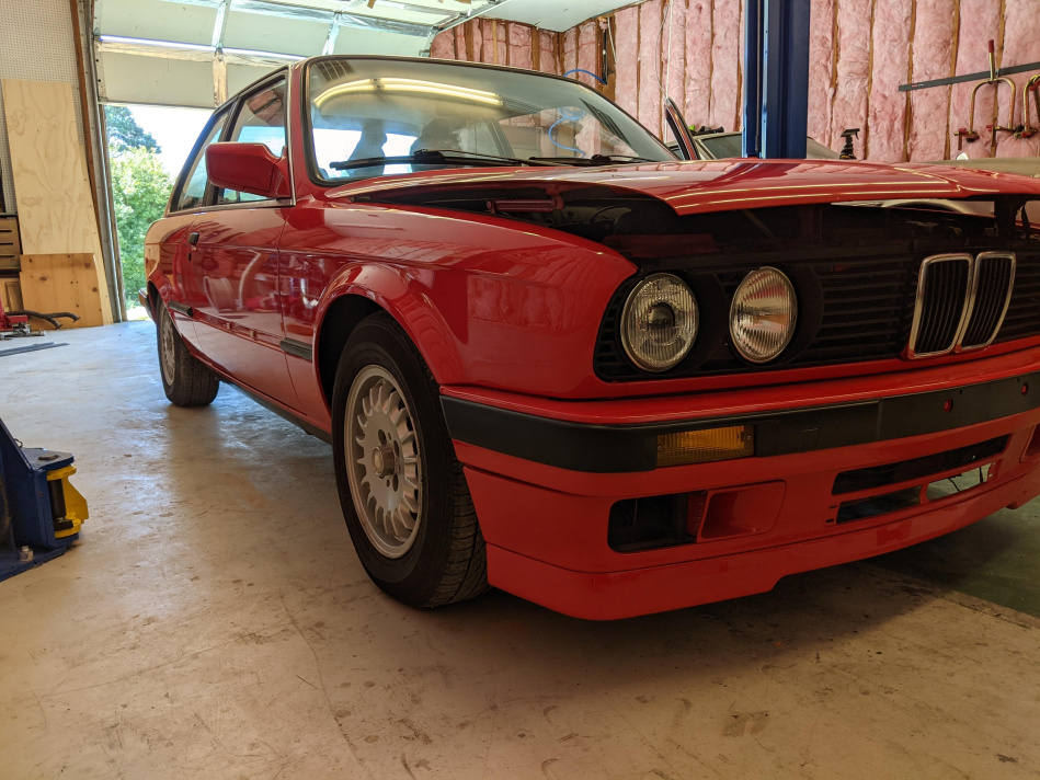

              With the new headlights and fog light lenses the front of the car was now looking much better.

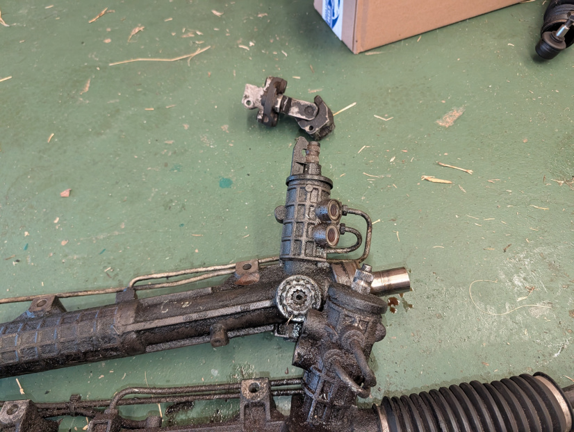

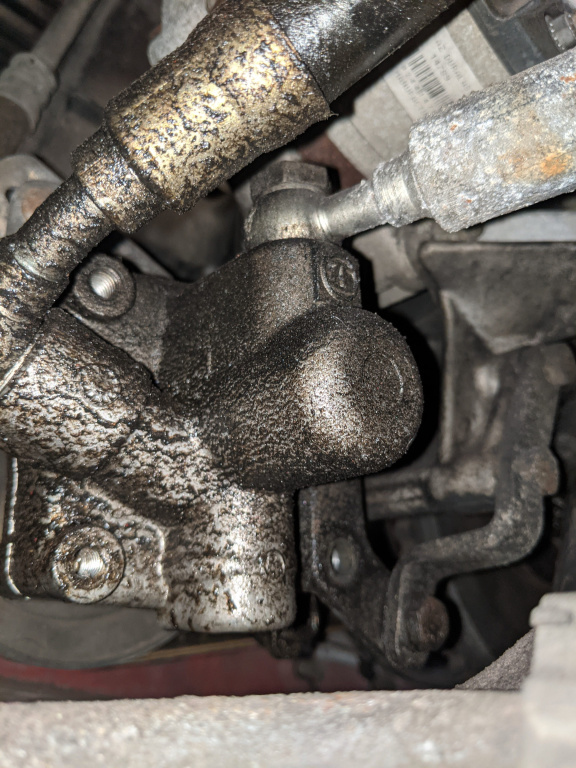

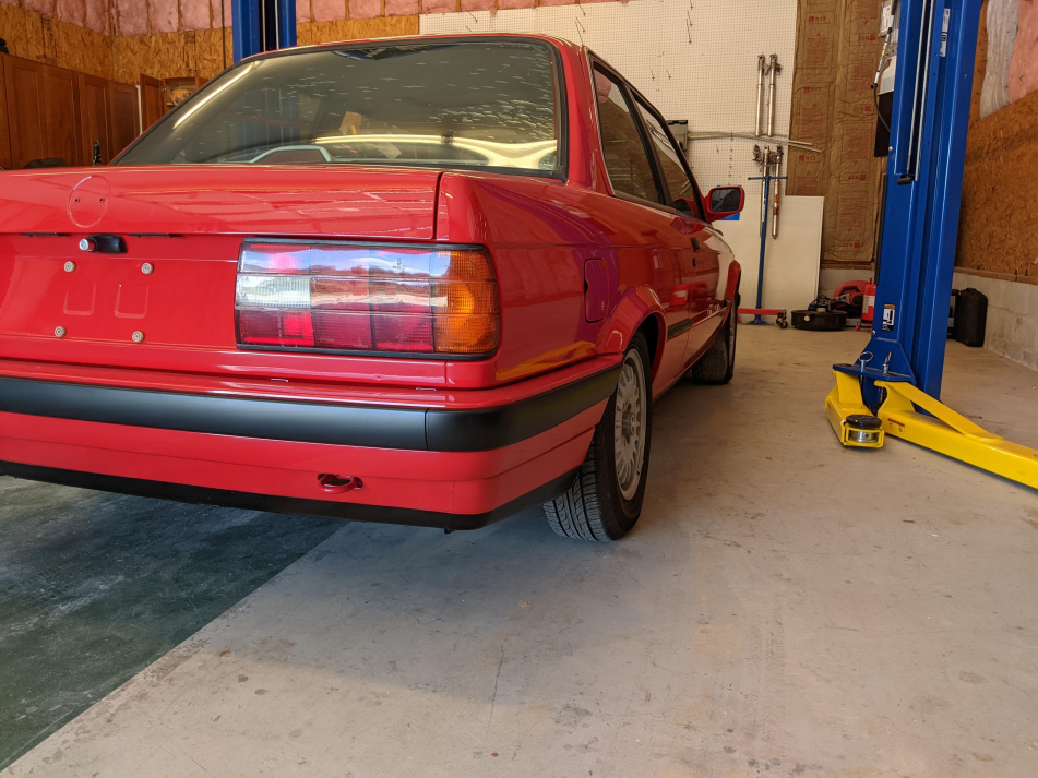

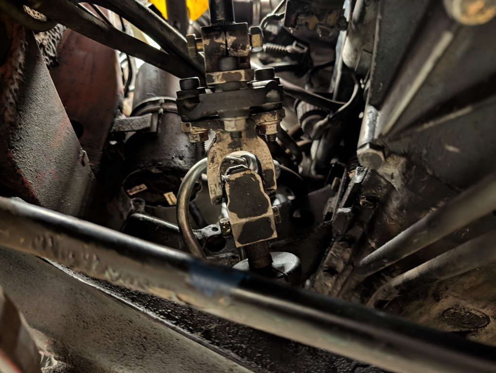

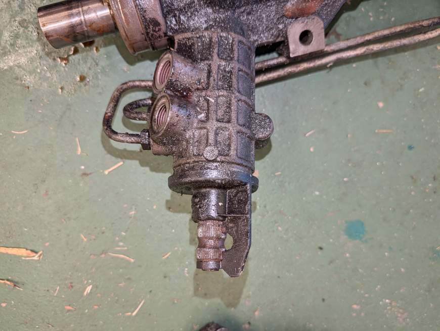

                One of the things that always bothered me about the e30 was the slow steering, combine that with leaking hoses causing noise in the morning and a worn steering guibo and it was time for some work.
                i'm hoping the pump is ok, it looks like rebuild kits are still available from the dealer but most quality aftermarket pumps have been discontinued.

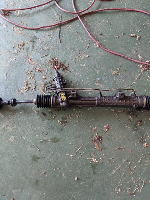

                I also picked up a gold label e46 rack from my local LKQ, I swapped to this rack in my e36 m3 and have been happy with it in that car so I think it should be a good upgrade for the E30.

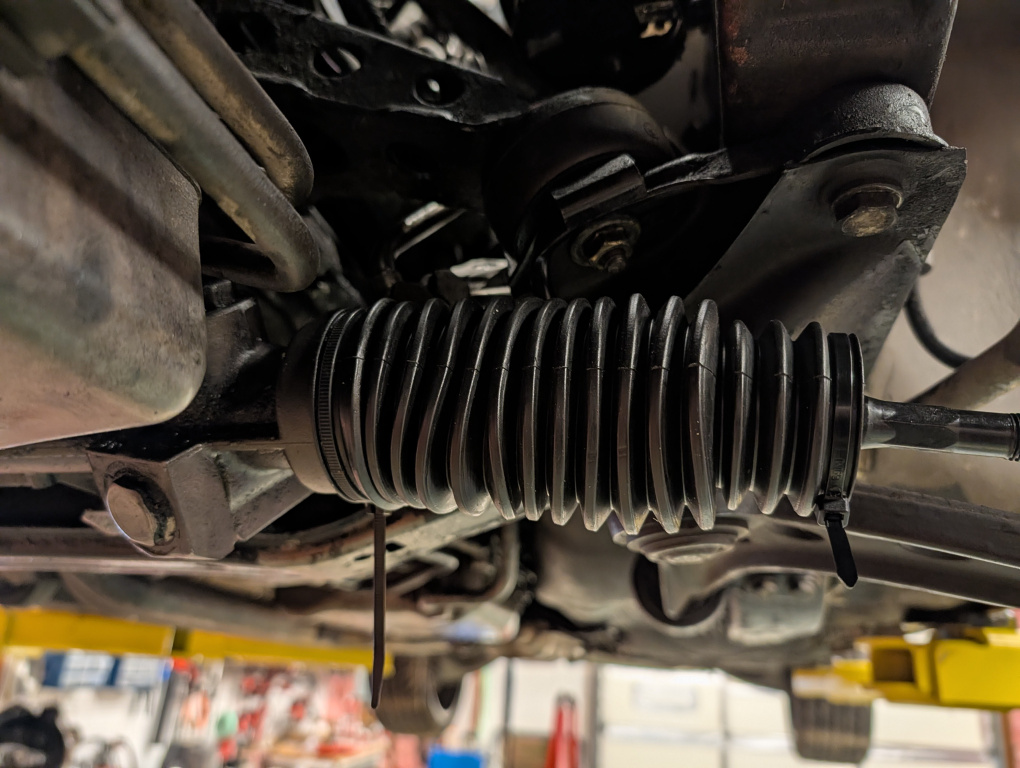

                The rear CV boots were also splitting so replacement boots were installed before the joints became worn.

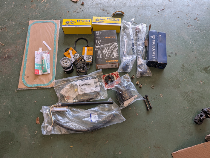

                  So a pile of parts showed up for spring maintenance and the steering rack swap. The vintage is coming up in less than a month and after taking the e36 m3 last year, the plan is to take the e30 again this year.

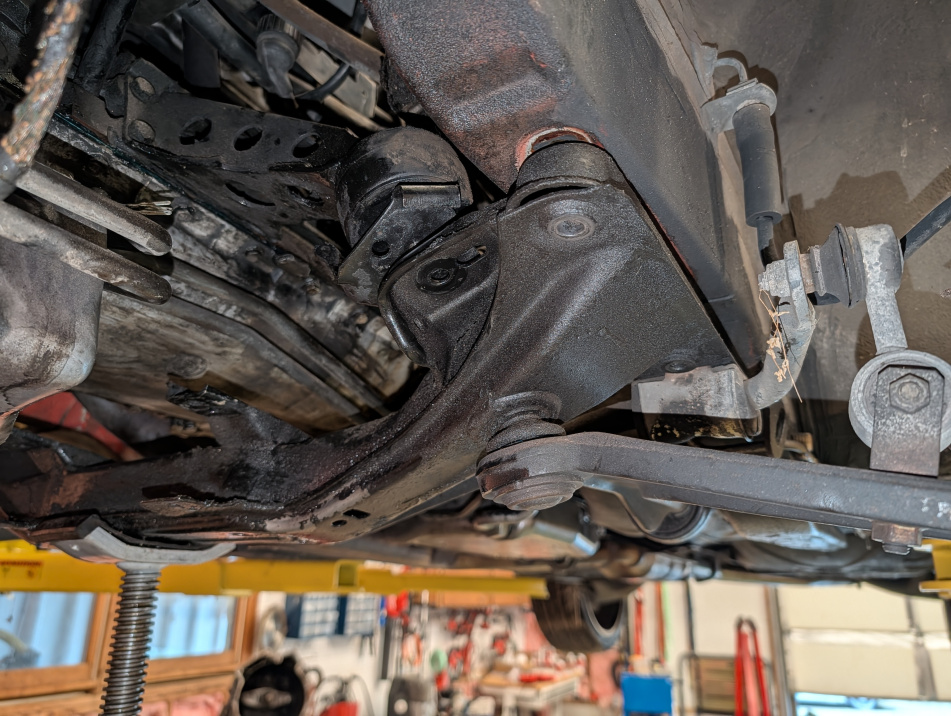

                  I know many suggesting just bending the tabs on the subframe to remove the rack, but my oil pan gasket is leaking as well. So out came the engine support.
                  I still ended up lowering the subframe some to get the pan out. I maybe could have pulled the fan and got a little more lift, but I am not sure how much stress I wanted to put on the hoses.

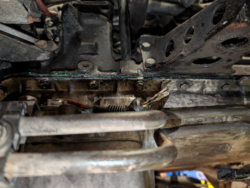

                  Of course the oil level sensor plug fell apart when unplugging it, so there is something else for the todo list.

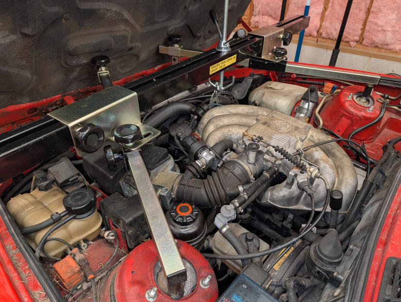

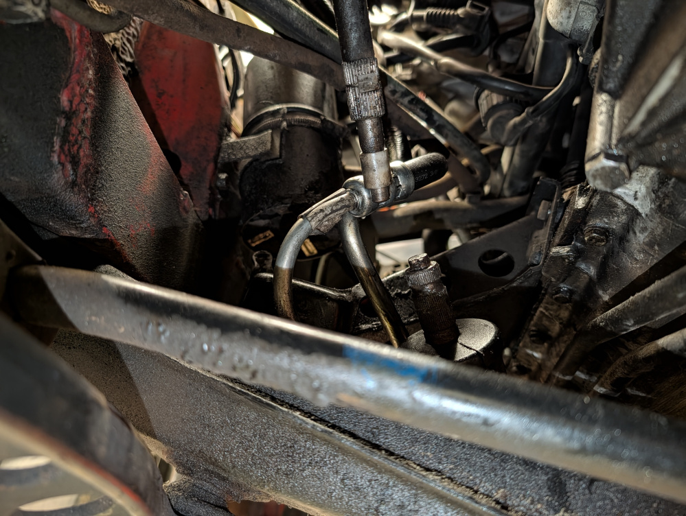

                    The rack came out fairly easily with the engine lifted. I know this is a common upgrade but I was not able to find alot of information on swapping an airbag car. With the racks side by side, some of the differences are visibly obvious.
                    The lines come in on the opposite side of the rack and there are some angle differences between the two. I also did some measurement comparisons between the two racks.

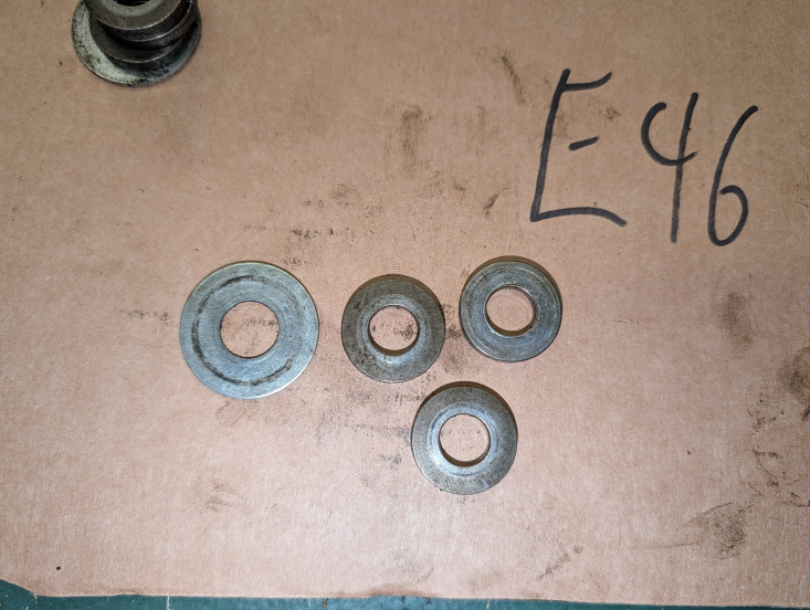

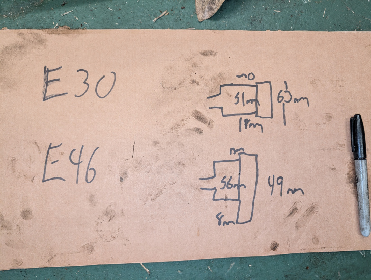

                    There are multiple companies making spacers to make up the 14mm difference in the mounts. I elected to use what I had on hand to give some up and down adjustment if needed. 3 cylinder head washers and a thin washer was the correct height. For now I put them all on top.

                    The cap on the top of the E46 rack also had to be swapped for the one from the E30 as the steering joint would not fit over the alignment tab on the E46 rack.

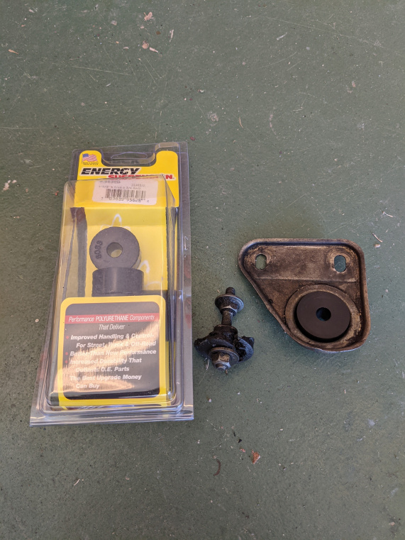

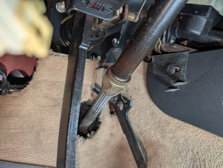

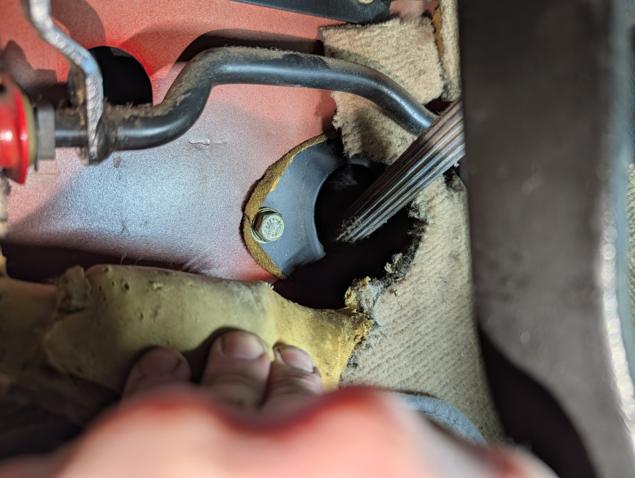

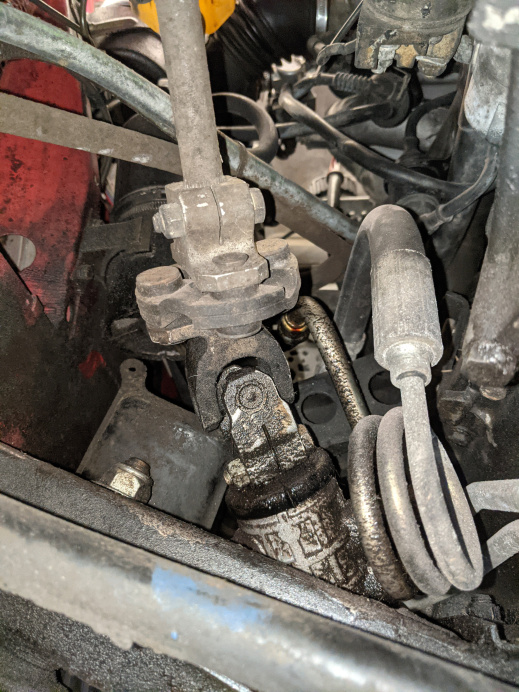

                      The next part of the rack installation is performed under the dash. First the nut holding the steering shaft is loosened and then the shaft removed.
                      Next the carpet can be pulled back slightly to access the plate on the firewall

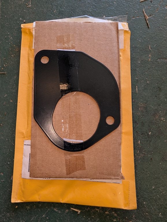

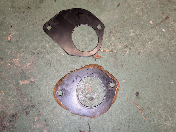

                      Comparing the factory plate to the one for the E46 rack you can see how the hole is repositioned.
                      I used camper shell insulation tape to mimic the factory seal.

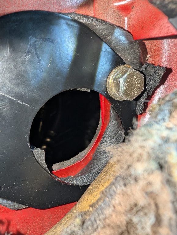

                      The plate can then be installed as a guide to how much material needs to be ground from the body.

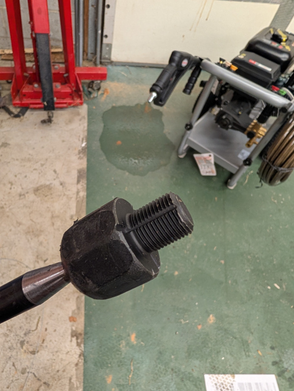

                          Next the rack came from a junkyard so the tie rods were not in the best shape. E46 racks vent through the inner tie rods to E46 inner tie rods had to be used.
                          Unfortunately E46 outer tie rods have too large of a balljoint to work with an E30 so E36 outers had to be used. I also put new rack boots on, Moog used to be one of my goto suppliers. Their quality has been going downhill lately and these rack boots were no exception. The rubber was stiff making installation difficult and the supplied clamps were to large to be used. I ended up using zip ties for now.

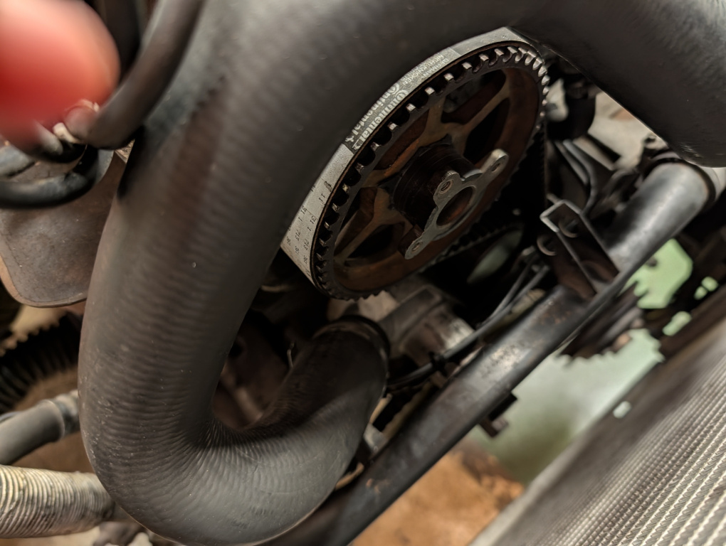

                          Next up the timing belt was due for replacement by age. I replaced the 3 drive belts while I had them off as well.

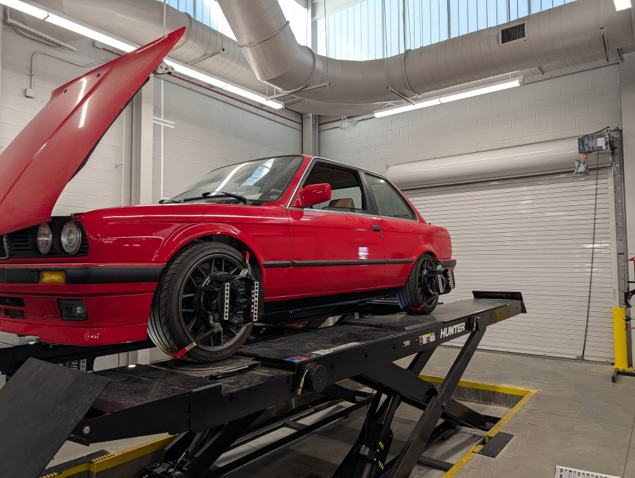

                          Finally an alignment was performed to get the front end in spec. My rear is a little out and the trailing arm bushings have some cracking so rear suspension is probably next on the list. Does any one have recommendations for adjustable rear suspension?
                          I'm happy to report the improvement in steering is dramatic, much quicker and better road feel as well.
