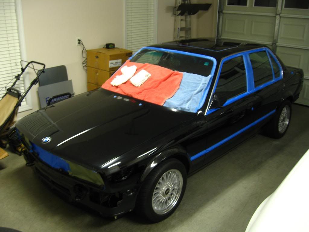

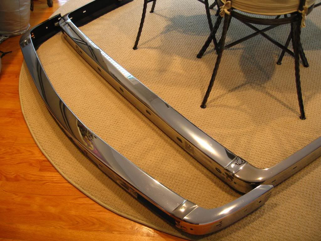

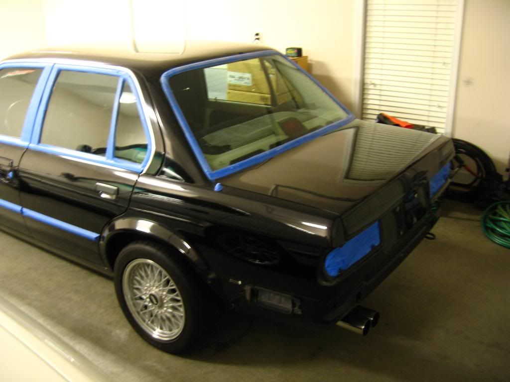

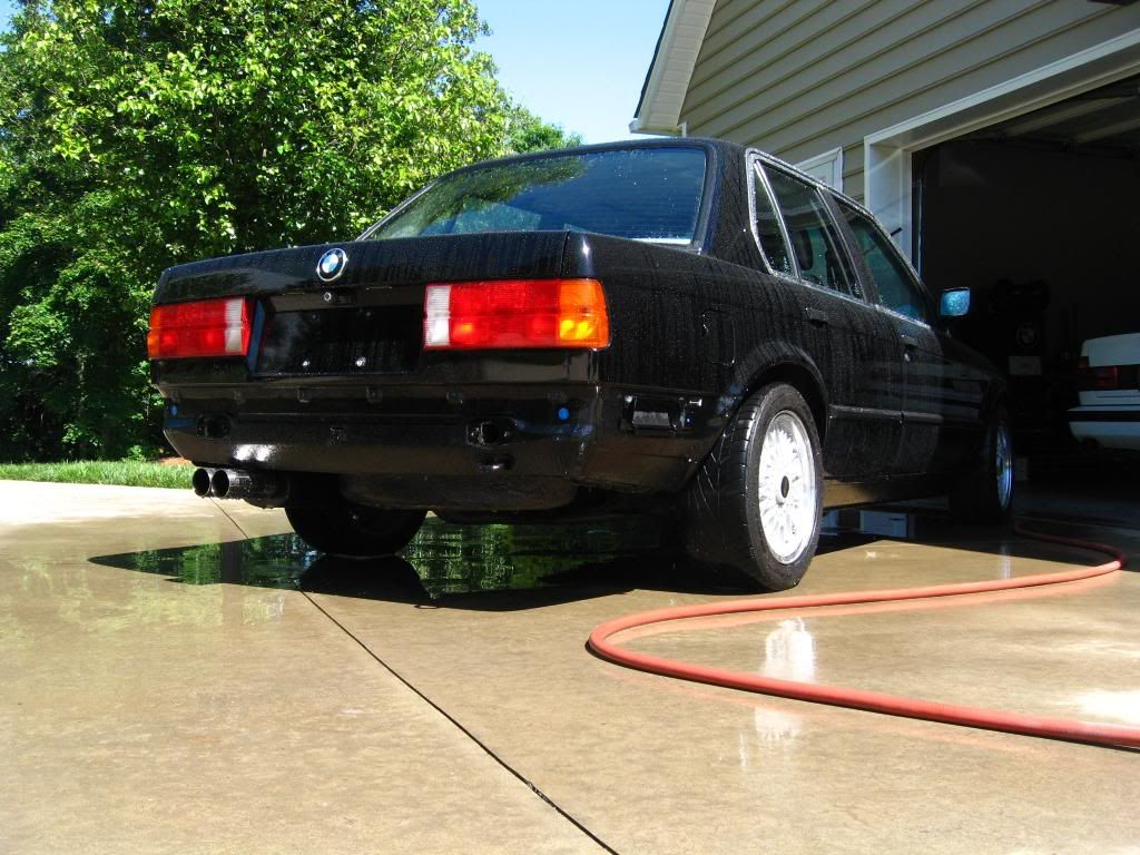

    The story starts about two weeks ago when I was preparing my car for a vintage BMW gathering that was set to take place on 23 May. I was tackling a few maintenance items (reman'd brake booster, new E32 750i master cylinder, and new Hankook Ventus R-S2 tires) as a result of months of DD neglection; but the main new addition was the set of freshly refinished euro bumpers.
    The removal of the US bumpers/shocks couldn't have been easier and (much to my relief) there was no surprise rust hiding under the bumpers or bumper shrouds. Once the US parts were off, my brother and I went about detailing the car (buffing, waxing, polishing, etc.) and I detailed the engine bay and the AFM in preparation for the event. After this, the car got some much needed scrub time. I must say, the car looked badass sans bumpers.

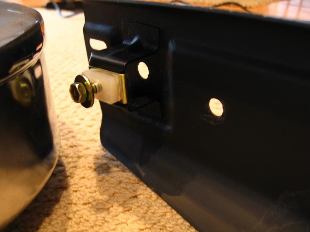

    After all of the details were sorted out (and POR 15 spot treatment was applied) the mounting of the euros began. Again, this was a very easy process as well. The fresh, new, cadmium-coated hardware was a huge plus and was all in the hardware kit that BMW had available. It made the process much easier since I didn't have to order each individual part, I actually ended up with some extra hardware after the install.

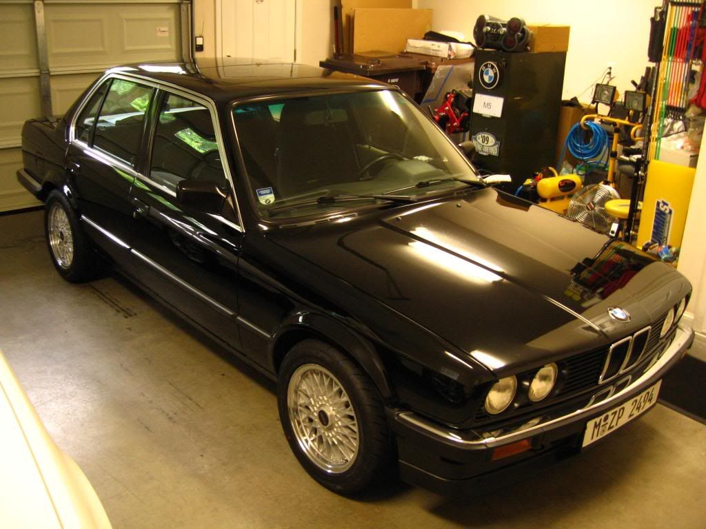

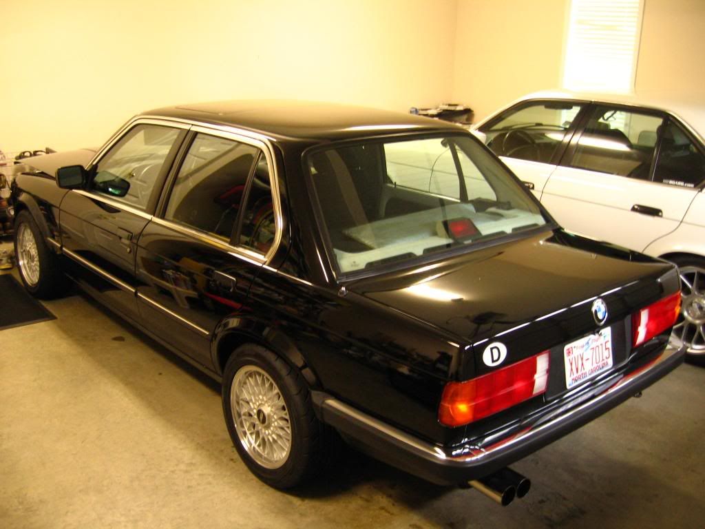

    By 3:00 AM on the day of the event, everything was on the car and I got it exactly where I wanted it to be. It looked like a conservatively modified euro E30, exactly what I was going for all along. The next step is sourcing a minty euro valence and getting it resprayed, getting some new foglamps, and eventually a set of IE3's.

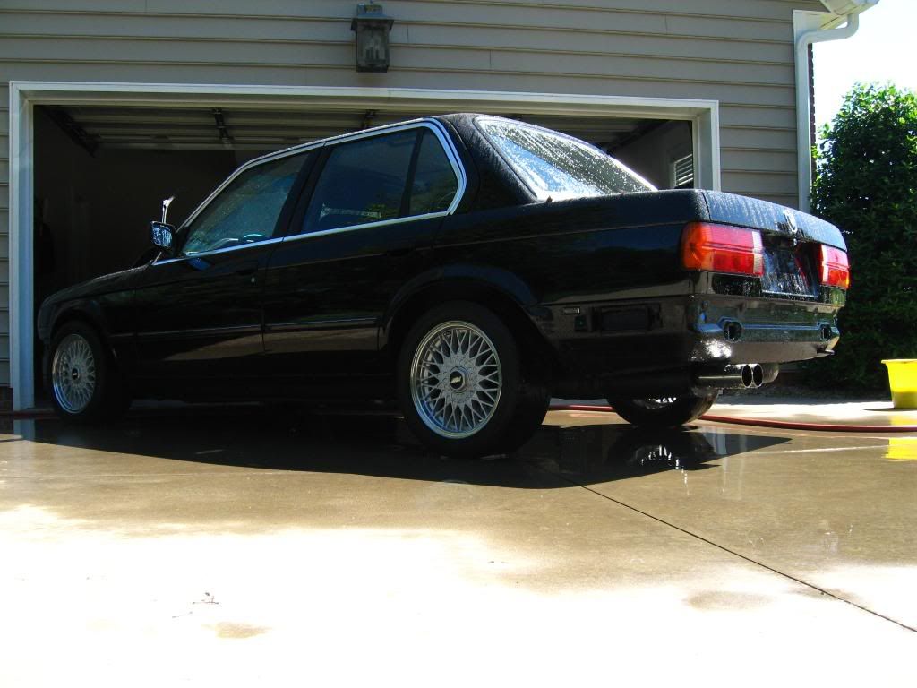

        looks good.
        exhaust sticks out abouuuut 2" to far for my taste, but.

            Originally posted by smonkbmw
            looks good.
            Yeah, despite what the pictures may depict, the exhaust is actually even with the rear bumper. Still though, I plan on picking up another muffler soon, something completely black with a slant tip.

                Thanks man. As far as exhaust goes, yours looks fine. I'm running supersprint (bought it 1 week after I got my car really really expensive....I was young and stupid) and I think it looks great w/ the slant tips. Not the best shot but you get the idea

                  Looks good. What did you do for the extra holes in the rear?

                    Nice! Your car looks like mine... well mine will look like yours in a few days.. but how was installing the rear? In scabzzz DIY thread he says there are those two holes inside the trunk and you drill into them, I can't find those on my car. Did you?

                        Originally posted by kronus
                        About time :p
                        I'll post the shots of what I did for the shroud holes and the other holes in Scabzzzz's thread. I highly recommend stocking up on rubber washers when doing this swap though. I had countless times where I noticed hardware that was sitting right on the body, and it's really only a matter of time before moisture gets between the two metal surfaces and creates rust.
                        ^ From the DiY thread. Remove the middle carpet panel (between the taillamps) to reveal these expoxied holes. Looking from the exterior of the car, you will drill the leftmost hole on each side. I hammered a light indention on the interior to see where I needed to drill, you really don't want to botch this up. One of the posts on the rear bracket will go through this hole you just drilled, and the other will use one of the holes used for the old bumper shock. Hope that helps.

                            hey also by curiosity what did you coat the inside of your bumper with so it won't rust?
