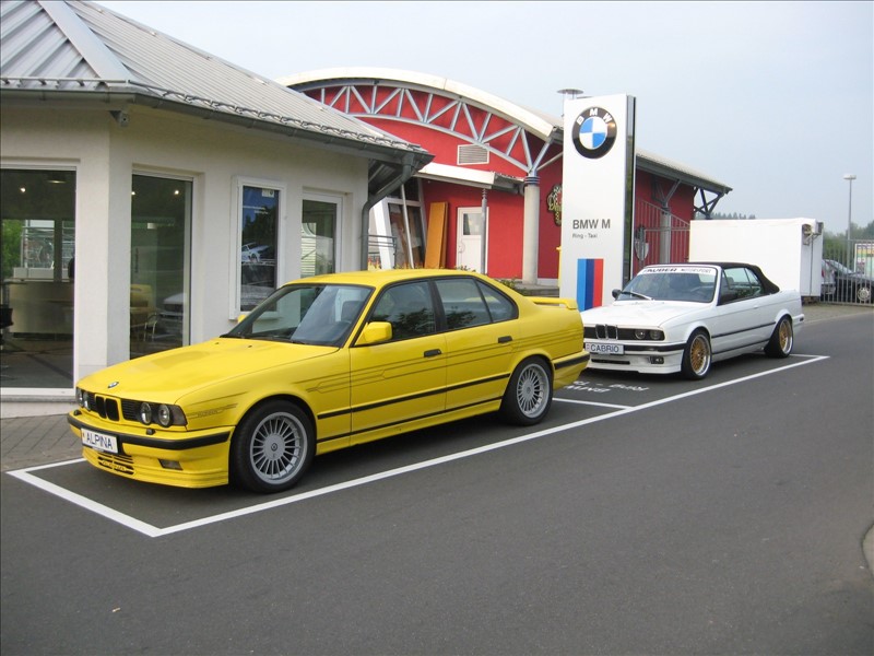

                    Alpina: I think I saw your car the on Nürburgring the first weekend in May. Some of my friends and I went down to look at Tourenwagen Revival and VLN. Great place! Makes me want to live in Adenau!

                            Ja vi var nede på Ringen den förste weekend i Maj,,
                            pisseflott ,, og rigtig go stæmning
                            Sabine og Andy Prilaux var syge ,, så jeg var nöd til ad hjælpe

                              Alpina: It looked familiar :) A friend of mine have the same engine in his E30 so we had to look it over when you left it with the hood open. Quiet an engine to put in a cab :)
                              Is the yellow color the original color of you Bi-Turbo? Cool cars!
