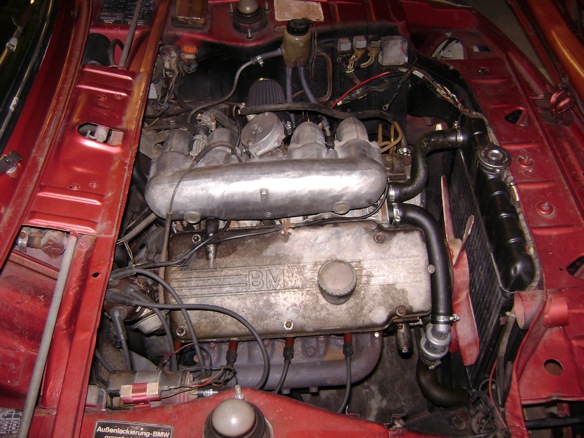

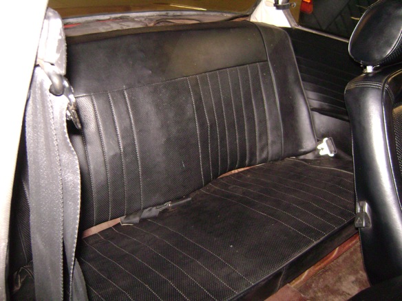

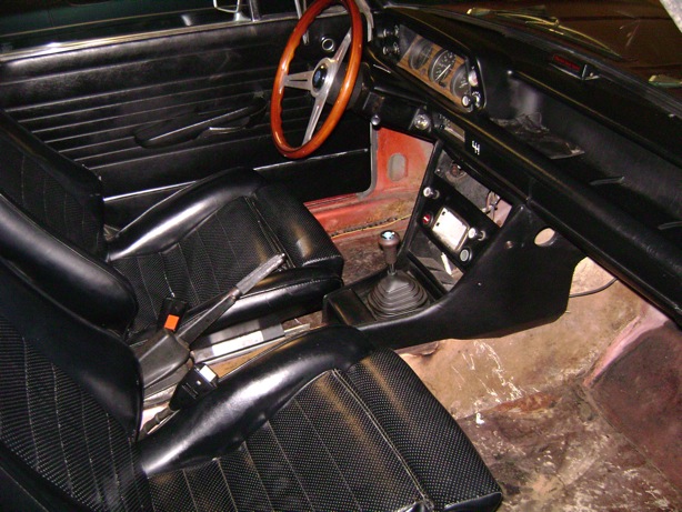

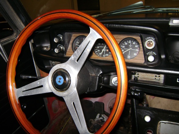

          Well here are a few more pictures, some of the interior and underhood. Not great pics, but you know, gets the job done. Another interesting fact about my car. Since the car still has a Mississippi title when I went to register the car, I had to have an officer come out and run a VIN verification on the vehicle. After chatting with me about the car for about ten minutes he went back to his cruiser, ran the numbers, and when he came back, he told me that the car had not been registered for the road since 1977. 0.o

                  Nice Nardi wheel. BTW that's a BEHR AC console that's been stripped down. Has the car been repainted all over? The overspray in the engine bay is a bummer.
                    Yeah, I know aout the A/C, I pulled that out my self, as most of it was junk. That's one of the many things on my to-do list over the summer. I'm gonna get a compressor mount off an old rusting away Bavaria we have that should fit and then put a rotary compressor on it. Yeah, I think the whole car was repainted, not sure why but whatever. And yes, the engine bay makes me very sad. I would love to get the car repainted and spray the bay body color, but still debating spending that much money.
