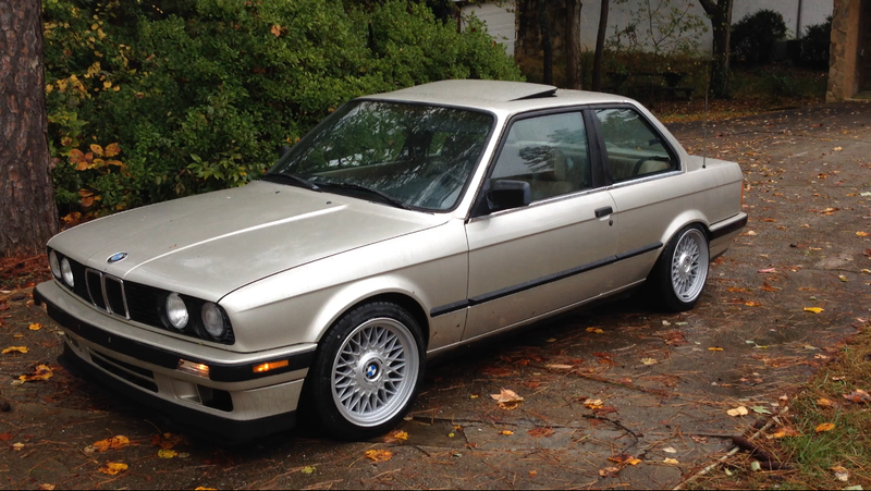

    I also don't want to strectch. But i did want to use 205/55/16s because that tire, given its popularity, is much cheaper than the others. I'll probably stay in the 8" wheel.
    I was also wondering if the 16", 55 wall tire would fit?... I will be using vogtlands, which give a 4cm/1,57inch drop
      That's a pretty tall sidewall. It'll more than likely fit, but I don't think it'll look particularly as attractive as something smaller. But that's just opinion.

        Yeah i know it won't look as good but the price difference on the tires... is pretty appealing
          Autostrada Modena 16x9 +6 16x10 +11 with 215/40 and 225/40 Falkens
