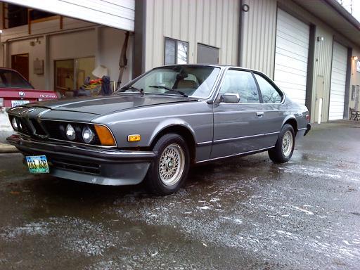

              I did a quick wash today and a little interior cleanup, here's how it turned out.
              and I originally thought this had a US engine but then i heard some 81 gray market 635csi had motronic m90s. this car has a 12/80 build date. motronic intake manifold. 3,5 stamped on the block along with 5581094 (the vin) and 35 6E C. it has a 1980 casting on the head. shed some m90 light?

                You have the good Euro motor. The previous generation had L-Jetronic and 6 elbows.
                Ca is worth saving.

                  Bingo. Some of the late E12 based euro 635csi and early euro 735i (around 81) used the M90/L-Block motors combined with a very early Motronic ECU (1.0 basic IIRC).
                  One way to tell would be to check on intake side of the block, there should be a white "L" stamped there. Another way would be to check the last 3 digits of the ECU, which should be 002.

                      Great news! where abouts is the "L" though, i looked over the engine pretty hard yesterday pulling numbers and such. does it favor the front or rear of the engine? Today i am going to go look for another nose panel and throw some different wheels on it to get an idea of what she could become.

                          Should be a little to the right side, between the alternator and the starter or thereabouts. I can check later on my E28 if you want.
                          The cool thing about the L-Block/M90s are they are true 3.5 motors (3453cc) instead of the B34/B35 engines which are 3.4 (3430cc), as well as being a related closely with the M49 and M88 race engines.

                            Correct. I believe euro engines which used ECUs ending in 002, 011 and 061 where Motronic 1.0 Basic which did not utilize and O2 sensor like the Motronic 1.0 Adaptive found in the US 535i/635csi/735i 059 ECUs. The exception I believe is the 008 ECU used in the 83-84 US 533i/633csi which was Motronic 1.0, but used a single wire O2 sensor.

                                Concidering the exterior and interior 'after' pictures, KEEP IT. Needs some work in the engine bay though...
