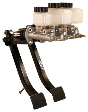

                    Any reason y'all went with the Hydroboost over say a Tilton setup???

                          There's not a lot of room up under the dash for the Tilton pedals and cylinders. We thought that power brakes are also a must in a very quick and fast street car. On top of that, all pedal forces are reacted out in the driver's seat back (and we all know how flimsy the BMW seats are).
                          Our trade-off study results were:
                          About the same or less work for the HB brakes
                          About the same cost
                          Power brakes
                          Much better cool factor with the hood open
                          Working under the dash sucks (ever change the clutch master cylinder??)
                          The challenge of working it out
