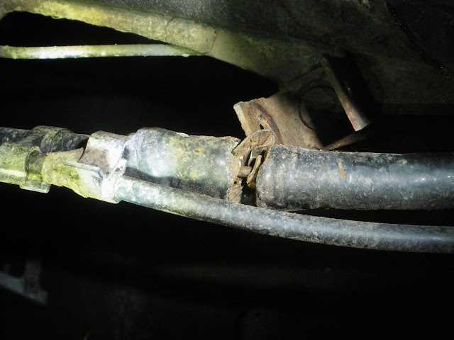

          And did you notice the piece jutting into the pic from below? That's the e-brake cable! Completely severed. And the other side is holding on by a thread...
          So more $ and time. It shouldn't be too hard, though. And the disk backing plates seem fine, so that's good. I think I'll be putting some of these projects on hold, though, as I'm shifting focus...

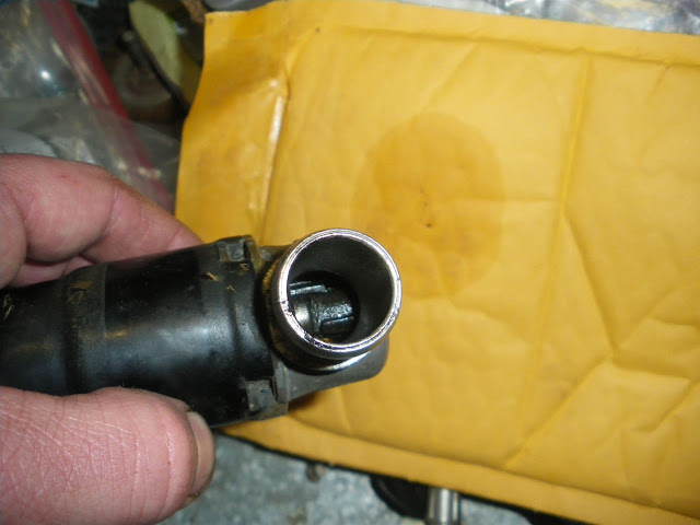

          Then the other day it wouldn't start in the grocery parking lot... It started but quickly died out. Then would crank and try to fire, but wouldn't. I tried everything I could think of w/o tools, but towed it home and put in new plugs the next morning. After plugs, it fired right up but had a massive wandering idle from 1k to 2,500 rpm constant. Pulled it in the garage and changed the fuel filter (and a hose), cleaned the AFM, and cleaned the isv...
          After priming the fuel line due to the filter replacement, it fired right up and ran well! No wandering idle, no stalling... back to normal. Also, the coil and AFM checked out ok w/ the multimeter.
