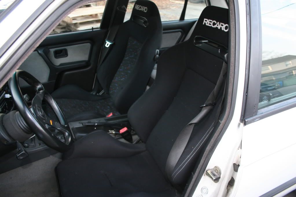

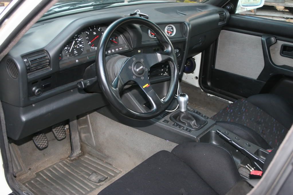

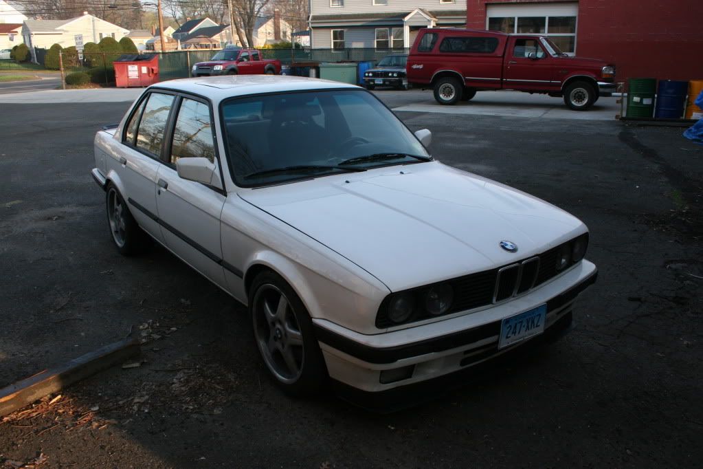

    Quick pics before the first driving event
    of the season, coming up on Friday. Added a bunch of random stuff to my M50TU swap car.
    - RD chip
    - Oil pressure & oil temp gauges
    - Recaro SPD Driver & SRD Passenger
    - Sound deadening removed
    - Spal 14" Pusher through stock AC wiring w/ 80/88deg rad switch
    - Brake Backing plates w/ BW brake ducts (brake ducts not installed yet)
    - BW Shim Kit w/ .250 total shims added (will be adding camber plates later)
    - Borbet 17x8 type E et41 shod w/ 235/40-17 Bridgestone RE01R tires
    - Hawk HP+ Pads all around (might switch to HT10s in the rear to compensate for the E36 M3/ 318ti bias or add an adjustable valve)
    - BW Silicone Intake Boot
    - newly rebuilt diffsonline 3.46LSD w/ 40% lockup
    - Single 2.5" exhaust from headers back using Borla XR-1 Muffler in the middle & Vibrant in the rear (no cats)
    - Power steering delete
    - is front lip w/ ryan g splitter
    With just the exhaust and 3.46LSD the car is completely transformed and actually feels somewhat responsive than with the 3.07LSD and modded 325i midsection. I have S50 cams and a VSR Bolt in Roll cage that needs fixin' that I may install in the next few months, but so far I'm just enjoying the car as is. And yes I know the front needs to come down a bit. ;)

    good stuff man.
    i havent seen those door panels before, custom?
    Strategic Alpine Command:...sig loading
    • BenM
      • Nov 2006
      • 2184
      Thanks. Nope they are actually base model cloth 318i door panels.

            lower that bitch some more
            • FredK
              • 14763
              Word.
              reciprocal of Ride Height = Handling.
              Expressed mathematically,
              1/RH = H
              and
              lim RH = infinity
              RH--> 0
              Expressed in modern parlance, Leaux = Fazt

                      I love your passenger seat. I now want to buy one.

                          Nice...........love the seats!
