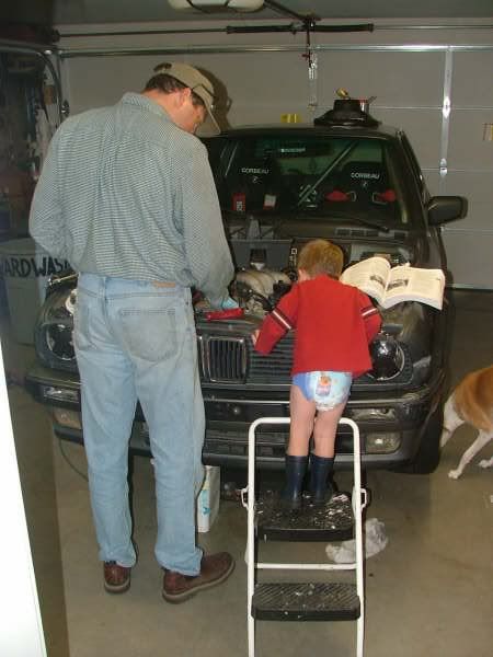

                      That note was written by my (then) 6-year old boy, Joe. He's a great crew buddy in the garage and can work an air gun like a pro! He knows more about tools and cars now than many adults.
                      He wrote it for me in Spokane, July 2009. I came back to the hotel room that evening and found it. It's been in the car since, and is my favorite after-market piece in the car.
                      Here's a shot of the first timing belt job on the Reaper, before it was the Reaper. Joe was of course supervising in OSHA-approved footwear:

                            Very Nice! The pic with your son is cool too
