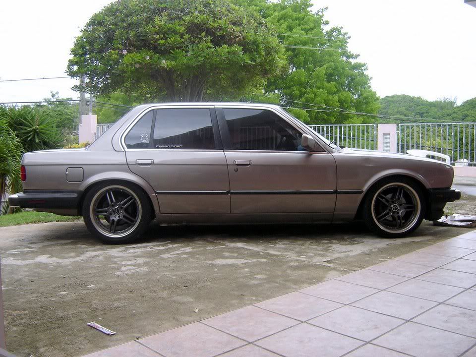

      I like'em too... but the roads in PR are a little abusive with slammed cars. So I bought 17's to raise the car a little and stop crying everytime I pass 6 speedbumps just to get to my house

        Listen, cause you guys need to get this right... 17's do NOT raise your car up at all, unless you're running oversized tires.
        What size were your previous wheels AND tires and what size are your 17s AND tires.
        Stock 14 inch tire size was 195/65R14. What size are you running with your 17s? If you want to be super technical, a 215/40R17 (what most people run) is actually a little smaller diameter than stock. The overall diameter is 0.2 inches smaller, which actually lowers your car 0.1 inche, which doesn't matter. A 205/45R17 is ever-so-slightly larger than the original 14 inch size. Overal diameter is 0.3 inch larger.
        What I'm saying is that both those two 17 inch sizes are more or less exactly the same as stock and will not noticeably raise or lower your car.
        So yea, what size are you running?

          well, the car feels higher, because I don't scratch that much on speedbumps, I'm runninr 205/40 in front and 225/45 in rear... I've felt a difference in height when passing over speedbumps

              With your current front tires, ya those are SMALLER than OEM size but the rears would be a bit bigger

                Your front tire is undersized, so the very front of your car is actually lower to the ground now. However the rear of your car is oversized, so it is raised up a little. I would really recommend getting some tires that match. Your rear tires are wider AND the sidewall is larger while the fronts are narrower AND the sidewall is smaller. If you're dying to run staggered widths, you'll be better off with 205/45 front and 215/40 rear.
