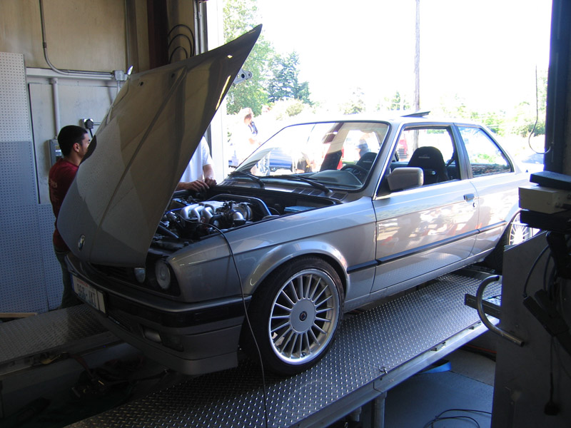

    Well, today I went to the dyno day here in Olympia, WA, it had quite a turnout, mostly imports, a few American muscle... Anyway, strapped my car on for $35 which is really cheap, and got a couple runs.
    The first run I had wheelspin. They had to strap it down a little more after that, sounds cool though heh.

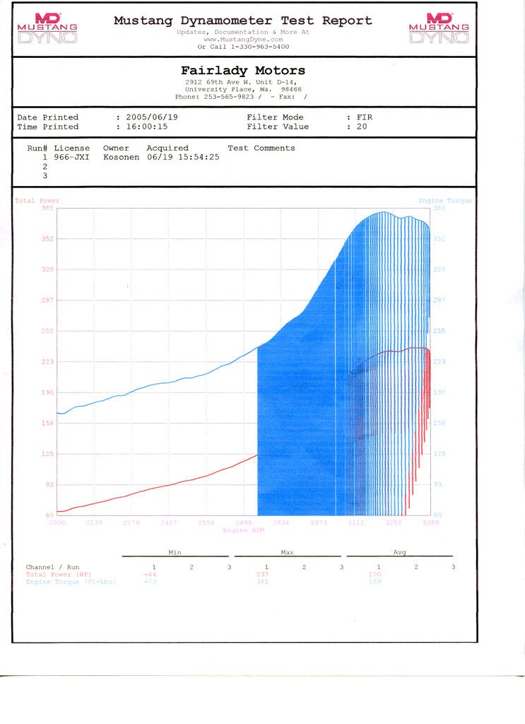

    The second run, I got a good run, but I think my clutch is slipping, and only recorded power for 3400rpm (on the sheet, my MS datalog recorded to 4krpm), which could be why you see the blue lines, because it retraced over itself. Anyway, it was a good run!
    RESULTS AT 3400RPM @ 17.6psi (1.22 bar) (due to injector duty cycle being around 100%)
    237WHP -> 285bhp
    381WTQ -> 459tq
    VIDEO
    Problems: Found out my rear sway bar end link is broken. My clutch is also slipping, so I'm planning on the IE disk coupled with the centerforce pressure plate (should be strong enough.. heh).
    Also getting my 83lb/hr injectors this week.
    matt
