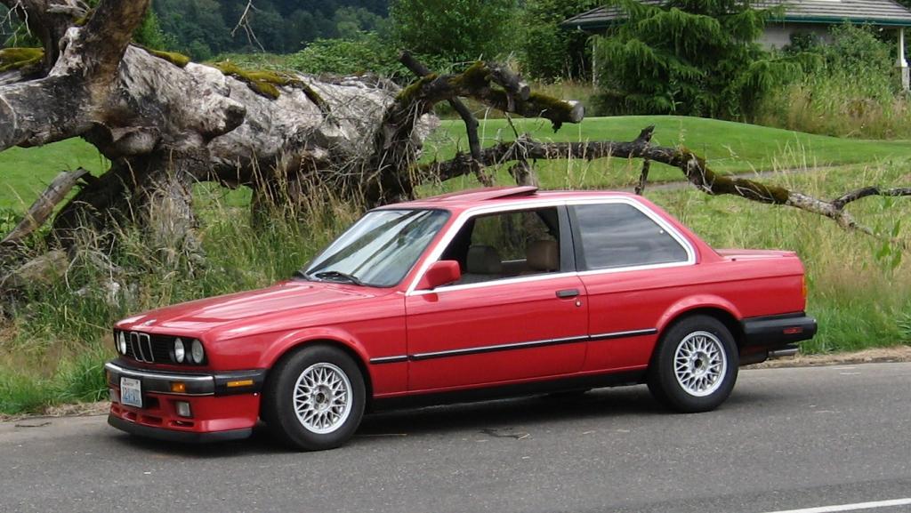

    That's done let's move to the paint: ox-i-dized. No problem I have some cutting compound. Still have some black adhesive on the front lip.
    We're getting there but what's up with the crappy black paint on the weaves?
    Better
    Front lip needs work,
    Awe..Yeah!!!

            what the FUCK man. How did you paint that front valence yourself? It fucking looks awesome. Teach me. And teach me how to polish paint like that as well.
            • Farwest92
              • Jul 2011
              • 192
              I sanded it and then sanded again. Sprayed with brown primer and sanded again. Used Dupli-color Flame red to match the Zinnoberrot
              and then some Dupli-color clear. I am still pleased with the result.

                    I took the lower lip off of a mazda, I don't recall the model I was just looking for something to increase the low. I attach it with small sheet metal screws so as to act as a sacrificial lip. I paid five bucks at the yard so if I drug it off who cares.I had to cut it and glue the middle but I mounted it first and then glued it because it's pretty flimsy. But I think it looks good. It drags but I know where to find another.

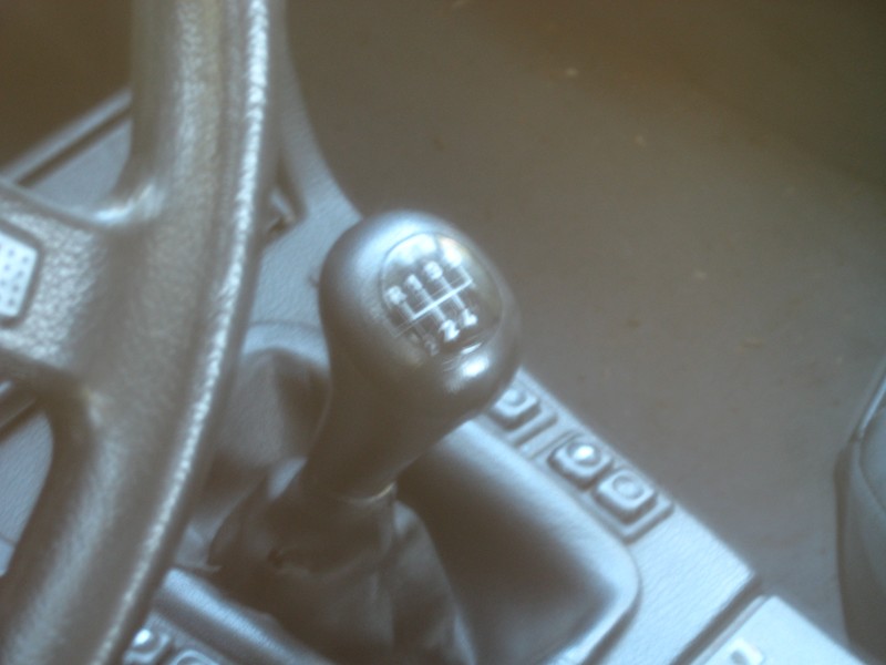

                            Next is the 5 speed swap. look what I found for $600
