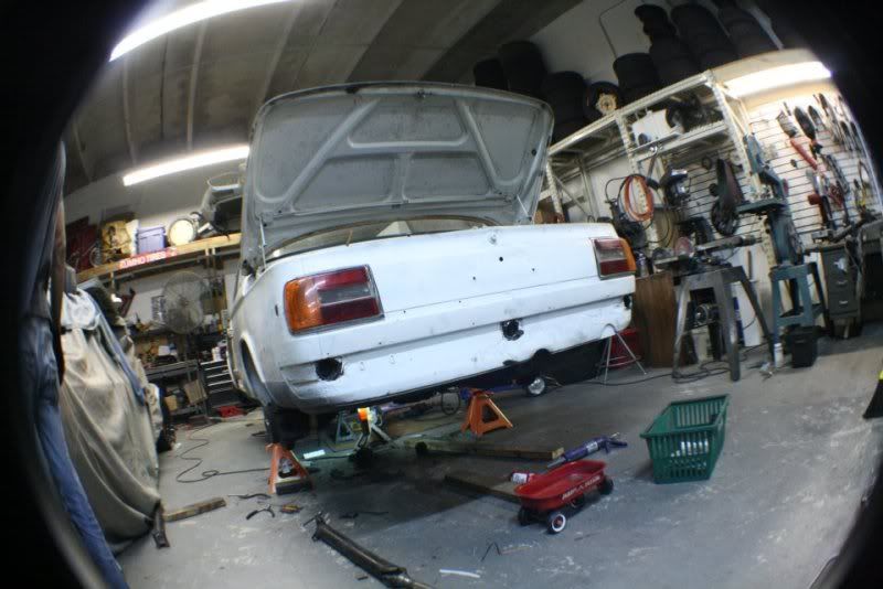

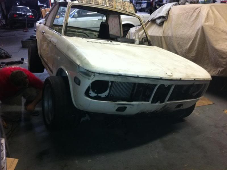

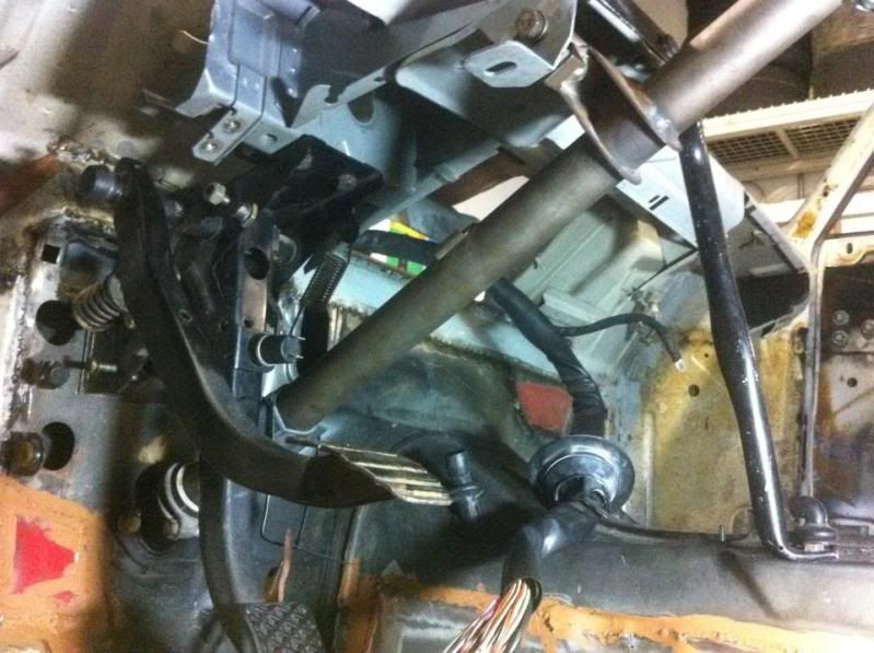

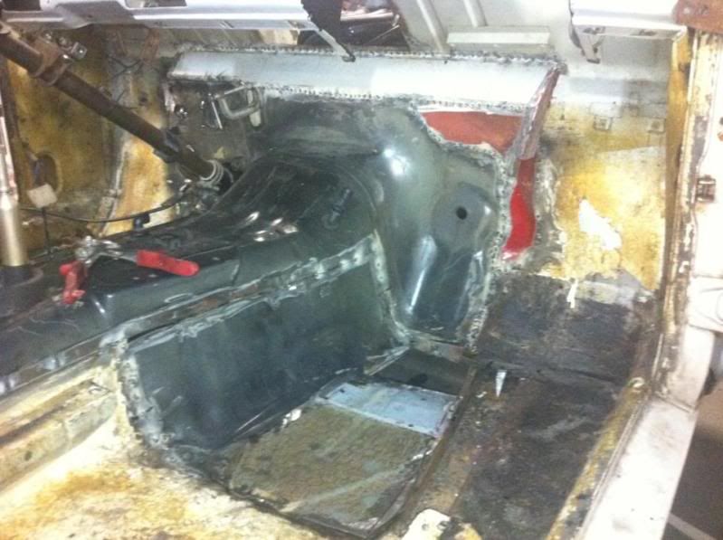

    Ok ok. For those that havent viewed the blog, heres a small collection of pics from the project.

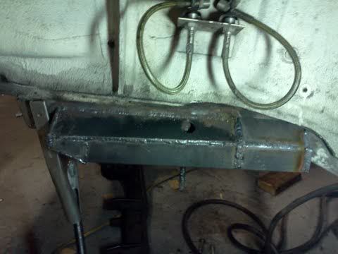

    02 frame rail extension

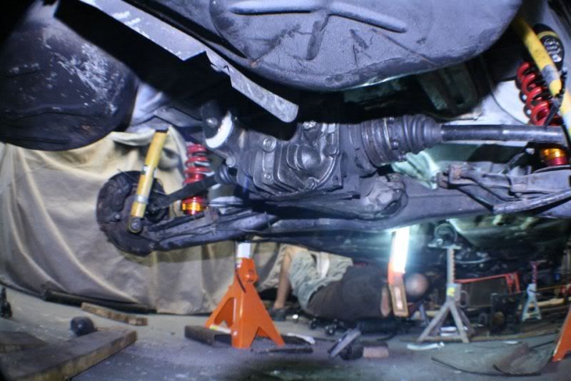

    e30 rear subframe
    e30 booster
    e30 trans tunnel
    e30 lower control arms

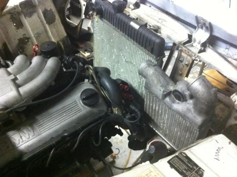

    IC and radiator mock-up
    e30 steering column, and pedal assembly

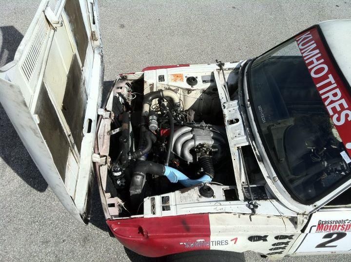

      birds eye engine shot

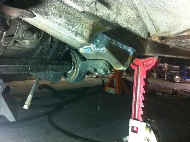

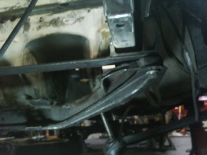

                Hello! Would you be able to get a few detail shots of the rear subframe mounting area? I'm curious to see how much it changes from the stock '02 one...
                  Instead of modifying the car to fit the subframe, we modified the subframe to fit the original 02 mounting points.Solid mounted, and boxed in. The e30 trailing arms attached didnt compromise the e30 track width, and we still used the factory 02 subframe reinforcment mounting points which was pretty cool. By doing it this way it also narrowed the track width an inch or so.
                  So the following week we went back to work. The first plan was to mount an e30 rear subframe. We discussed this thoroughly between the three...
