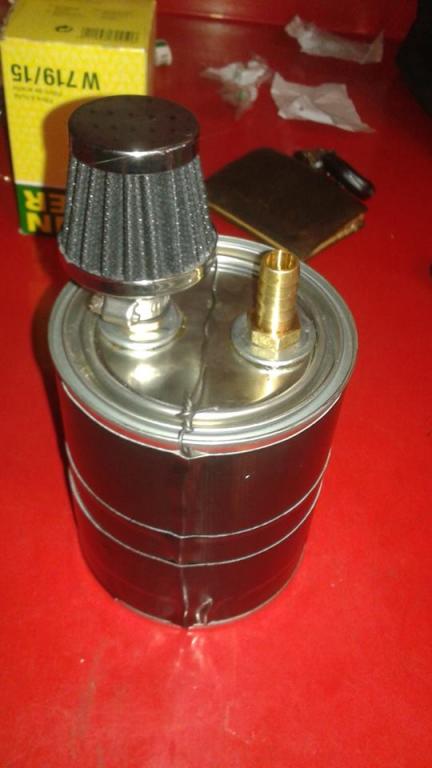

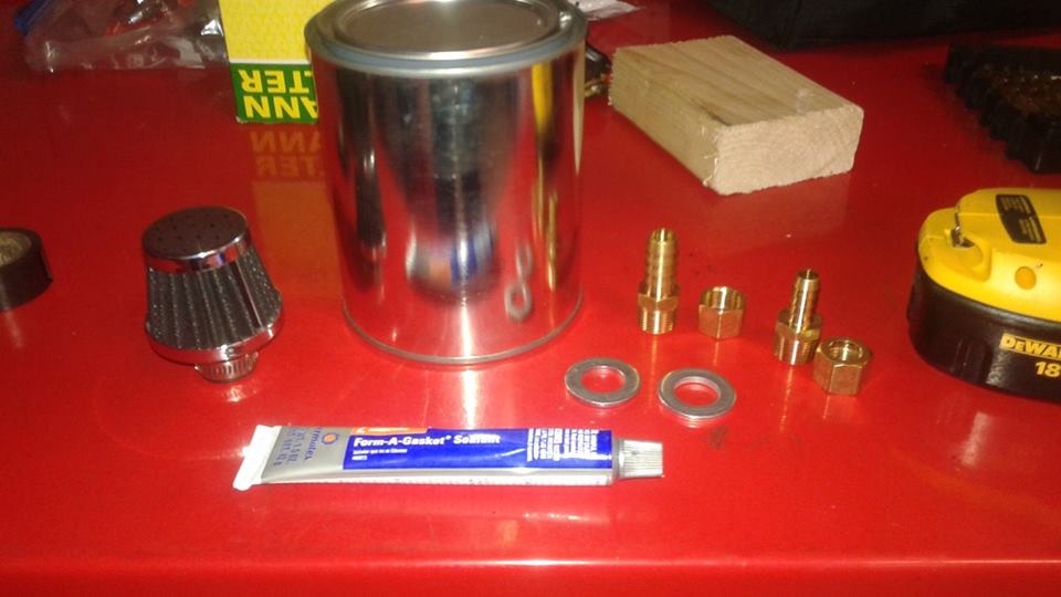

      while waiting for my exhaust to cool off before working on the car I grabbed some supplies at the hardware store and made a catch can. not the greatest but it'll do for now haha
      just a new empty small paint can, two hose barb fittings, two locking nuts with holes for oil to go through, some washers and gasket maker and a cheap breather filter from autozone.
      hammered the lid down and decided to wrap some wire around the top to keep it tight, i figure ill just untwist and empty as needed.
      total cost, around $15-$20 including breather filter, also better than the coca cola catch can I was using :P
