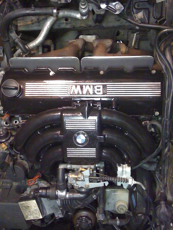

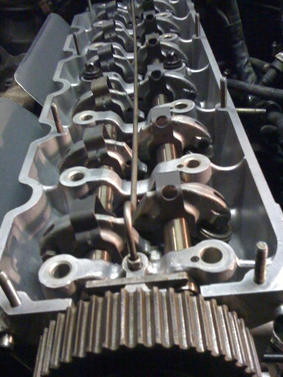

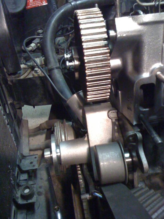

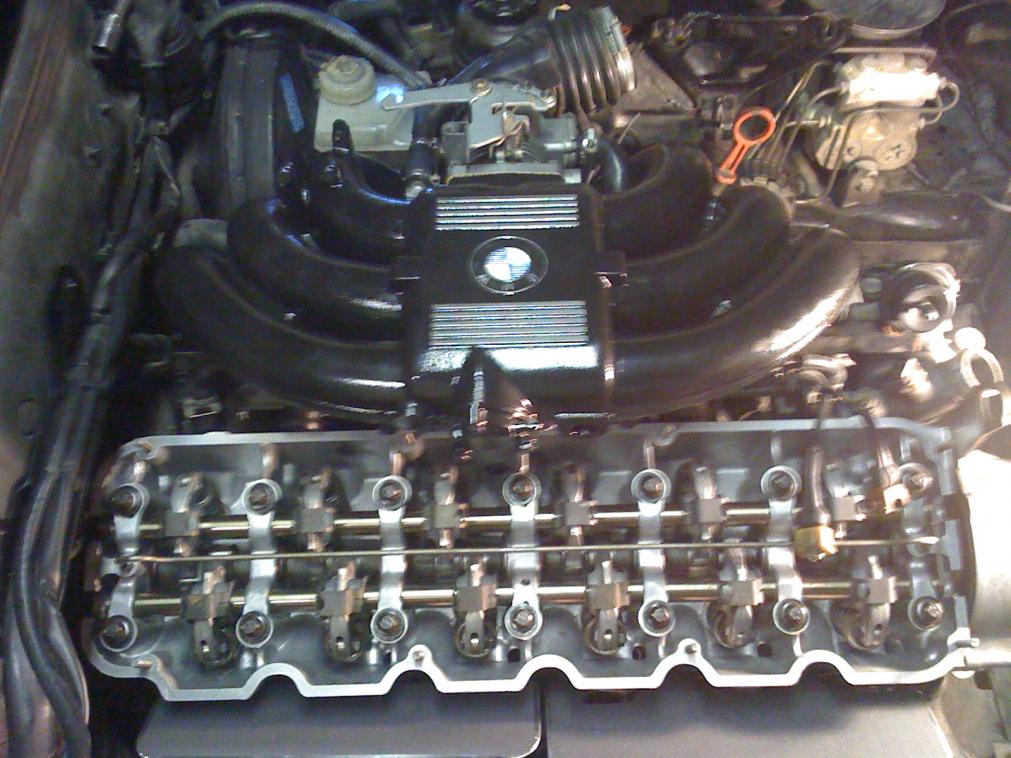

I pulled a head off a junkyard eta to replace the two bent exhaust valves i still had, only to find the timing belt was what failed and only one valve was salvagable. Had the machine shop order the remaining valve and should have the head back to put on wednesday... hope to be driving it wednesdy night! On the good side, this delay has given me lots of time to get the engine bay nice and clean.sigpicComment

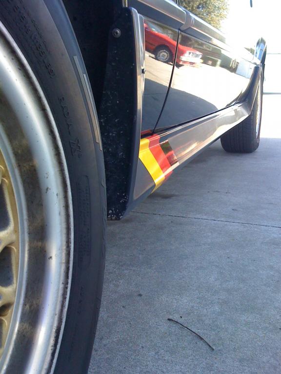

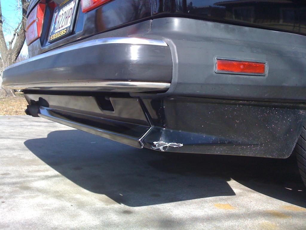

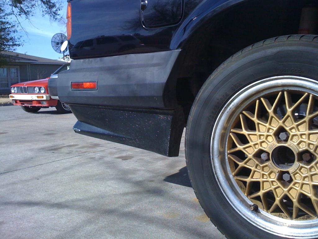

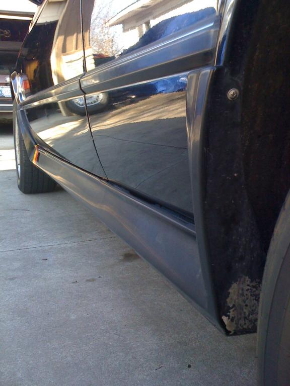

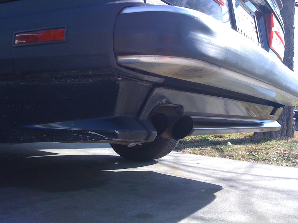

After further inspection, The side skirts are by Kamei, havent seen branding on the rear valance yet. Looks like they were factory ordered so I will probably keep it original.sigpicComment

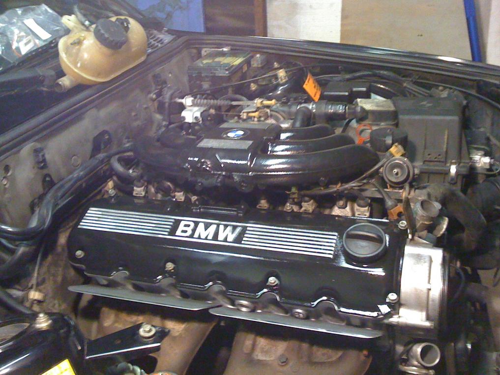

Started ideling rough last night, replacing antiquated breather tube tomorrow. Also had symptoms of fuel starvation under WOT so, I'm driving it gently and tracing down possible clogged fuel filter/dirty injectors...sigpicComment
Solved the rough idle issue I was having, and the fuel starvation issue at high rpm's as well! How did I (Swiss and I) do this? Replaced the pu$$yfied in tank fuel pump with a high flow one and deleted the secondary pump. This workrd like a charm and solved both my issues! I also have replaced the intake boot, and an O2 sensor so far... was thinking of replacing the TPS but it seems unnecessary at this point. Ordered center support bearing and guibo to get rid of drivetrain wiggle and should be installing that this weekend!sigpicComment
