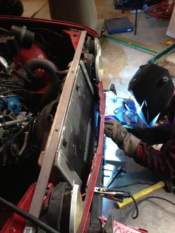

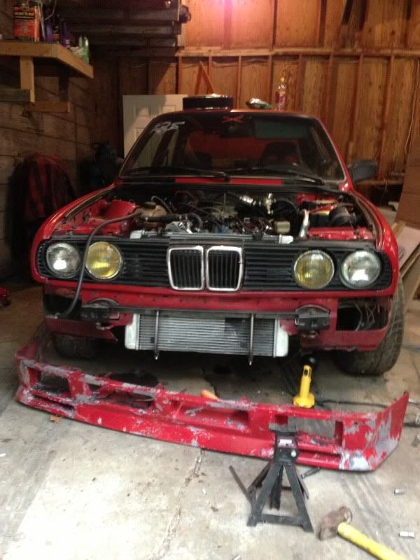

Aluminum rad and taurus fan. Had to cut everything out to make room. 3.8l Taurus fan moves 2500cfm on low and 4500 on high. Its a little thick compared to a slim line (about 3.5-4") but with a bit of ducting i should have zero issues with it running hot in any condition.
Lower mount is all done. Gonna start the top then move onto the rear subframe and racecar switch panel.Last edited by eurotrash; 04-28-2013, 08:40 AM.
It was all sheet metal for the lower support so it should be fine. Havent started up top. Gonna box in the remaining upper rad and weld a nut on the back and build a bolt on upper rad mount then brace that going back down to the frame. Also gonna run anouther bolt on brace back behind the whole rad assembly in front of the pully to keep the frame from movin around. I wanted to be able to basicly just yank the engine straight out. Plus the rad had to be tilted way forward for the taurus fan to fit.
