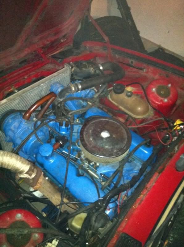

          pulled that god awful kit. threw the drift spares on and looks like im gonna need about an 8-10mm spacer to clear the strut.
          wasnt able to get pictures kitless due to the crappy lights in my garage but heres one of the lump that needs to come out. looks to be all e30v8.com stuff so its a realitively clean swap.

            I remember that car being posted on here some time back. So is anything done to the 302 thats going in it?
            cam'd up 1.7 full rollers highflow w/p arp studs and bolt kit bunch of milodon and edelbrock goodies. full balance and blue print. basicly a buddy of mine built it for a customer and they backed out so because he was moving his shop and didnt wanna move a bunch of extra stuff he took what he had laying around and threw it on. he said he estimates 320-330 crank.

                Sorry if I missed it but is that V8 attached to an auto, or manual?
                  and what is that on the drivers side? is the exhaust mani. upside down? where is the exhaust going to?
                    put the kit back on it, but paint t!
                    It is, on the 5.0 it has to go forward kinda around the engine. I always hated this about the 5.o.
                      right now both side just run under the frame rail and dump. you cant run them back do to the steering on the drivers side. This is also the reason its gots wrap around the front.
                      tranny is a t-5

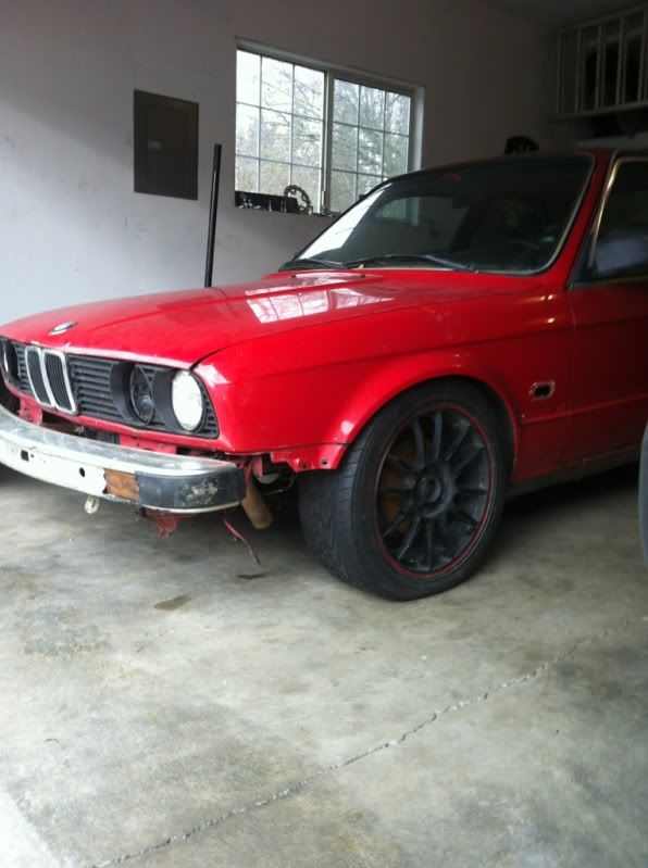

                                just a few pictures in the light - lack of bumper covers and valance leaves something to be desired. ultimately im thinking anouther 20mm all around and pulling the crap out of the fenders will make me considerably more happy.

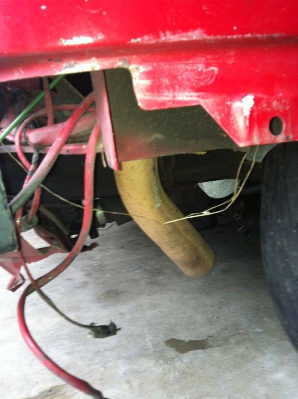

                                and the "exhaust"
                                buddy of mine mentioned runnng the exhaust out the high beam holes. rediculoius thought for a street car. the thought brings a smile to my face for a drift car tho :twisted:
