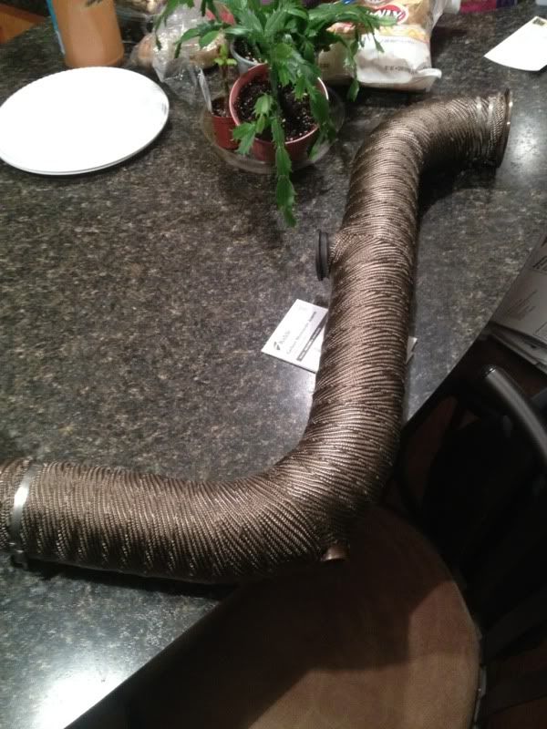

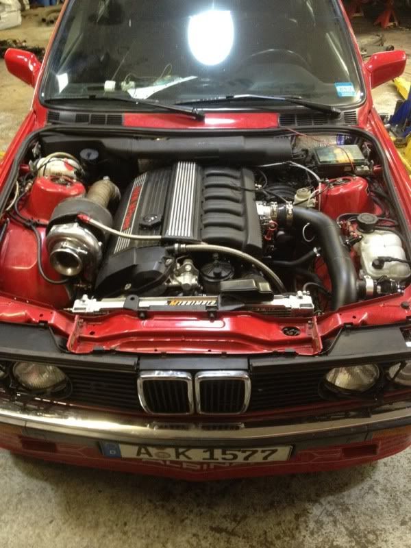

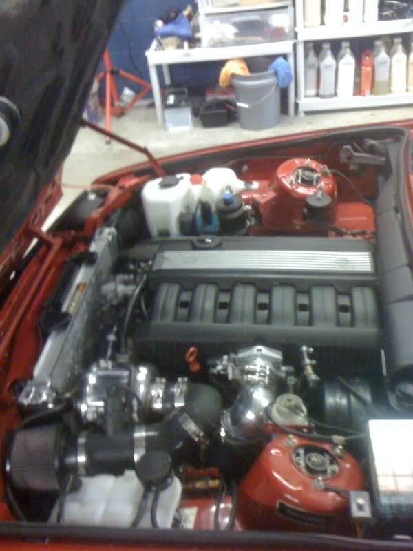

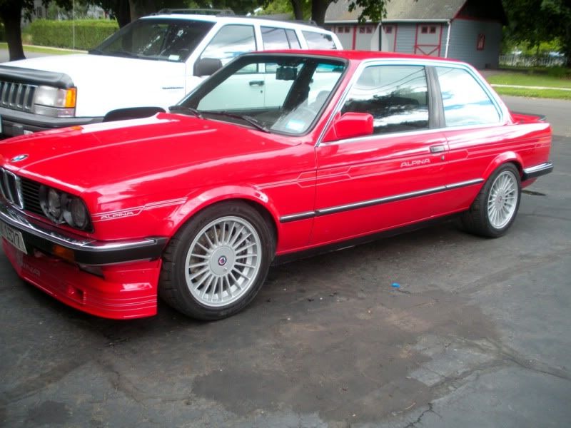

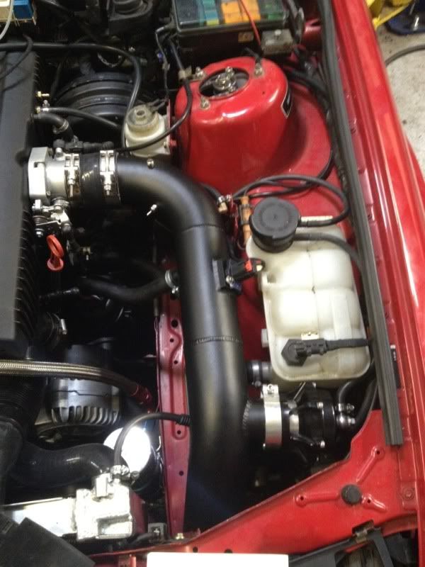

    OK gents, well I have been busy this winter going over the E30 and ditching the AA stg 1 SC for turbo, the SC was fun @ about 320 whp but I wanted more so I went down the deep hole of boost and emerged on the other side complete with what I think is a pretty damn solid build. I don’t post too much about my car because I am pretty humble about it so here is a rundown of what shes got. All work was done by myself and my shop partner @ JG Technik in CT.
    BTW look for the car is a month or 2 in Bimmer Magazine!!
    Car is nearly completed and just waiting on gauges and a few bits to tidy it up, a couple more weeks and then she shall be complete… for now…
    1987 325is
    Driveline:

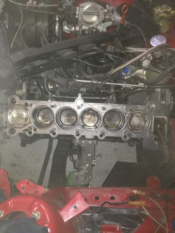

    OBD1 S52 w/ .140 MLS and ARP 2000’s
    Precision 6262 BB .70 cold .82 hot
    Otisfold ceramic coated
    Tial 50mm bov
    Tial 44mm wastegate
    AMS-500 EBC
    Aquamist HFS3 methanol injection
    PTP turbo blanket
    TRM tuning blow through w/ 60 lb
    Walbro 255

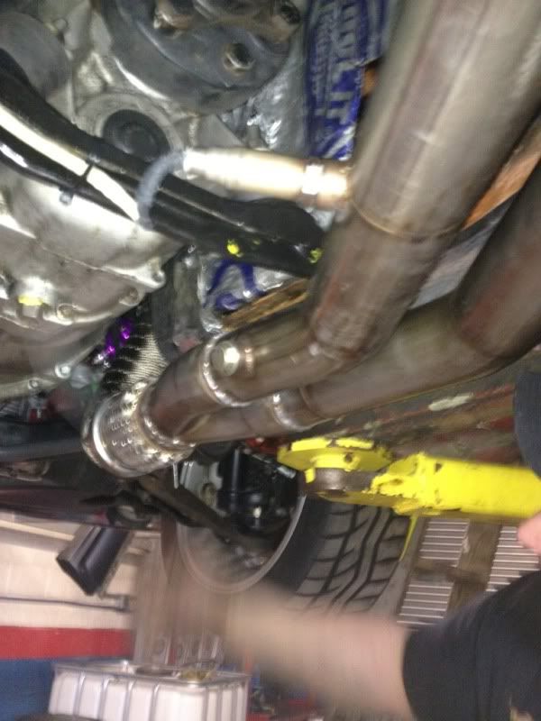

    Custom down pipe w/ heatwrap
    666 Fabrication custom made midpipe

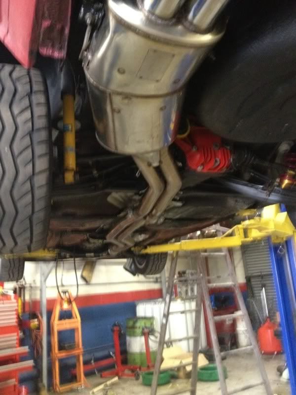

    Suspersprint Stainless exhaust
    ZF E36 M3 transmission
    2:93 LSD differential
    UUC Evo 3 SSK
    Southbend stg 5 w/ drag disc
    F1 flywheel
    Alpina oil filter cap
    Racelogic TC (on order)
    Suspension/Brakes/wheels
    Ground Control coilover suspension with camber plates
    Suspension Techniques sway bars with Ireland engineering mounts
    VAC rear camber/toe kit.
    Powerflex polyurethane bushings (sub frame, TA, diff)
    Willwood Dynapro calipers with Massive custom brakets and stainless lines
    16x7 Alpina Softlines with Falken Azenis 215/45/16
    Interior:
    Full Houndstooth interior w/ E28 euro recaro seats on custom brakets
    Alpina steering wheel
    Alpina dash plaque
    Alpina footrest
    Alpina gauge cluster
    Alpina center vent gauge (custom modified for AFR, Boost, IAT, Oil Pres)
    Alpina wood shift knob
    Euro clock
    Euro check panel
    Custom VDO gauges
    Leather Alpina stich shift boot,ebrake and armrest
    Husco armrest
    Nakamichi CD-400
    Trunk: BMW first aid pillow, BMW warning triangle, full E28 toolkit right down to the blue cloth, E30 trunk lid liner, Alpina tire pressure sticker
    Exterior:

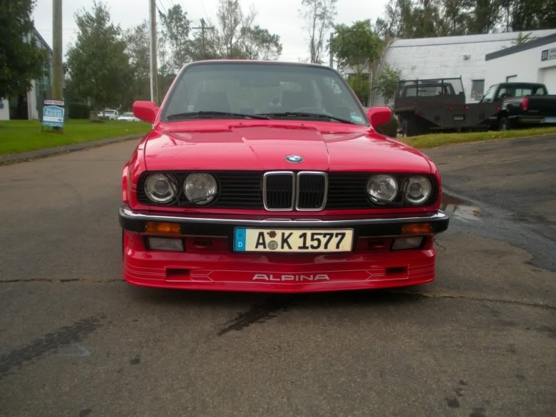

    Original Zinnoberrot paint (car has 273K)
    Alpina Deko stripe kit
    Alpina Decklid badge
    Alpina Front airdam
    Mtechnic 1 rear spoiler (Alpina rear spoiler in the mail)
    Euro bumper conversion
    Euro plate filler
    Euro smiley elipsoid light
    Euro grills
    Fully intergrated wash/wipe headlight cleaning system
    I will update this thread when car is complete and after dyno sesions etc.
