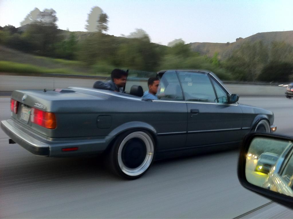

    Been working on this "beast" for a few years now. As my daily, I've had other projects to keep me occupied so its been slow, but this is definitely as close to done this car is going to be for a while. I dont have a lot of pictures of the builds but it basically started last bimmerfest with...
    This:
    Soon after that came H&R sports and eibach rears to give it a nice casual sporty look and poop ride quality:
    After running out of other things to throw money into, I started getting serious in the "stance" theme. So i went out and get some coils from a local vendor to try and get the height i really wanted and got this:
    Wasnt enough... so i went out and got the front housings cut 2 inches, stuck a 4" spring in, took the adjusters out the rear and ran the 4.5" spring, some new wheels that i spent 3 weeks refinishing, and ended up with this:
    Running 17x8 front, 17x9 rears on 195/40 f, 205/40 r. The fenders are very temporary as the car was undriveable at the height it was with non-rolled fronts, plan is to cut the excess off and heat it up and roll it, see what happens. if it doesn't do what I like, it needs to be repaired regardless, so i'll just snag new ones from the yard. As for the rears, they were rolled, but not enough. those will be pulled and the back will be dumped out pretty soon here.
    As for Engine mod's, its pretty much all factory. the engine is the factory m20b25 with a full header back exhaust. Cone filter intake. 5-speed swap..
    Final build plans consist of new paint, vinyl wrapped hood, and probably new interior. Tarbo is looking very likely, but will keep you posted...

    Is that thing on air?
    Whoever took that last pic really needs to be discovered. Looks legit.

              perfect stance. overall nice e30 bro =)
                Needs less Volvo lip.
                Moar rear apron!
                haha. you mad bro? volvo lip stays, makes it look lower and i dont care how many times a day i fold it under the valance. rear apron will NEVER exist, i love that you can see under her skirt. and that last pic was Pro As F*ck.. we need to go on another shoot soon, when i pull my rears and dump her on her nuts maybe..

                          wow, what were you thinking with those fenders? 205s on 9"wheels.
                          I actually liked the car the best in the 6th picture.
                            haha. i was thinking 'CLEARANCE'.. i literally couldnt move the car forward without rubbing the way they were. had to do something quick. and the fenders are poop anyways, salvageable, but really bent up. so i considered them my get out of jail free card..
