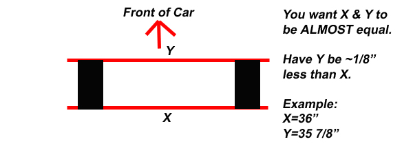

                      #55
                      Originally posted by A_325i
                      i will try to get it there on sunday but no promises i still need an alignment once i get the new tierod on and im not sure if ill be able to afford that in time
                      Jeremy,
                      here is a helpful tip...
                      After you swap the tie rod(s), try to line the wheels up by eyeballing it with it in the air. (Lock the steering wheel straight).
                      Now, lower the car onto a flat level pavement area, and roll it backwards, then forwards again to settle the suspension.
                      Get 2 boards/cookie sheets (they make "toe/camber plates... but for your use we can make do.) Now use 2 tape measures, and run one from the outside of the 2 plates infront of the wheel, and the other from the outside of the plates behind the wheel.
                      Look at the measurement on the tape infront of the wheel, and compare it to the one behind the wheel.
                      You want them to be almost identical if not a *tiny* amount shorter in the front. (this will give you some toe in, better for daily driving stability)
                      When I say *TINY* I mean, less than 1/8"
                      This is a quick and easy way to make it driveable for the time being, until you can get it to an alignment shop and have them put it on the rack. I wouldnt advise driving to FL this way, but I would say it would be OK to get around here until you leave.
                      Also, swap one of the straight rear wheels onto the front, inplace of the damaged wheel!!! You dont want a bent wheel messing up the measurements.
                      I assume you know how to adjust the tie rods? Very small incremental adjustments... ! Just ask if you dont... happy to explain that too.
                      HTH,
                      Chris

                        #56
                        Here is a quick diagram to help explain what I meant...
                        HTH,
                        Below the radar...

                          #57
                          ahhh yes i see..what if i just mark and count the threads on the old tierods and set the new tierods to the exact threads? it should come out fairly even right?
                          • UNHCLL
                            • 8790
                            #58
                            Maybe on the side thats not bent, but you cant rely on that method for the damaged side.
                            You can aproximate them that way when you first install them, then use the method I outlined above. For now, make sure the steering rack is straight and get the wheels straight.
                            You're steering wheel may be a bit off, but that is easily corrected once the car goes in for an alignment.
                            Get your mom's boyfriend to help you?? 2 sets of hands when doing the measuring makes it much easier.
                            HTH,
                            Chris
