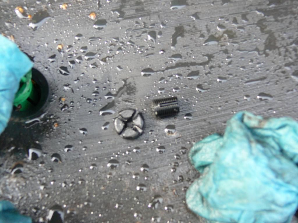

                Everything (do NOT use normal size vice grips if you do this, even with lots of padding they marred up the surface of the piston and I had to shave it down with a dremel. If I did it right the seal should not be compromised but if I missed a spot it will score the bore of the vanos and I'll basically need a new unit after awhile. Use a vice or possibly larger vice grips, the "medium sized" grips are too small to grip the piston properly)

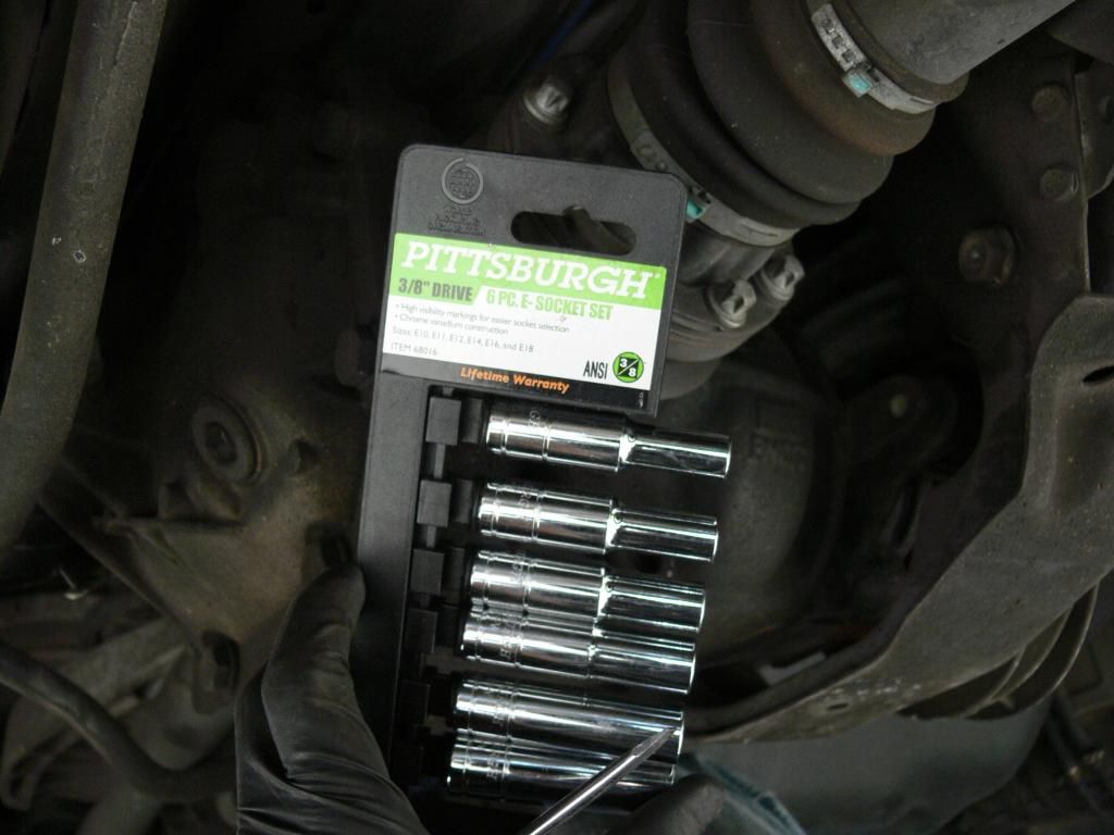

                                E sockets for the input and output shaft bolts
