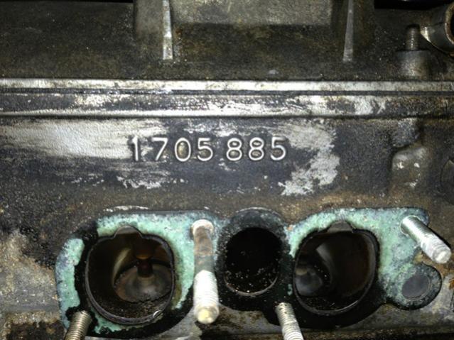

Yep, that's an 885 head. Definitely a SETA. Great find!Originally posted by csmitty View Post[ATTACH]68616[/ATTACH]

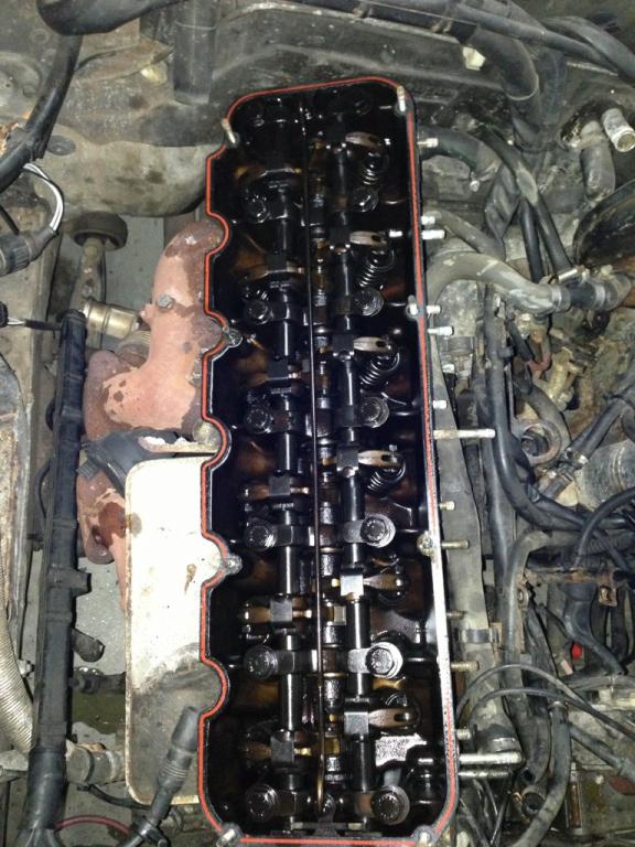

So bit of on update. I'm researching on the parts to convert over from the i cars. Most i've read is that on the seta the head needs to have extra oil passages drilled for an i cam or aftermarket. The 885 has the 7 journal passages obviously but it seems that the eta cam typically only had 4 bearing journals? So would there just be an open space if the eta cam was in the i head typically? I only ask as I was going to take my head to get drilled. However the cam in my head as seen above has all the journals used. So I would assume that they have the oil passages. Would that be a good assumption? Basically only needing to swap the cam and valve springs.
I was browsing the local pull a part as they got in a new E30 and it was a 325i date 3/87. Had the head and its just easier to get the whole head than pull the cam shaft. Plus its only $66. And I figured it'd have all the oil passages. Anyways the inside of this thing was clean, as in no oil or varnish, timing belt was still intact and nothing visable broken so pulled it and brought it home.
Also the intake valves were clean and maybe new guides? However the CC side shows some deposits. So maybe it got carbon'd clean? The exhaust side looked like normal use. Anyone have any theory's? I'm tempted to run this head as it is. Just change out the camshaft seals. It has some surface rust on the lobes but doesn't seem bad.
