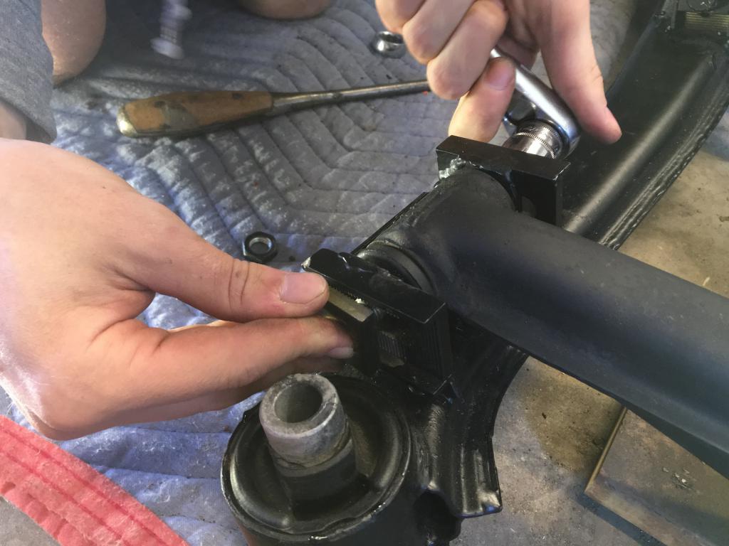

    We got the Ireland Engineering trailing arms back together and aligned. Drives nice and straight, no hands straight down the road. One little clunk at the RR, but that may be the battery not locked down correctly. New tires in the back.
    Need to add the upper shock reinforcement plates.
