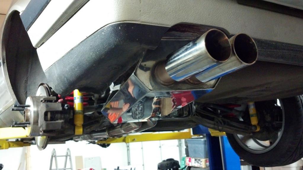

    Robert and his brother turn some quick wrenches. Looks great! only thing is the muffler looks like it hangs low.
    Thanks! The E36 AA muffler is taller than it is wide, unlike most of the E30 cat back setups I've seen. If I had gone with a different rear section it would probably tuck a few mm higher, though BJ did a phenomenal job custom fabbing what he had to work with. The sound it produces at WOT more than makes up for any fitment imperfections.

      Ahhhh it is for an e36. Yeah they have more room to tuck it up. Is there room to cut the rear metal apron to push it up more? I did that to both mine and my brother's e30 to gain ground clearance from the subframe.
            Quite possibly, though the wide and angular shape of the lower part muffler itself makes more upward fitment a little more challenging. It looks like if I want the nice pretty tips to extend far enough out to show them off it may require re-shaping more than just the apron above the muffler.

                No problem man, but this is what I was talking about and I can see what you were talking about. The shape does not allow it to fit in the allowed space well.
                I am sure it sounds amazing, but did you give it some thought on the finished fitment? I just think a different muffler that closes the gap and sits flush in the opening would really finish off it well. IMO the tip fitment is what matters for everyone to see.
                What is everyone going to think when you give them your rear end after a head scratching pass? ;)
                Not bashing at all, the work is well done and proof is the picture of it sitting together in the pictures above. I just think it does not do any justice to the work involved with the car and the end result of the fit and finish of all the little things.

                    ...this is what I was talking about and I can see what you were talking about. The shape does not allow it to fit in the allowed space well.
                    Honestly, I didn't. I wanted to try something I hadn't seen anyone else do yet, and this lightly used AA was offered at what I was looking to spend. The research I'd done suggested that an E36 cat back could be used in an E30 but that was really all I had to go on.

                    I definitely appreciate the comments as well as the constructive criticism. If we'd had another day or three to fine-tune we might have been able to squeeze it upward and inward a few more mm. The issue was that the way the pipes are bent on the cat back (for E36 fitment), it would have meant cutting a lot more off than just the flanges and fabbing up several more bends to clear the subframe and the half shafts. That was a luxury we didn't have since all the piping I brought was pre-bent, and had been purchased based on a mock-up RobertK did on one of his cars. The nice thing is that it's connected with V bands, so if/when I decide to make a change I can do so relatively easily.
                    I think this picture is more flattering of the fitment:
                    This one shows how it looks at ground level - and very few people will actually be seeing it live from that angle:
                    And here's one I just went outside and took:

                        I noticed the straight shot under the subframe, I am not trying to rip on any of the work done. You had a time frame to upkeep as well, no? Will not bring it up anymore as I do not want to upset your enjoyment. You're happy and that is all that matters.

                          Dislike the look of that exhaust but I like the sound it makes, and besides sitting in the drivers seat you can't see it so it really doesn't matter.
                            Yep, three days that turned into six. I left for Ohio about 8 hours after I pulled her in the driveway, so that's literally ALL the time we had.
