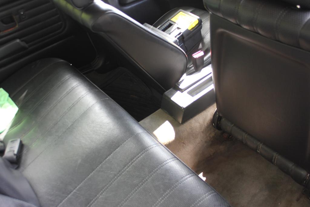

      There is/was a slight leak coming some where. I lifted the carpet behind the front passenger seat and the cushioning was a little damp. I lifted that up and seen that the floor board was not flat. I had posted a thread about this before I think I called it "Hump on the floor" (lol, didn't think about how it sounded at first.) I think perhaps something was hit/ran over that caused the floor board to rise. As far as the leak idk
      [ATTACH]73790[/ATTACH]
      Anything I can do about the little rust on the floor board? don't want it to get worst.

      • nomansland92
        • 1657
        Sand it all down completely and make sure it's not a hole. If the steel is still good I would get por15 and paint it very good on both sides. Also those big plugs tend to leak and that causes the rust so make sure that plug is still good and sealed. I had to take all mine out and make steel patches.

          • anonymous alias
            • Jun 2013
            • 66
            Thanks. It doesn't look too bad but I cannot be too sure. I will definitely do that.

                  • GT BMW E30
                    • Nov 2008
                    • 2491
                    pull the carpet over the rear floor vents. turn the heat on for and it will dry fast. also remove front seats. pull up carpet on driver and passenger side. hopefully no major rust. if so sand down, treat and apply undercoat or protective rust coating.
                    • anonymous alias
                      • Jun 2013
                      • 66
                      I'm having difficulty removing the front seats bc the sliding mechanism under the seats are broken. I cannot get to the front bolts. I have removed the rear bolts.
