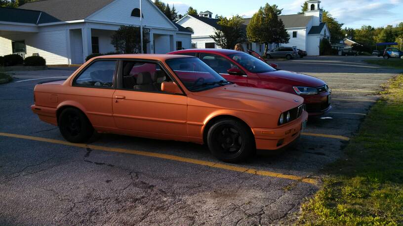

Picked up this 91 318is about 8 months ago. Car was in pretty decent shape. Not my first e30 (#5 I think), so I knew it wouldn't be long before changes were made.
Updates since ownership:
-All new bushings in rear including rear subframe, rtabs and diff mount
-New Billie sports and new mounts (front and rear) with H&R sport springs
-New front control arms, bushings and tie rods
-New Momo wheel and adapter
-Z3 shorty antenna mod
-15x7 DForces with 205-50 BFG Rivals
-Black suede, mtech stitching shift and ebrake boots made by Cletonius
-UUC big brake kit
-Turner Motorsport chip
-Supersprint cat back exhaust
-ZHP shift knob
-Rubber-wrap.com Lime Rock orange matte wrap :)
In the works.......
-M42 stroker with 279/274 cat cams, Supertech valve springs, VW lightweight lifters, port/polish head and Dbilas ITB's
-M20 "lightweight flywheel" mod (13lbs lightened, resurfaced and balanced)
-Recaro Speed seats with reupholstered rear seat and door panels
-Better 16x8 wheels wrapped in 225's :)......because racecar
