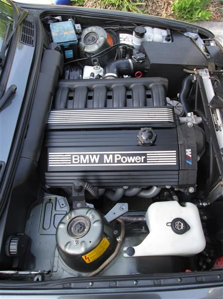

      Have you had any issues with the water pump contacting the back of the electric fan motor under hard braking? How much clearance do you have between them?

        No issues with the wp contacting the fan and I do have big brakes. The AC crank pulley is actually closer than the wp. But I haven't done any real hard driving either. I'll be hitting the mountains this weekend though and will report back if there are any issues. Also, I've now mounted an ac compressor and it clears.

            Just to follow up. Zero contact issues with the fan setup and I definitely stood on the brakes a couple times from a high rate of speed.

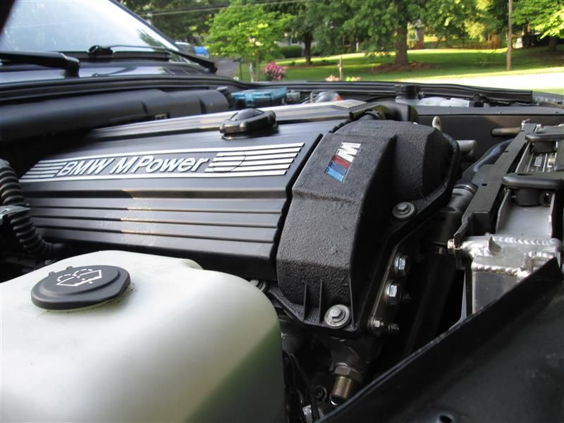

                Why does your valve cover look just like mine? I was told it was supposed to be unique!
                    Sent from my SAMSUNG-SGH-I537 using Tapatalk
                    You have an obd1 cover. RobertK sells them CNC engraved and powder coated.

                    Mine is obd2, which you likely won't see another quite like it.

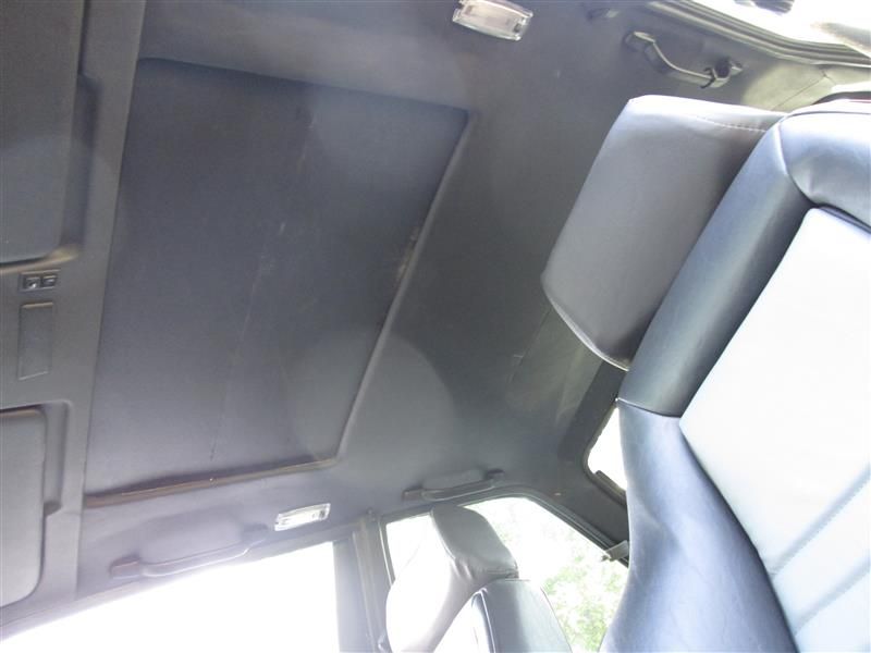

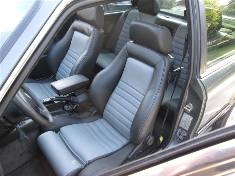

                            Thanks for the compliments! Sure is a lot of fun. Some updated pictures (including newly redone seats and vinyl headliner) below.
