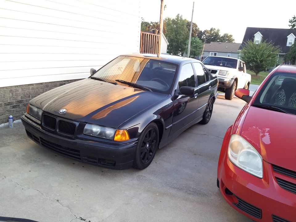

    Hey yall,
    Thought I'd toss this up here since I know virtually nothing about E36s and even less about M42s and I'm looking for some recommendations.
    A friend of mine bought this for a daily and has recently lost interest in it. He drove it for over a year and the head gasket started to give, he pulled the head off, had it re-finished and just sort of stopped caring about the car. It's sat for about 2 weeks before he came to me and asked if I wanted it. $800 later, it's mine. It's an automatic, unfortunately, but it's a 4-door which is what I wanted. Also it's only got 150k on it. He took the liberty of having the head re-finished and all I have to do is put it back together. Like I said, I don't know anything about M42s so I'm looking for some recommendations on what all I should do while I'm putting it back together. So far on my list:
    -Head Gasket set
    -Head bolts
    -Thermostat
    -Thermostat housing/gasket
    -Water pump/gasket
    Otherwise, the car is straight. Needs a little cleaning, but everything is in-tact and functional. Even A/C!
    The wood trim has to go and the glove box cover needs to be re-glued, but I think it's a pretty solid deal all the way around. Oh, the front tires are new as well. Rears could use new ones soon, though.

      wtf is the deal with the wood?
        Yeah, I have no idea. That will get painted or something... but I hate everything about it. WhatinthefuckBMW

                That wood is definitely not OEM. Looks like some aftermarket stick-on garbage.

                      Haven't even been able to drive it yet and I already love it. Ordered a bunch of parts to do the HG job and this weekend I will order tires as well.
                      Most of the wood trim has been stripped off and the carpets have been cleaned. Woot.
