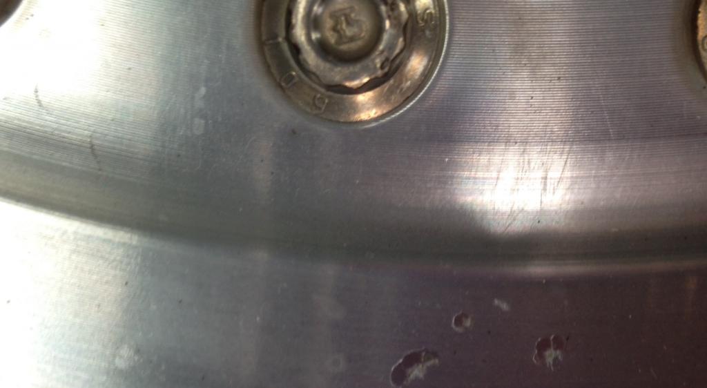

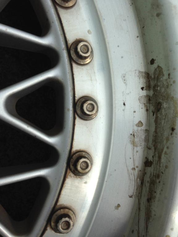

    Originally posted by selespeed
    thanks for your answer.
    i had thought you refurbished your rims. but now you said they are brand NEW lips. are new lips still available? in other words, they are then assembled.
    i have decided to remove the clear coat. any idea what to get from supermarket to do this job? i am also debating whether to have the lips removed in order to spray paint the spoke
    thanks again
    PM me

    Originally posted by f50nut
    Feel free to PM me about this.
    That is not the case with mine since they are brand new lips. You don't want to spray clear over a polished surface - it will be prone to peeling and will dull the finish. The clear coat (paint or powder) really needs a rough surface to adhere to, hence the machined finish on factory RS lips. You can do it, but it's not a permanent solution in my opinion.
    thanks again
    i just had the specialist look at my wheels. the lips are coated with a layer of clear coat. and the aluminium is finished with fine lines. if clear coat is removed and you polish the aluminium, the fine machined lines are gone! is this the case with your wheels that are polished. and why would you not spray clear coat to protect the polished aluminium?
    in my case i have some oxidation and chip marks. so the coating is broken exposing aluminium.
    There's no coating. They're just raw, polished aluminum. These lips come polished so I'm not sure how much the polishing should cost on its own.
    Caps are brand new, they were around $30 each IIRC.
